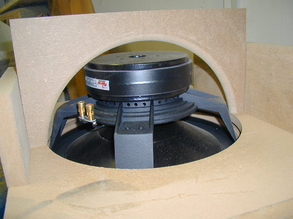

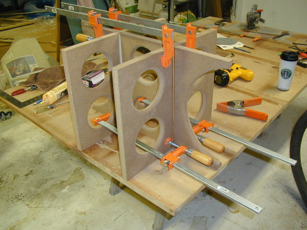

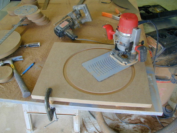

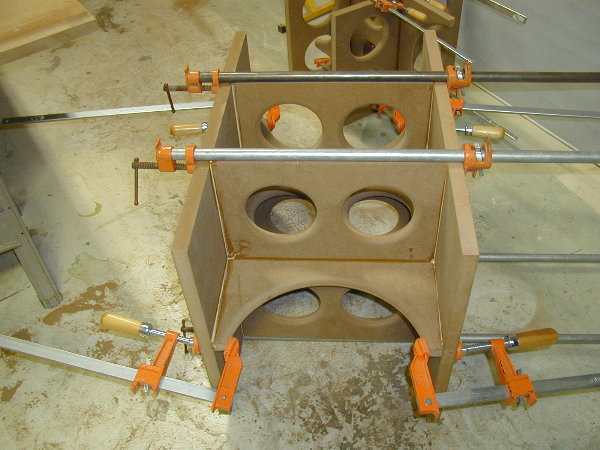

    When I built our theater a few years ago, I found out the hard way that there is a LOT of low frequency information in the front channels (not on the LFE track). I could have routed this to the LFE sub (which is built into the rear seating platform) but I wanted to keep a high-quality sub up front for critical music listening. My "B380 clone" JBL 15" was good in the SQ department, but with only 7mm of xmax, it was farily quick to reach its limits.
    Having no practical option for an IB , and no place to put huge boxes, I started down the path of the usual sealed RL-p15 or TC2000. But Mark Seaton and Brian Bunge convinced me to look at the Dayton Reference RSS390 HO. These drivers don't have the Vd of the others mentioned, so it takes more of them. Following the immortal words, "build the biggest box you can live with, and EQ it flat" I settled on four drivers in two 120L boxes - with the drivers mounted on opposing faces. My Lexicon MC-12 prepro handles crossover duty, EQ is a DEQ2496, and power is from a Crown K2.
    In one long day on Friday, I sawed up 2-1/2 sheets of 1" MDF, cut a bunch of holes and driver recesses with my Jasper jig, and started assembly. Yesterday, I didn't get much done as I was out on a long training ride for an upcoming 24-hr mountain bike race. Hopefully today I'll complete the assembly and start the finishing process. I had planned on piano black - I have equipment and experience with this - but it is time-consuming... so I may go conventional veneer.
    Comments, suggestions?

    First question for the experts here...
    I'm about to attach the baffles (double-layer 1" MDF with 3/8" driver recess). Should I chamfer the back of the driver holes to help the driver "breathe"?
    It didn't look overly restricted when I mocked it up with driver... but I hate to skimp at this point. I don't think I have a large chamfer bit - could I just do a 1/2" roundover?
      Hey! Those look like they're going to be nice and heavy.... :B
      The RSS390HO certain are good drivers, as you've learned the "price" for using them is buying multiples. But using them that way is going to keep the distortion nice and low... :T
      Good luck in the race....
        Only needed if the wood is blocking the cone.
          If that second pic is an example of your clearance/masking with the Dayton Drivers, you've got nothing to worry about- we normally are concerned abou rear masking with 7" midwoofers, for example, when there really is an issue if one uses a thick front panel.
          Looks like you're going to have some nice heavy stiff enclosures! The Daytons are nice sub drivers, with their lower inductance easier to integrate with the rest of the system, and with lower upper bass distortion.

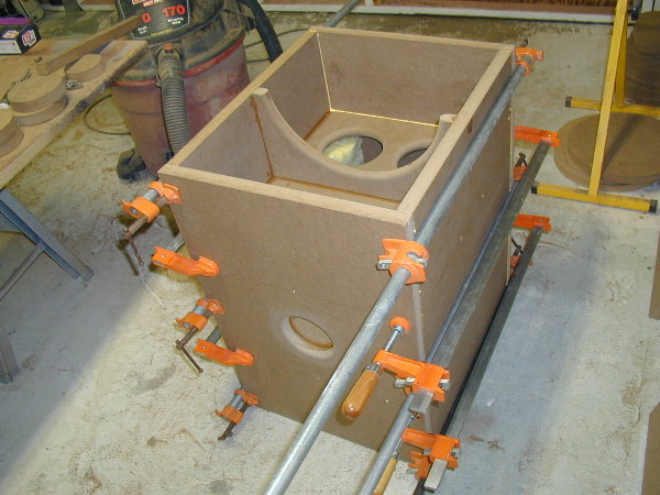

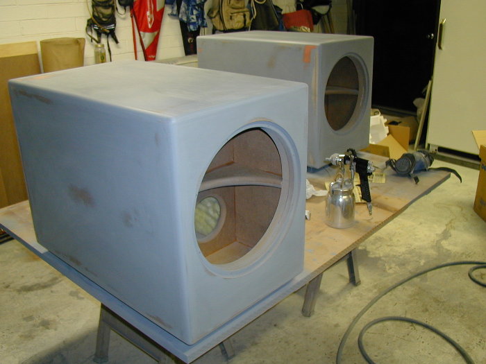

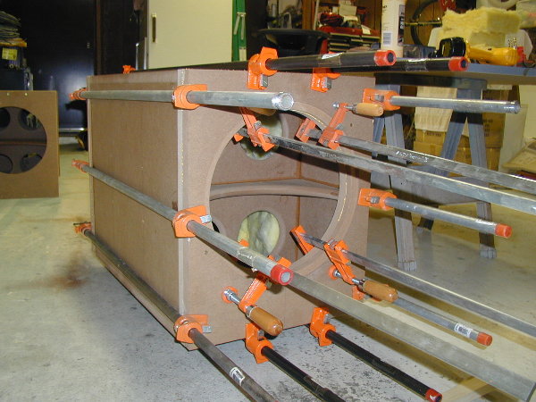

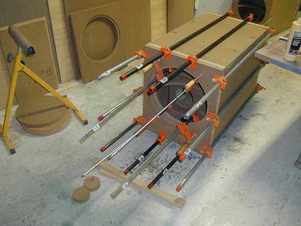

            Project was slowed somewhat by that little thing called Christmas. Over the last few days, I finished the glue-up and some details like mounting holes for drivers and feet (PE black chrome spikes).
            Uh... well, yes. 109lb each bare. 8O Their size and weight were somewhat difficult to handle by myself. Finished speakers, which will likely weigh more than I do (160 lb), will definitely require a two-person lift. 'Not quite up to Thomas' 200lb benchmark for "real" speakers, but formidable nontheless. :T

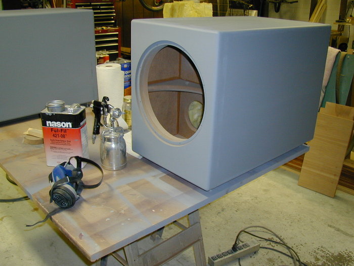

            I decided to proceed ahead and prep for piano black finish. First step was to shoot three coats of high-solids primer-surfacer, waiting about an hour between coats. The "fuzz" on MDF end grain still shows through in spots, but will quickly disappear on first sanding. Next step (hopefully today) will be to sand with 220 "no-load" dry paper. The idea here is to get the surfaces perfectly smooth, but not to cut into bare wood. Typically after this step, the surface is lightly blotchy - with areas of primer sanded so thin that you can faintly see the substrate underneath. Then I'll shoot two more coats of primer, wait a day or two, and sand glass smooth with 320-400.
            Next installment: final finish.

              Ok, Ok, first you need to start over, because that's no where near the amount of clamps needed to do the job right.... :B
              Actually these look like a pair of really well designed and build boxes. They should sound great, even if they are slightly underweight.... :T

                You can never have too many clamps!
                What's a good gasket material for the drivers? In the past, I have used rope caulk or silicone with a mold release agent on the driver rim. There must be an easier way.
                Finish is looking good, but I may wait another day to sand. It's been one of those rare cold and wet days here in the desert. I might have to wear a jacket today on a bike ride. (I had to rub it in, Thomas...)

                  Yep we only got 12" of snow last noc and another 12"+ is anticipated......At this point we're primed to break a record for the most snow, and that occurred in 1913.... 8O
                  I buy neoprene foam weather stripping tape. Here the local Ace Hardware stores carry it.

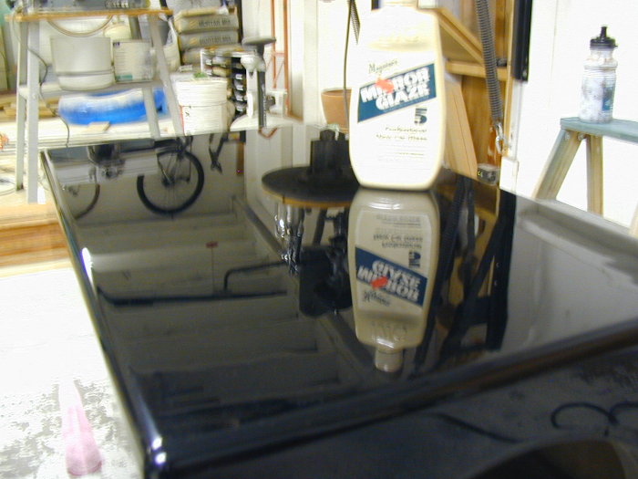

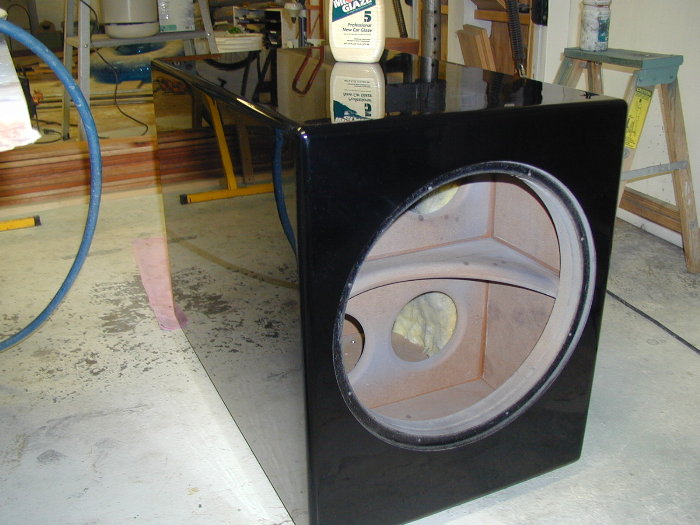

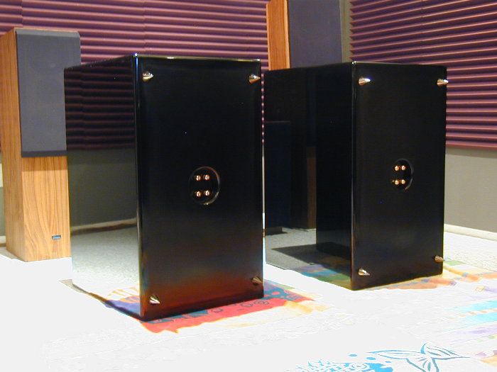

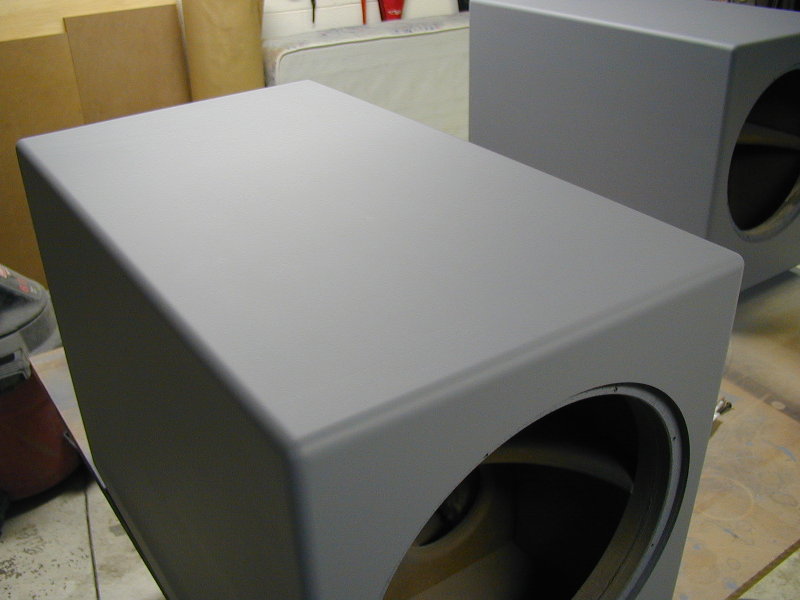

                          I see that InPhase is getting ahead of me, so I'd better post some progress! :B
                          I sanded the primer with 220 and had to apply automotive spot putty in a few areas. Then another round of primer and final sand with 320. Finish was DuPont Lucite "Diamond Black" automotive acrylic lacquer. I shot three medium-wet coats which pretty much emptied the quart that I bought (thinned about 100% to 17sec viscosity). I gave it a week to dry and shrink, then color sanded with 600, then 1200. I used paint thinner as a lubricant because I'm paranoid about getting water around MDF. DuPont 606S white polishing compound gave it a final finish, although probably any decent rubbing/polishing compound would work. Be careful not to rub through the finish on the corners, although the 1/2" roundover really helps minimize that danger.
                          The last photo shows PE spikes and terminals installed on the bottom.
                          Next steps - wiring, insulation, and driver install. :T

                            Looking REALLY nice there Dave..... :E :T :B
                              Wow, impressive. Good work. Now hook those bad boys up and lets hear some listening impressions.
                              Also, your's and Inphase's would make great additions to the DIY Subwoofer Showcase thread in Mission Accomplished, so don't forget to write up a quick summary and post it there. I'm sure you will inspire a few people..
                              • WillyD
                                • 675
                                Holy impressive finish Batman!
                                Niiiiiice work dude.

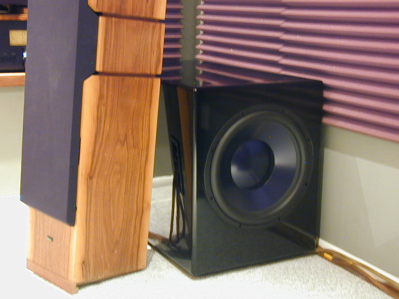

                                  I had just enough time yesterday to fire them up briefly. I placed them on either side of the center channel along the front wall - a setup that looks good but may not be sonically optimum. The buggers are really hard to move. I thought I could "walk" them around by myself, but the spikes dig into the carpet. They must be lifted fully clear before attempting to shift - a two-person job for sure.
                                  First impression on music (no EQ and with level set by ear) is that they were a little boomy and seemed to have a hole in the 30 Hz range - more than I would have expected from the FR simulations. This could easily be aggravated by room modes. I'll set up REQW next week to sort it out.
                                  Then I put on some movies. All I can say is... Oh. My. God. 8O
                                  A visceral experience like no other. The pod race scene took on a whole new level of impact. Even without EQ, these things go DEEP. Some scenes from Atlantis that I was previously limited to -9dB with the old sub sounded great at -6... then -3. The entire room shook. Some of the popcorn stuff started falling off of the ceiling. I started to see clip lights on the Bryston 4BST driving my mains and backed off. No sign of strain from the subs. Perfect. :B
                                  I can't wait to start making some measurements and dialing in the EQ.

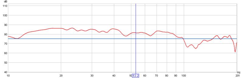

                                        The DEQ2496 and measurement gear took some effort to set up and calibrate, but I finally got it! :T
                                        With the subs in the original location, I had a few nasty peaks and a huge trough at 32-38 Hz. I moved the subs along the front wall closer to the room corners at slightly asymmetric distances and it helped some. I was able to tweak it mostly flat with seven filters out of ten (using "stereo link" mode for stereo subs).
                                        The bad news is: I had to use 12 dB of boost at 35 Hz 8O - which I understand is a no-no. But I've played all sorts of music and movies and it sounds good, really good! And it still seems to have headroom. I played "Vogue" from the Dick Tracy soundtrack (which has lots of 30-45 Hz information) at utterly stupid levels (my clothes were vibrating) and had no problems. Last night I watched Pearl Harbor at full reference level. The battle scenes were so loud and so thunderous I expected to see clip lights on the K2... but instead the 400wpc amp on my mains ran out of gas first! (time to upgrade to the 7BSST monoblocks).
                                        At this point, I could try more radical placement options to hopefully avoid having to use so much boost, but I'm happy with the results. Thoughts?
                                        Also, there seems to be some debate about "house curve". As you can see from the REQ plot, I have 5-6 dB of lift at the bottom end. I tried it flatter and thought it sounded thin.
                                        Finally, there's that hole at 110-120 Hz that I'm not sure what to do about. Could this be floor bounce from mic placement? I don't have any practical way to EQ this (the DEQ is on the subs only) so I may just live with it.
                                        Overall I'm a happy camper. These things put out an astonishing amount of clean, tight bass - especially for "little" 110L boxes! I'll post some pictures of them "in situ".

                                        • warnerwh
                                          • 261
                                          Your room curve looks pretty good. You do have a dip in a very important area above 100hz but it sounds like you are happy with the sound. You may want to try giving a boost to that region and see what it sounds like. If your speakers can handle it a 2db boost can help alot and I personally have no problem with a boost that small.
                                          Your room curve is what sounds best to you. That's all that matters. I can't stand a perfectly flat response. I, like you, like a significant amount of bass. Mine is 3-4 db up sloping downward slightly to 120hz with a slow taper but more rapid taper to 500hz. Then my curve is pretty flat to 2khz where it starts a downward taper, being down 4-5 db at 20khz.
                                          Here and there I will make small adjustments of .5 to 1db tweaking to the best average sound. This is because of the wide variety of recording quality. Being somewhat of a perfectionist and having a toy like the DEQ 2496 I can't help myself. :W
                                          My point is that you should be happy you have a sound you like. I use two sealed subs using the Dayton 15" RS HiFi series and am more than pleased with the quality of my low bass. It's excellent. What really got me though had been the price of the drivers.
                                          I know very little about diy and had been told to use them if you want very high quality bass. To be honest I had been a bit apprehensive due to the low cost of the drivers but know enough to listen to others that know more than myself. I'm sure your subs sound excellent also so enjoy your excellent yet inexpensive bass. :T
                                          • oxcartdriver
                                            • 110
                                            Are you locked with the present position? My initial position required a boost about 25hz and a huge attenuation at 50-65hz. I used a velodyne SMS-1 to EQ. Problem was that in other locations around the room the bass would be boomy. I've since tried a couple other positions. Very little EQ was actually required in my present position. Significantly better response as a function of room position.
                                            • warnerwh
                                              • 261
                                              Good points, even a couple of inches can make a significant difference. Something I need to do after I build a new enclosure for one of my subs.

                                                    • h-bar
                                                      • Nov 2006
                                                      • 17
                                                      ground plane measurement
                                                      engr_dave: "Finally, there's that hole at 110-120 Hz that I'm not sure what to do about. Could this be floor bounce from mic placement? "
                                                      You could try a ground plane measurement to find out. Just put the mic on the floor and make a measurement. If there's a carpet and you want to measure at high frequencies you might have to play games with putting down a sheet of mdf or plywood or something, but for ~100 Hz I would think you could just lay the mic down on the floor and measure away. D'Appolito's book on loudspeaker measurements has more detail if you're interested.

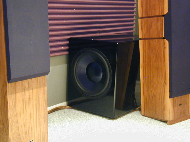

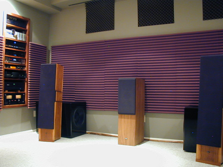

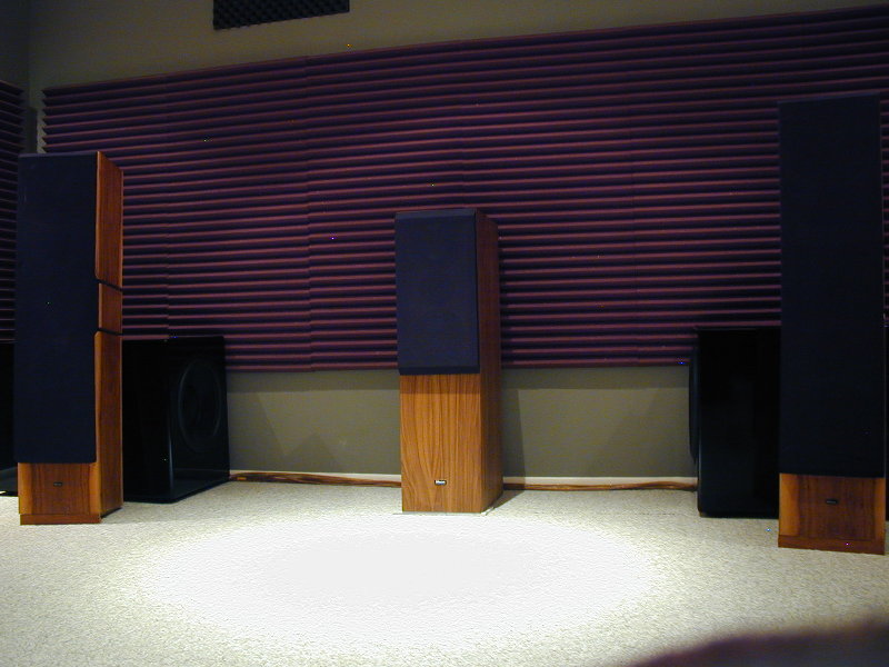

                                                          OK WillyD I've attached a few. Still need to mess with placement, but they're sounding really good so far :T "Superman Returns" had some serious bass in a number of scenes, but I haven't found their limits yet! :E

                                                          • WillyD
                                                            • 675
                                                            Those look so profressional.
                                                            Again, fantastic job.
                                                            • ssabripo
                                                              • 336
                                                              DAYUM! that's some serious finishing jobs! great work dude :T

                                                                  Dave, in post #20 you mention a hole at 120 Hz. Does this make any difference? I would have thought that this would be well away from your crossover frequency.
                                                                  Have you experimented with a series hookup of the sub drivers? I know you will have less power on tap, but you may still have all you need, judging by the fact that your main amp is the limit, now. This will effectively quadruple the damping factor and the effective gauge of your speaker wire and would make an interesting difference for comparison purposes. Many amps sound better into a higher impedance load.
                                                                  Finally, have you tried the speakers right in the corner on end, so one driver is facing down and the other up? Raised, of course!

                                                                          Brian,
                                                                          Can you post a picture of your quad cabinet?
                                                                          • Brian Bunge
                                                                            • Nov 2001
                                                                            • 1389
                                                                            I'll post them in several replies so I don't have to worry about shrinking them down. The cabinets are finished in black laminate so it's kind of hard to see detail (and my camera sucks). I'll try to get more pics later with my wife's Nikon D70.
                                                                            Images not available
                                                                            Last edited by theSven; 03 December 2023, 14:05 Sunday. Reason: Remove broken image links
                                                                            • Brian Bunge
                                                                              • Nov 2001
                                                                              • 1389
                                                                              Here are the rest!
                                                                              Last edited by theSven; 03 December 2023, 14:06 Sunday. Reason: Remove broken image links
                                                                              • JonP
                                                                                • 692
                                                                                Beautious! Black on black looks good... (and no, I'm not sucking up to Evil Twin...) :W
                                                                                A touch of black marker in those driver recesses, and they'll be ready for the Concourse...
                                                                                • Brian Bunge
                                                                                  • Nov 2001
                                                                                  • 1389
                                                                                  Thanks! I think they look pretty nice, but I just can't bring myself to put an all black speaker in my home (unless the cabinet is gloss black and that's a stretch even then). And yeah, I didn't think the edge would show. I dropped in the first driver and couldn't see the edge of the recess. Once I got them all installed and started looking at it I could see them.
