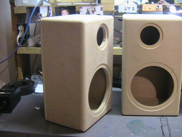

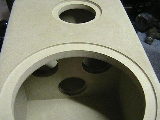

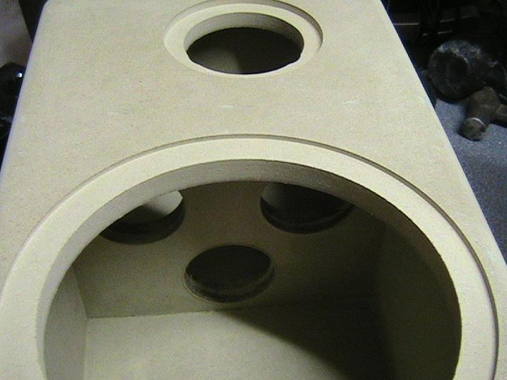

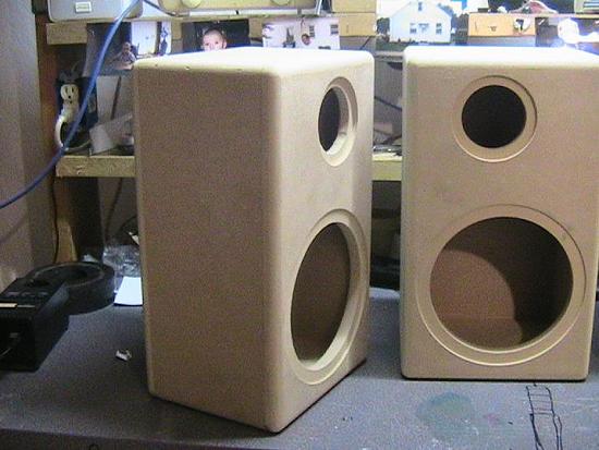

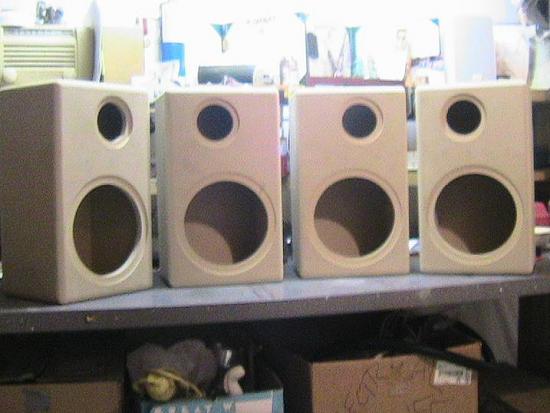

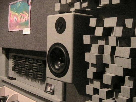

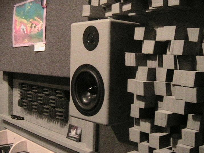

                                          cabinets done
                                          The cabinet guy finished my four surround speakers today.I opted to make the brace up higher and kinda cut the cabinet in half.Notice they are only 8" deep.They will fit perfect on the wall with smallish mounts.
                                          I ordered two Behringer A500's yesterday.Found a guy to do them for 179.00 shipped each .They will power these.

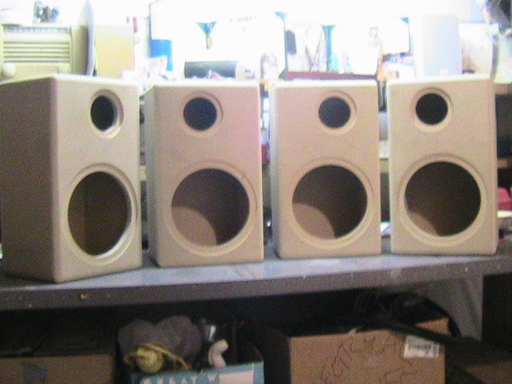

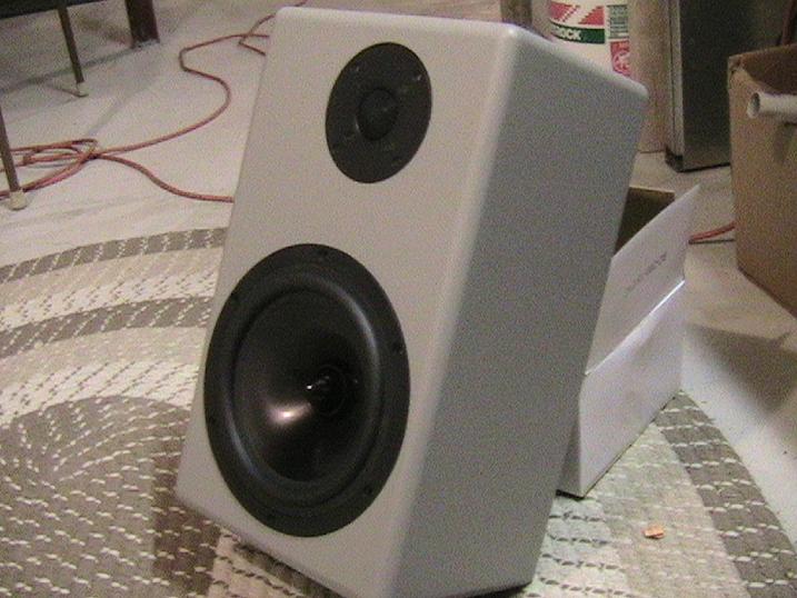

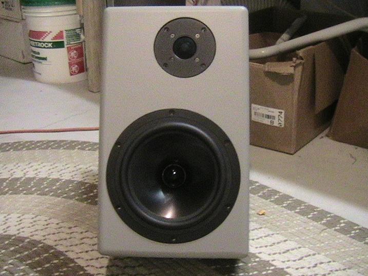

                                            The dry fit
                                            Who can refuse a dry fit. I could just imagine these with the 15" depth. Pretty damn stout !
                                            Well, I've got the BOM for the XO parts, but not quite the 450.00 for all four.Soon enough though.....
                                            KG

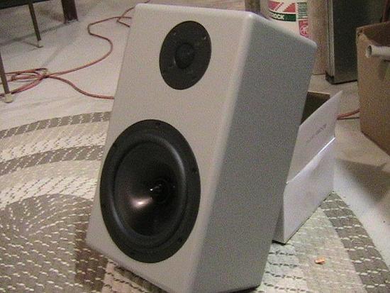

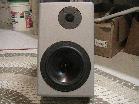

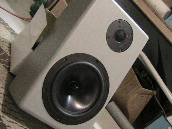

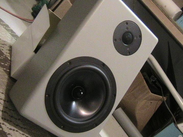

                                                                          One set done !

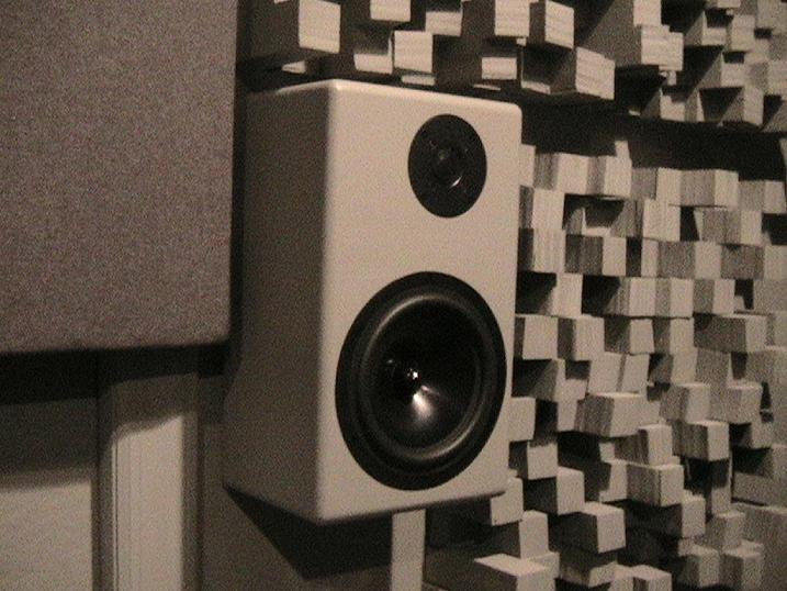

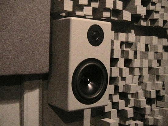

                                                                          Here are the finished 28a-225's....the diet version (8" thin) . Talk about blending in..
                                                                          I just got done watching "Cars". Can't wait to get the back pair done.EX was meant to be heard like this.I've got my Rat Shack Minimus-7's as back duty for now.
Name:	sm side1.JPG
Name:	sm side2.JPG
                                                                          • kano32
                                                                            • 56
                                                                            Nice job!
                                                                            How much money do you have invested in foam/room treatment. Looks like alot of work. Can you take a couple photos of the entire wall.
                                                                            • JoshK
                                                                              • 748
                                                                              When you finish up with that other pair you can get started on mine.

                                                                                Originally posted by kano32
                                                                                Nice job!
                                                                                nice, i would like to see some more pics too.
                                                                                BR
                                                                                • kgveteran
                                                                                  • 865
                                                                                  It's just that 2" blue foam insulation cut up with a foam cutter and painted grey.The panels are OC 703 board wrapped in roma wool.More time than money.
                                                                                    Where do I ship em' to ?
                                                                                    • kingpin
                                                                                      • 958
                                                                                      Hey Mr. KG
                                                                                      I love the way your finish looks on all of your speakers.
                                                                                      What is the product you use to paint them.
                                                                                      Is it just grey paint or something else.
                                                                                      It looks like it has some texture to it.
                                                                                      Mike

                                                                                        Originally posted by kingpin
                                                                                        Hey Mr. KG
                                                                                        Mike
                                                                                        The MDF is rounded over and I paint on latex satin with a roller.I do three coats, then sand with 150grit.Then two more coats.
                                                                                        I use those little rollers, only about an inch diameter.They cover pretty good.
                                                                                        Wash them first(the rollers) and let them dry.It eliminates lint from the roller.
