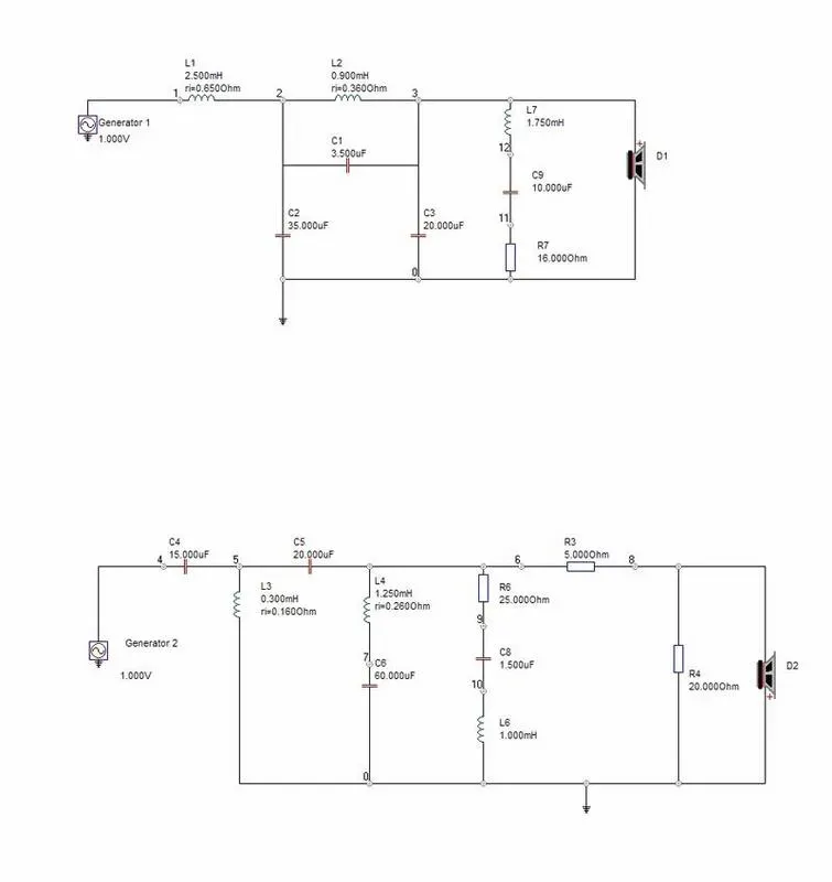

    I've been planning on building my first DIY set of speakers and I thought that Mark K's MT RS225/RS28A looked like a good bet. Instead of buying the PE box I plan on building it myself, but I want it to be pretty much the same dimensions. I have two questions:
    1) Will building my own box out of 3/4" MDF be any different than the PE box he used?
    2) Could someone help me design a cheaper crossover (I am a bit low budget at the moment) and also recommend what different types of components I buy. I know there's a lot of different types of resistors, capacitors, and inductors that have different properties. I'm quite new to speaker building so an explanation on your selections would be great.
    Thanks in advance
      IMHO, this is not really possible.
      The problem is that the RS225 has a severe breakup that required a complex crossover to tame. A less complex crossover would make these sound harsh.

                I would not recommend a cheaper xover. If you pull out the traps you get a less smooth FR. Not worth it in my book.

                    I'm a 150% with Mark on this one, obviously. It's only the secret sauce in this crossover design that makes it possible to do a two way with the RS225. Follow his recipe closely.

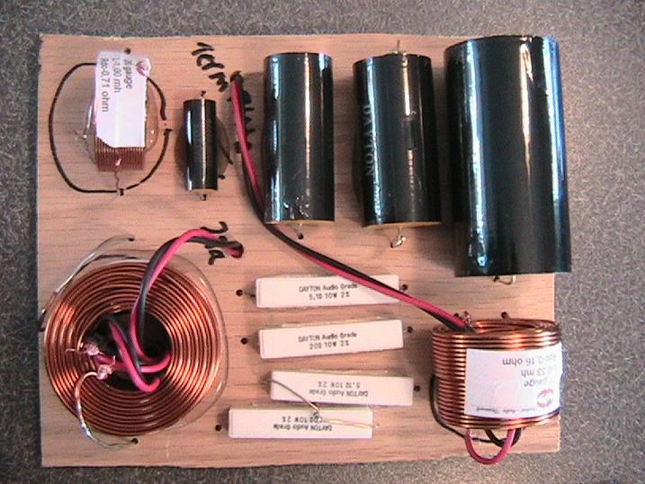

                                  • Gir
                                    • 309

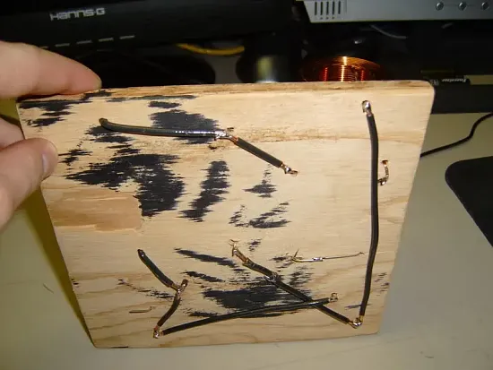

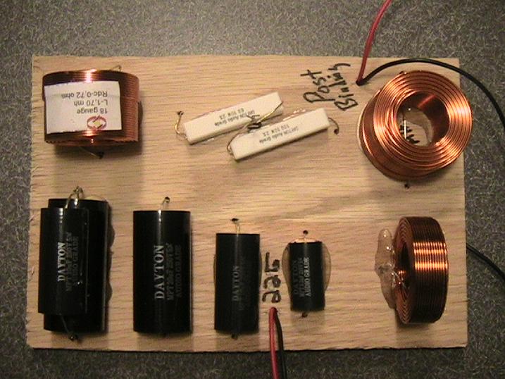

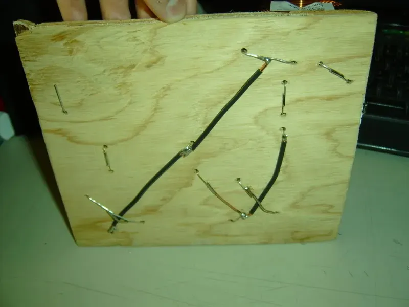

                                    Here are the pics of the low-pass filter. I'll have the other one done either tomorrow or wed. depending on how much work I have.
                                    [EDIT]
                                    Could someone please verify that I wired it right? I drew all the connections on the top of the board. Here are the schematics, thanks!
                                    Last edited by theSven; 25 July 2023, 08:30 Tuesday. Reason: Update image location
                                    -Tyler
                                    Under deadline pressure for the next week. If you want something, it can wait. Unless it's blind screaming paroxysmally hedonistic...
                                    • fjhuerta
                                      • 1140
                                      Did you use 18GA inductors? I think 15GAs would have been closer to the inductors Mark used... I'm not sure how audible your change may be, but I'd guess you'll have a little less bass.
                                      Javier Huerta
                                      • Gir
                                        • 309
                                        I used the 18's because of two reasons:
                                        1) They're cheaper : )
                                        2) They had the correct resistance and I wasn't sure if that would be more crucial than going for 15 guage, which brought me back to being cheaper : )
                                        Shouldn't it only be a problem if I'm putting a lot of power through 'em? These won't be getting more than 110 watts until/if I get a better amp.
                                        -Tyler
                                        • Brian Bunge
                                          • Nov 2001
                                          • 1389
                                          As long as the DC resistance of the coil matches what is spec'd in the crossover design then you are fine.

                                              Nope, you didn't miss anything. The DCR of the coils is part of the overall crossover design. As long as you are close you're fine. I've built a few speakers where I had to put a resistor in series with the coil in order to get the appropriate DCR (each time DCR was > 1 ohm). IIRC, this was a case where even with an 18-20 gauge coil the DCR was so much higher than the coil's DCR that I had to compensate for the difference.

                                                If you put an inductor in parallel with a resistor would that change any of the inductance and only the resistance?

                                                  That wouldn't work to give you a lower DCR since the inductor+resistor block would no longer work as expected- the inductor is being bypassed. If you think about it, anything above the inductor's cutoff frequency will pass right through the resistor, attenuated the same amount regardless of frequency.

                                                      That's correct, Gir. If you need an inductor with lower DCR, the the only way to get that is to use fatter wire, or less wire. It's expensive to use thick copper wire, so when people are on a tight budget and need a large inductor with low resistance, they usually use an iron or steel core instead of air core.

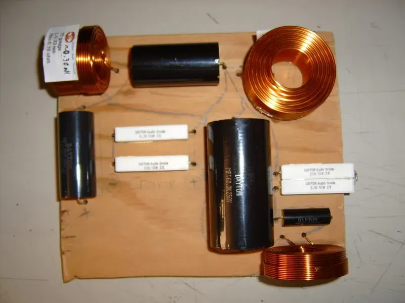

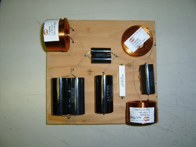

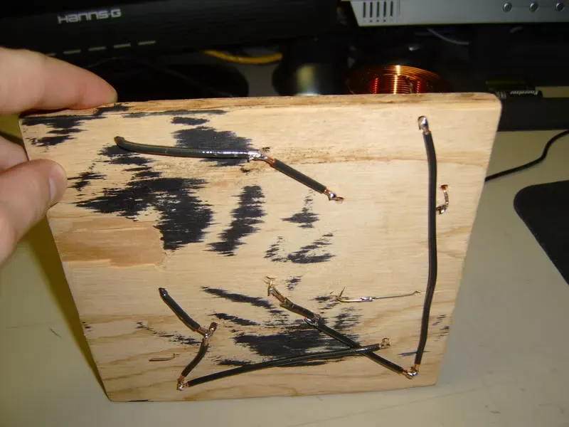

                                                              I just finished up the high-pass filter last night. Here's a few pics, let me know if you see anything wrong with the wiring.
                                                              Last edited by theSven; 25 July 2023, 08:32 Tuesday. Reason: Update image location
                                                              -Tyler

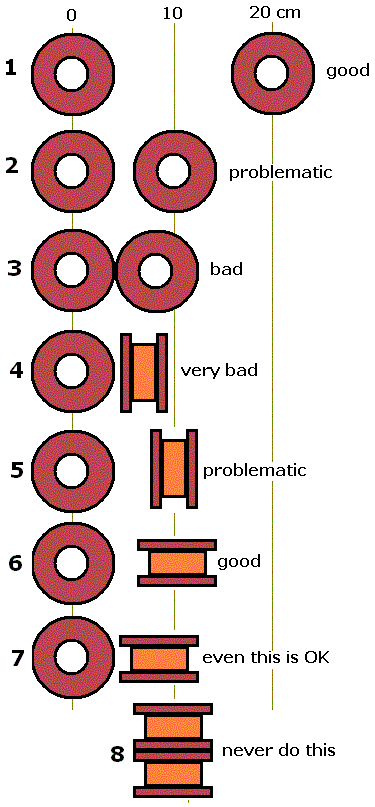

                                                                • 1456
                                                                FWIW, Darren over at PE used to say that you should not be able to look through the center hole of your inductor and see another inductor.
                                                                Yours look to be pretty far away from each other, so it may not be significant. However, based on his rule of thumb, both inductors one the end are not placed ideally (you can look through their holes and see the one in the corner between them). That would suggest that the ones on the ends would be better situated if they were turned 90º on their current vertical axis.
                                                                Of course, you would also have to take into account how the LP and HP filters will be mounted, relative to one another, in your box.
                                                                Dan N.
                                                                • joecarrow
                                                                  • 754
                                                                  Dan's right, the ideal layout would have been to swap the rotations of the upper left and lower right. However, the upper right and lower left look to be nearly two diameters apart and it's not like they're coaxial or anything- I don't predict any major ill effects.
                                                                  -Joe Carrow
                                                                  • Biff
                                                                    • 61
                                                                    I always thought you shouldn't be able to see through the holes of TWO inductors, which would place their fields parallel, as long as they are 90 degrees rotation from each other on any axis, wouldn't that make all copasetic?
                                                                      http://www.troelsgravesen.dk/coils.htm
                                                                      Last edited by theSven; 25 July 2023, 08:55 Tuesday. Reason: Update image location and url
                                                                      • Gir
                                                                        • 309
                                                                        Thanks for the pic Dennis, I was searching and searching for that pic all during classes today : )
                                                                        Once I get some more hot glue I'll flip the inductors around, thanks for pointing that out.

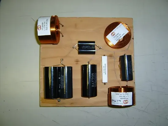

                                                                        • kgveteran
                                                                          • 865
                                                                          I think I might need to recheck my layout
                                                                          • Gir
                                                                            • 309
                                                                            Got yours flipped around as well?
                                                                            -Tyler
                                                                            • kgveteran
                                                                              • 865
                                                                              Looks fine.Second guess,second guess...it's a way of life .

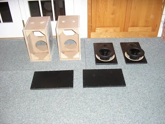

                                                                                      Quick update: I managed to scrape together enough money to finish these puppies! I wasn't planning on having enough until the summer, but I just got a bunch of rebates back and I managed to make it through this semester with spending only around $120 (that's including books!!). I'll be getting a 4x8 sheet of cheery wood veneer as well for only $30 (good connections), so I'm looking forward to teaching myself how to veneer. I should hopefully have everything minus the veneer by Wed. Also, I just finished building one pair of cables with cat5e (thanks ssabripo!).
                                                                                      In other DIY news, a beer pong table painting as an old school Nintendo controller will be finished shortly! Hurray beer!

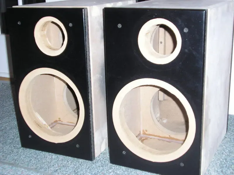

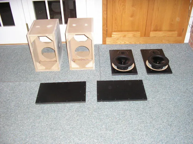

                                                                                          I just finished routing all the holes, and the speakers fit pretty well (the holes are just a wee bit too big). Here's some pics:
                                                                                          So, as I was dry fitting the speakers, I realized I over looked one teeny-weeny little problem... how the hell do I mount them? I've heard of people using t-nuts and such, but would it work if I took small pieces of plywood and put them on the back of the front baffle to hold the screws? I'm trying to save a trip to the hardware store : )
                                                                                          Last edited by theSven; 25 July 2023, 08:37 Tuesday. Reason: Update image location
