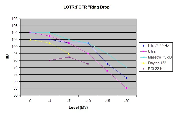

                          I was able to do the Fly-by and made it up to +2 MV before the neighbor came over..I guess she just made it home from work and started her evening out with putting the kibosh on my little test. :roll:
                          At -2, I was hitting 110dB with no compression referencing my prior readings, so I went ahead and did a 4dB gain in MV to +2 over reference ant hit 114dB. Still no compression! I know It has at least a couple more dB in her from the resulting readings prior to 114dB. I'm wagering around 116 to 17 now. Very impressive considering other options including higher tuned subs I have measured in my leaky 2880 cu ft room. Now this is a 30-50hz scene!..in it's home territory 15??-25 Hz, I have no idea what it could do?
