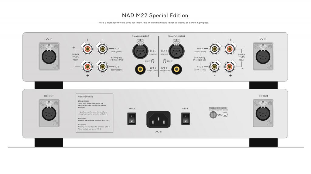

    1. The primary goal of this project is to take the original NAD M22 (Hypex NC400) and make it live as a permanent bridge-mode amplifier x 2. Effectively using 2 x M22 as a stereo amplifier in one chassi, returning a whopping 2 x 900W (1 kHz 8 ohms 0.1 % THD).
    2. The PSU gets a separate chassis to get rid of AC noise and make room for the doubling of components.
    3. A side mission is to look over all components used and improve / replace when and if needed. Such replacement can simply to to get rid of electrolytic capacitors and use Metalized Polypropylene Capacitors or Foil Polypropylene Capacitors, Thin Film 1206 resistor etc

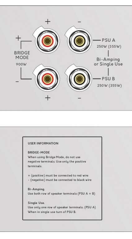

    Now for the core of the thread. The original M22 does not have internal bridge mode options but can be bridged using an external XLR Bridging Y‐Adaptor and using the left + terminal and right + terminal, all of this is external means to run the M22 in bridge mode.
    Connect the Positive Speaker Lead coming from your Right Speaker to the Right Channel Positive (Red) Speaker Output. Next, connect the Negative Speaker Lead coming from your speaker to the Left Channel Positive Speaker Output of the amp as shown in the picture above. The Negative (Black) speaker output must not be used in a bridged mode.
    The M22V2 comes along and offer internal bridge mode which also is using + terminals only - see image
    Moving forward my question is directed towards how to solve the x2 M22 constant bridge-mode configuration. Should I simply go for an internal wiring which mimic that of the external XLR Y-adapter and also connect the left and right positive lead to the output terminals - which would be labeled positive and negative on the outside of the amplifier ? This causes the least hassle and issues in regards to keeping the circuit as is.
    M22V2 has a 20% increase in power delivery from the PSU, this could be as simple increasing the size of the capacitor bank for increased power headroom.

          Done with the threads
          I think I will go for an internal bridge mode which leave the circuit pretty much intact, minus my own mods and custom solutions. I will keep the thread going from time to time when I have some updates. I am just about to start the parts list "overhauling" which will take at least 1-2 weeks as its a crucial section of the project. Until that is ready, take care.

Name:	NAD M22 Special Edition_HD.jpg
                • Oneminde
                  • Feb 2018
                  • 91
                  First version.
                  • Oneminde
                    • Feb 2018
                    • 91
Name:	NAD M22 Special Edition close up.jpg

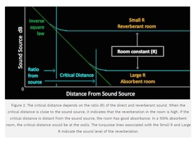

                          While the whole power need topic has many variables there are also some practical aspects that explain why many of us are perfectly happy also with 80 or 100W amplifier on 86dBSPL/1m sensitive speakers.
                          The actual SPL drop in living room size listening rooms does not follow the inverse square law all the way to 3.5m
                          Most of the music in Streaming or CD-s will have less (and often much less) than 20dB dynamic range. So the need for such high headroom for peaks is rare. Perhaps only if one likes classical pieces with big orchestra etc.
                          Check here
                          If many of the albums you listen are in that DR >20 group then sure, it makes sense to tune your setup to that direction.
                          I'm also listening to NCore NC500MP OEM - ie 500W amps with my Wavecor Ardent's, but not really because I believe I would need that amount of power, but rather because I found a good enough deal with those to get me into the NCore user group. I did contemplate to buy a used NAD M22 at the time too, but at 2x the cost decided against that plan.
                          Image from here
Name:	critical distance.jpg
