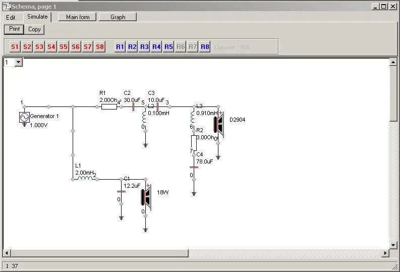

              Here is what I finally came to in the end.
              If you can try this crossover out with whatever parts you have lying around. As Jon says the fact that the D2904/9800 is 4 ohms and the 9700 is 6 ohms can throw some things out of whack. L3, R2, and C4 is a filter put in specifically for the 9800. It should probably be changed for the 9700. I am sure that the 2 tweeters exhibit a certain common set of characteristics, but I do not know what they are and I would just be guessing.
