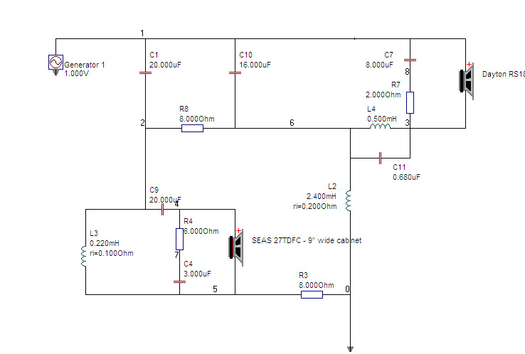

    Does the Modula MT crossover compensate for the fact that the tweeter and the driver are radiating from different planes, i.e. are there delay networks inserted in the tweeter side of the crossover, and if so, can someone point that out to me?

    It's allll part of the package
    When designing crossovers you don't have to do everything as a discrete circuit.

      It uses mixed order slopes to compensate the different acoustic centers of the drivers. Unless true LR2 slopes are implemented, a separate delay network (e.g., the one used in Zaph's ZD5 design) is rarely used.
