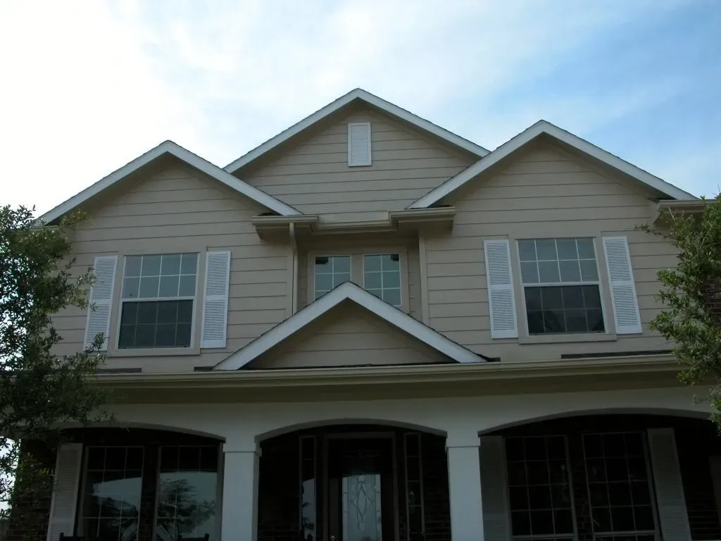

                    Well after climbing around in my attic some more and crawling around with a flashlight, it appears that doing an IB sub in the front of my theater room is not going to be possible. Here is a pic of the front of my house:
                    The upstairs room on the left is the theater room. The screen is going in front of the window. The area in the attic over the screen area is that tiny peaked roof. The clearance in there is not high enough for a manifold and that area is almost sealed off from the rest of the attic.

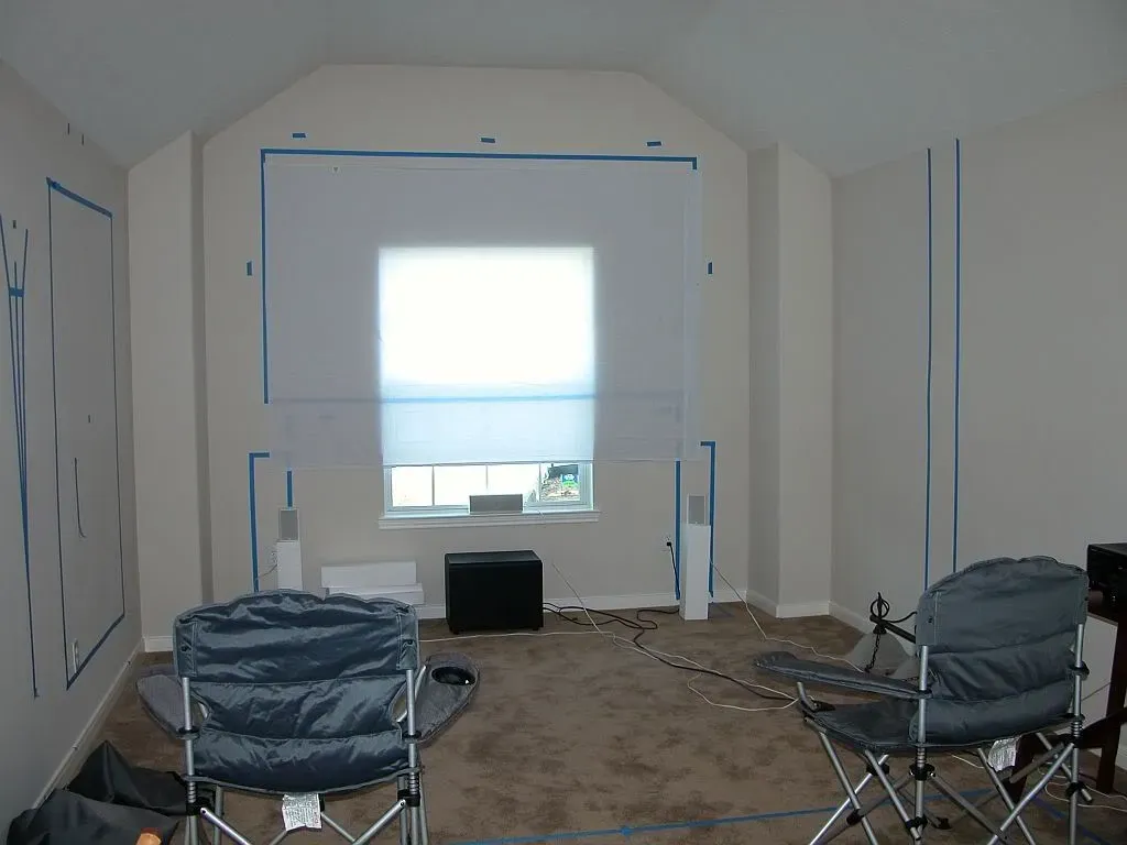

                    Here's a shot of the theater room from the inside (this project is just starting):
                    The screen is going to be flush with the front of the corner square "columns". Those are some old Jamo speakers that my wife had when I met her. They were fine in our old house in the family room for normal TV watching but they don't cut the mustard for home theater. I'm going to try putting the sub in the picture on a ladder and try a spot about 8 feet from the screen but I just don't think that being that close to the center of the room is going to work properly. So I may be back to making a big sealed sub with a pair of 15" subs for under the screen.
