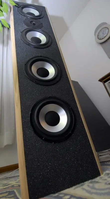

      Add 2 more DA175's and you'll have a pair of speakers that'll try and disassemble your house.

          Rudy,
          I've thought about building that speaker with the Seas tweeter. I think that it has a lot of promise based on what Pete has shared with me about it.
          • Rudy Jakubin
            • 58
            Add 2 more DA175's and you'll have a pair of speakers that'll try and disassemble your house. Pictured here is Pete Schumachers MTMWW's which I've also built.
            Pete used the Hi-Vi K1 tweeter. I've tried the K1, Seas 27TDFC & TBFGC/G, Peerless HDS, RS28a & the North D25's. Presently I've got the Norths in there now. All crossovers were done by Pete and tested by me. Awesome speakers, clear and well defined bass that'll hammer you in the chest. Detailed mids and of course the tweeter of your choice. Sadly the North's are no longer sold. There is also a crossover for the Vifa Neo D26NC55.
            There is also a design with 4 DA175's in a TMWWWW using the RS52 mid and Dayton Neo. The imaging with these are superb. I've named mine the Pristina's.
            That's the first impression I've got when I listened to them for the first time.
            You must love bass because these speakers will reproduce them with resolution.
            You'll love the bass guitar, drums and the piano soundboard when the lower keys are played.
            Here's a link with more info;
            Click image for larger version  Name:	SchumakubinswithK1tweeterMTMWW-2.webp Views:	0 Size:	33.3 KB ID:	944113
