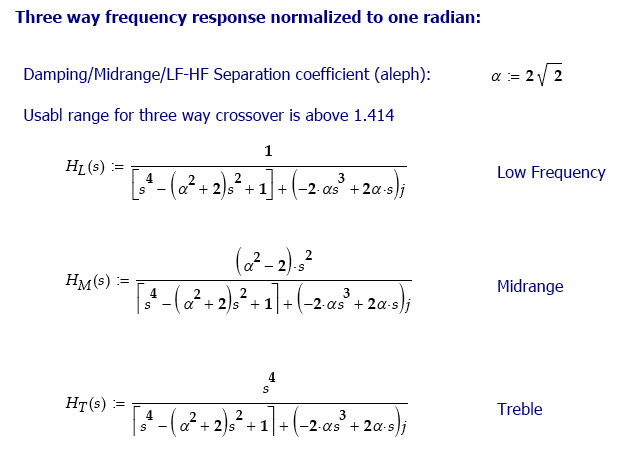

                                      Proposed 3-Way Transfer Function Model
                                      While the greatest interest in developing the Duelund style crossover holds for the larger systems, a brief examination shows it holds potential for this center channel HT design also.
                                      The most interesting aspect is that if properly executed the drivers are all in relative phase with each other at any frequency, with a net total phase rotation of 360 degrees from the low bass to the treble, similar to the phase rotation of a two way LR-4 crossover, but with lower peak group delay.
                                      For a first look, a damping coefficient of 2.828 was used, with a nominal center frequency for the midrange of 1500 Hz.

                                      This proposed transfer function should support playback levels over 100 dB; notch filters will be required to suppress the midwoofer breakup as well as the midrange breakup, but as the nominal transfer function level will be below - 24 dB, impact on amplitude and phase for the overall transfer function should be acceptable.

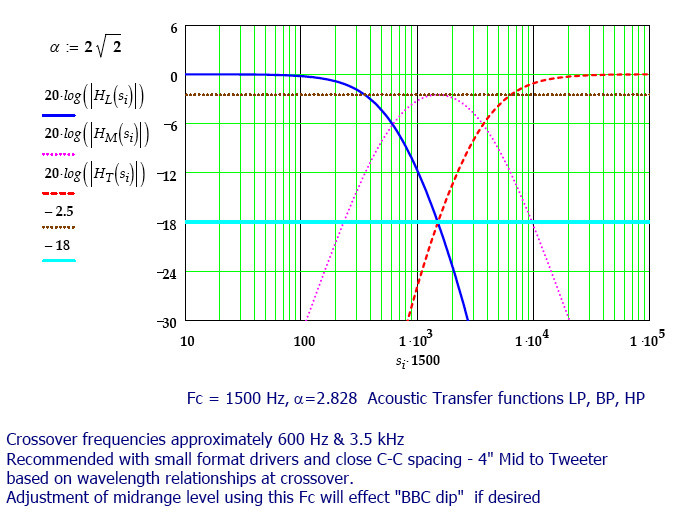

                                              A more conventionally scaled plot of the suggested acoustic transfer function.
                                              Note that the drivers are -6dB at the crossover frequency, not -3 dB as in most conventional crossovers. This may be adjusted to fill in the power response; it matters whether a BBC dip is preferred (better for most commercial program material), or something closer to flat power response, which could justify elevating the midrange level a couple more dB.
                                              This suggests a two or three way switch control- "Presense".
