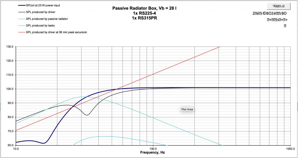

                        • 16172
                        1.5 cu ft RSS2265 200g Updated
                        Now, when I say, "monkey coffins", consider that Unibox suggests that a "Standard Design" for a vented enclosure for the RS225-4 would be a 51L enclosure. That's larger than the Wavecor Ardents, with two 8-3/4" drivers. For the sake of round numbers and those "Imperialists" that like to work in cu ft, we could round that up to 56L.
                        Well, initially I rebelled at that idea, and figured that 1.5L might be fairly workable and still hit some nice targets. And in fact, when considering opportunities for flat pack construction and getting SOMETHING together really fast, I decided to even consider 28L/1cu ft. So that's what we'll go over in the next posts, starting in the middle, as my thinking did, and showing the alternatives.
                        Now, that Q Audio 3030i has a nice long port exiting the back- one of the things which that form factor enables. This alone is good reason to consider it. But I'm less and less a fan of conventional vented designs, though I will show an example, and in the case of enclosure flexibility and eliminating midrange contamination, I've had very nice results lately with Dayton PR's. It may not be well known, but they're some of the best documented parts on the market, coming with a nice weight assortment, and I've had good results with them in several systems. So, the RSS265PR was selected as a "perfectionist" option to consider. The standard weights have pretty significant jumps in mass, but I've found the single disk alignment to work well in many cases, with an MMS of 275g.

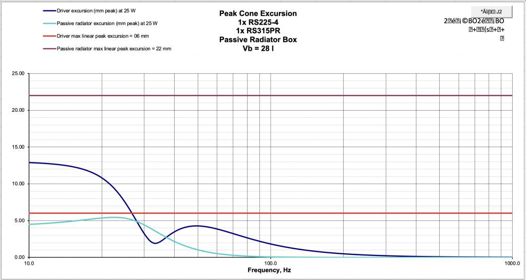

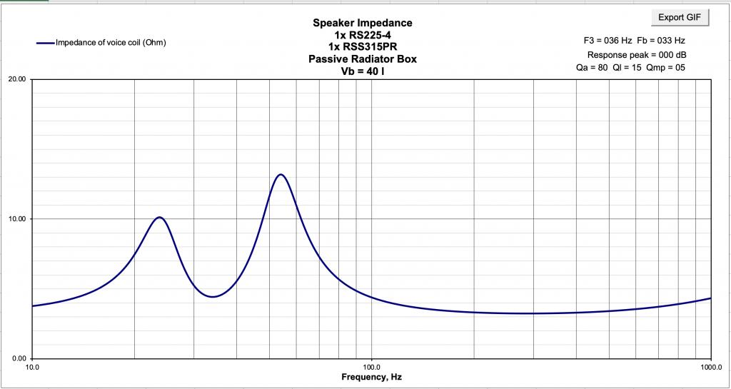

                        So, let's start with the initial concept based on 1.5 cu ft:
Name:	RS225-4_RSS315PR-300g Design.jpg
                        How does this look? Pretty nice, I'd say...
Name:	RS225-4_RSS315PR-300g Excursion.jpg
Name:	RS225-4_RSS315PR-300g Impedance.jpg
                        when you consider that any reasonable positioning and boundary lift is going to raise the response by 3-5 dB by 30Hz, this looks pretty good, 100dB from a single 8" driver. (well, plus a 10" PR!).

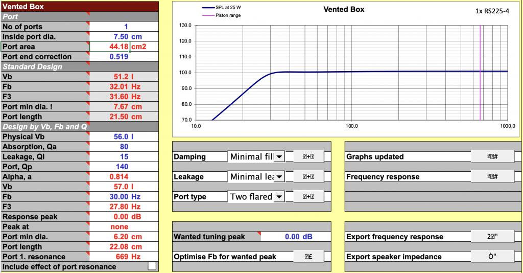

                          • 16172

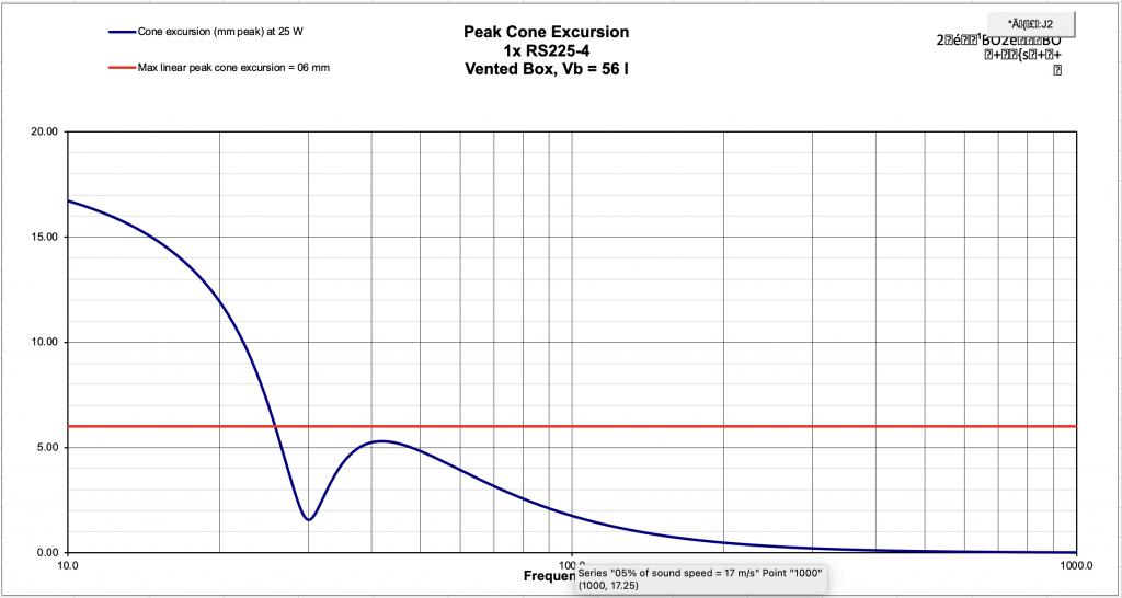

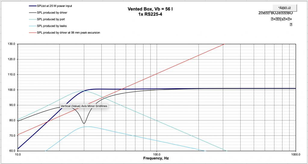

                          2 cu ft Vented
                          Now, what about a vented design? And what about that 50+ liter recommendation? If you're willing to live with a larger box, and want to keep the budget down, what is possible?
Name:	2cu ft Vented Design.jpg
                          Essentially flat to 30Hz, nothing to complain about here!
Name:	SPL 2cu ft vented design .jpg
Name:	Excursion 2cu ft vented design.jpg

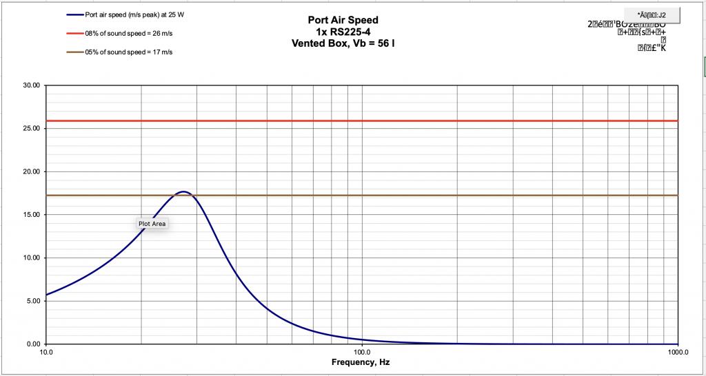

                          At nearly full output, it's just starting to enter the brown zone for a port ID of 3", and length (not including flares) of about 9". So, it's easy to see why the enclosure arrangement with depth has some advantages.
Name:	Port Air Speed 2cu ft vented design.jpg
                          The main drawback of the port is the midrange output and port resonance of about 670Hz, which in a three way would not likely be an issue, but for a two way perfectionist approach one might prefer to avoid. I'll explore some 2cu ft options with PR before we wrap this part up.

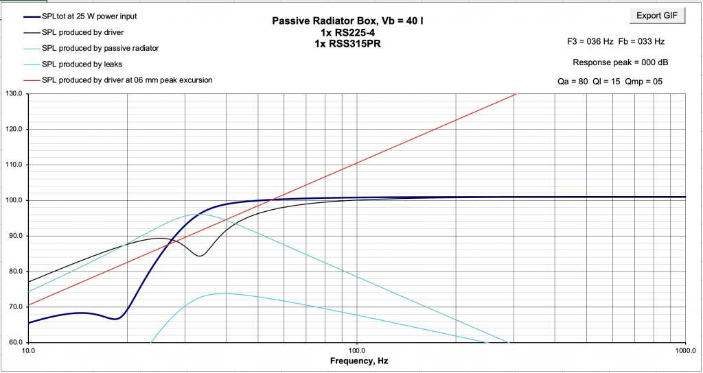

                            • 16172

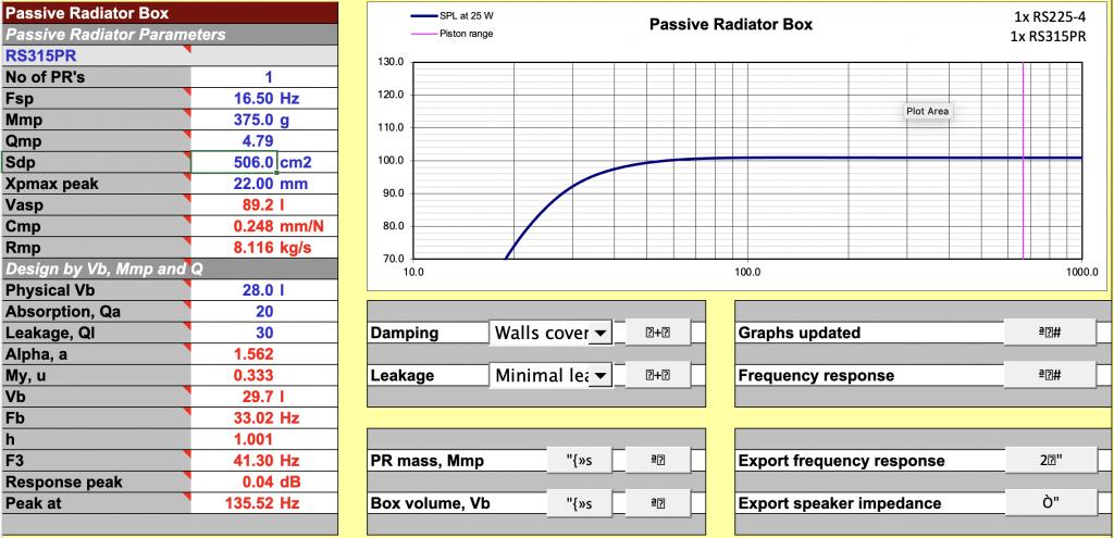

                            1 cu ft PR Design Updated
                            The next enclosure size I considered in detail was the 1 cu ft concept- this would certainly have some limitations for low end extension, and likely would not be feasible with a ported approach, but might, "might" have some value if a PR is used- and I had a way to put together a test example quickly. For this example, we need a bit more mass and different parameters, in this size box, and I had a "hunch" about how this might model out that proved correct.
Name:	1 cu ft RSS315PR 375G design.jpg
Name:	1cu ft 375g SPL.jpg
                            Helmholtz alignments are often characterized with descriptions like electrical filters, and this example is about as close as you'll ever see to what looks like a QB3 high pass alignment with a PR, which is nominally a 6th order systems, unlike vented boxes which are 4th order. This gives a slower roll off and maintains system loading down to lower frequencies- it's popular for vented alignments, too. So, it's nearly flat to 40Hz, and gives some loading down to the mid 30's. For the size of enclosure, that's not a bad set of tradeoffs.
Name:	1 cu ft 375g Excursion.jpg
Name:	1 cu ft 375g Impedance.jpg
                            The modeled impedance curve doesn't look like it will cause any problems, either.

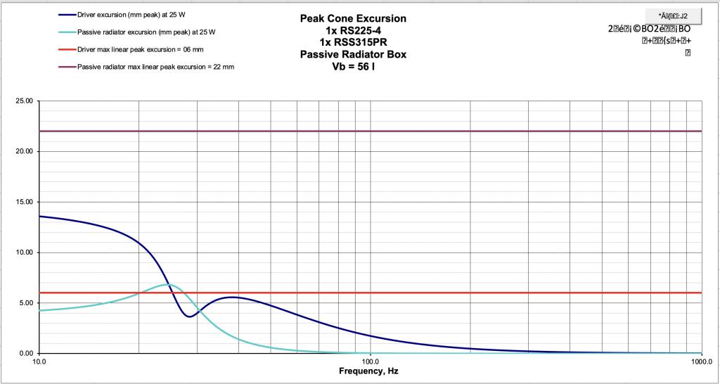

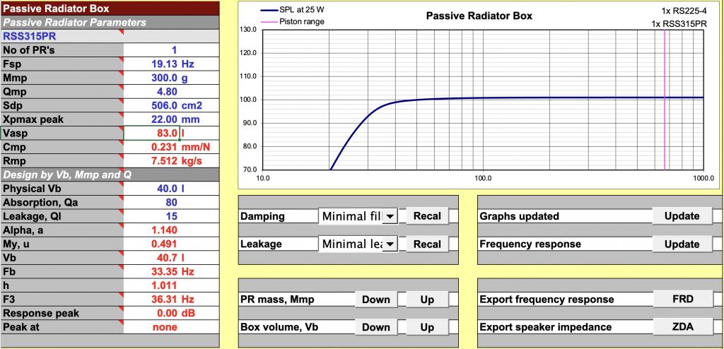

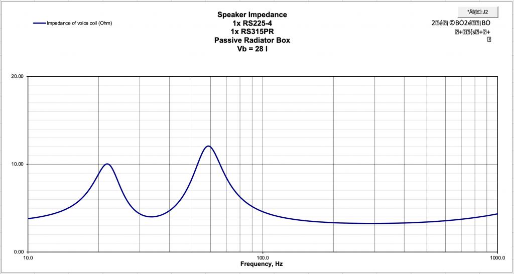

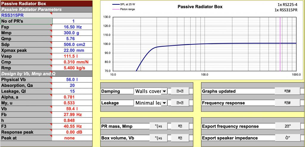

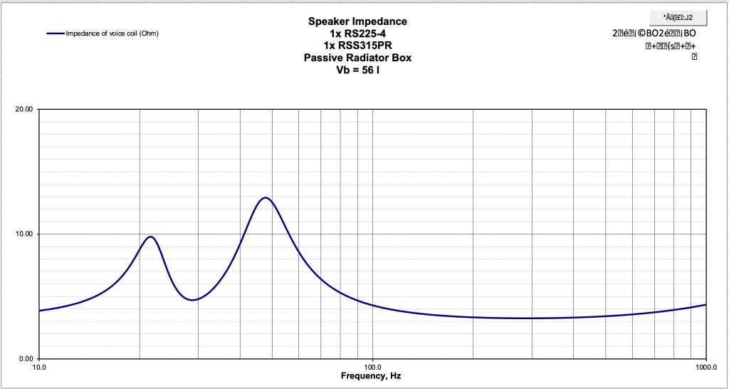

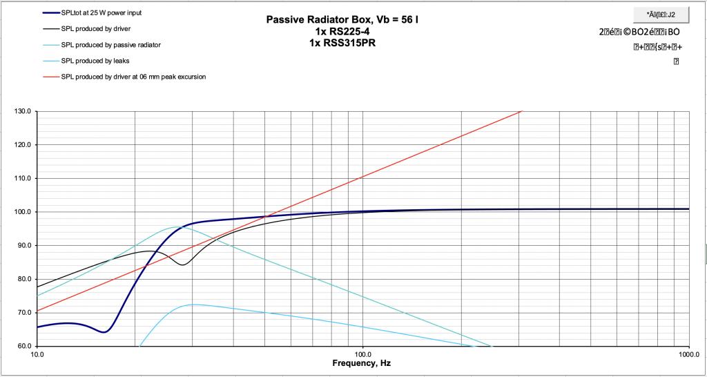

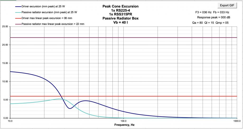

                              • 16172
                              56L Updated RSS315PR 300g MMS PR
                              OK, time to look at the big boy PR options...
                              There's two ways you could do this- one with two RSS265PR, and one with a single RSS315PR- you don't need a degree in accounting to know which is more cost effective.
Name:	2cu ft RSS315 300g Design.jpg
Name:	2 cu ft RSS315 SPL.jpg
                              We've definitely got some extension on the bottom end, now to below 30Hz, but the soft drift downwards in response is looking like an EBS alignment, which can be useful for a sub, but not really be what we want in a stand mount or small tower full range speaker.
Name:	2 cu ft RSS315 Excursion.jpg
Name:	2 cu ft RSS315 Impedance.jpg

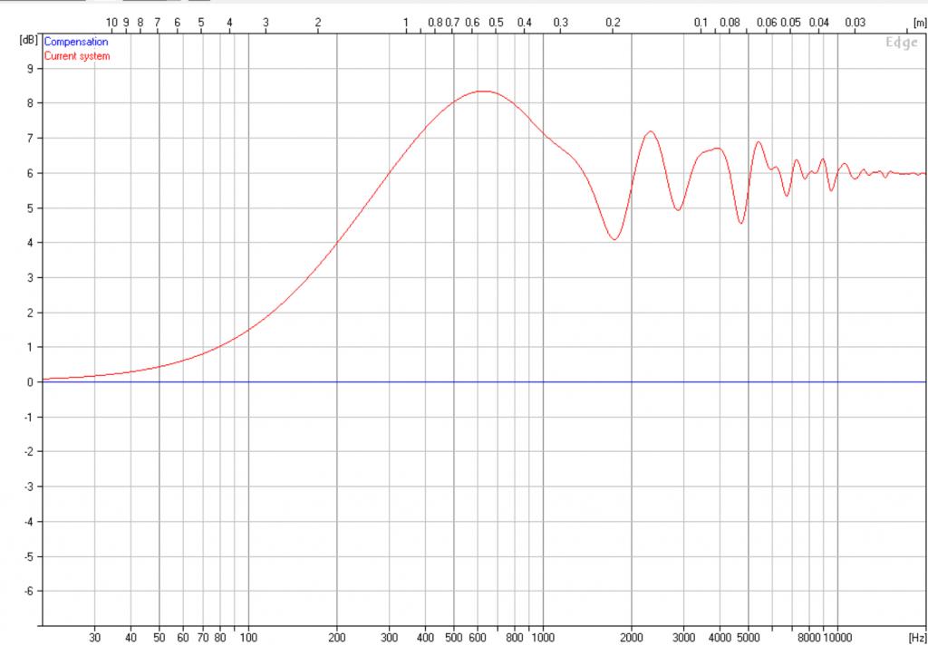

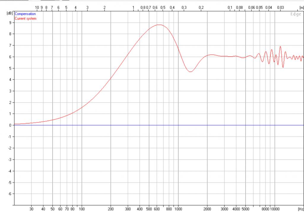

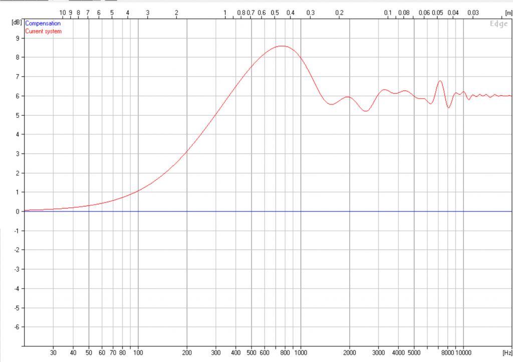

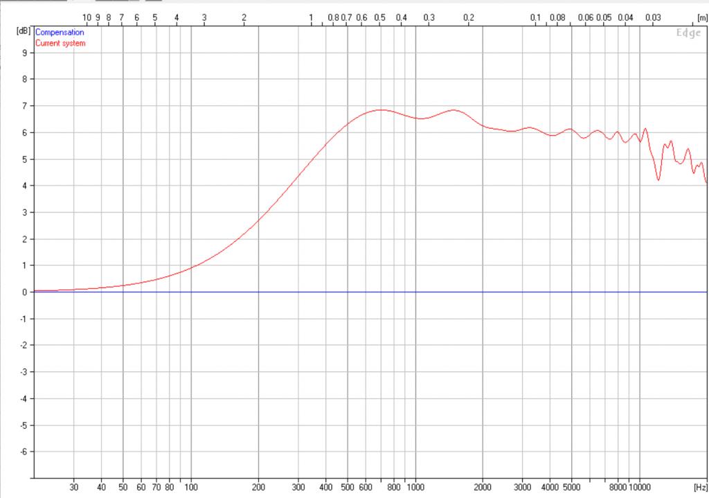

                                • 16172

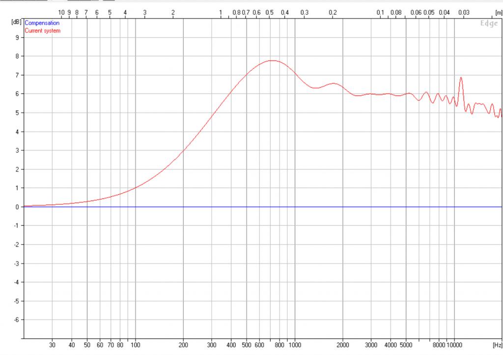

                                Baffled about baffles?
                                This is where things may get either interesting or tedious, depending on your turn of mind.
                                We all know how baffle width for a tall speaker will control baffle step drop off behavior, in general terms. And that if you want to play with an existing design, without modifying the woofer crossover (or more) you better keep the main width parameter the same.
                                But, these are sort of bare bones generalizations.
                                One of my favorite tools for exploring baffle and driver interactions is Tolvan's "The Edge". If you want to have an idea of what you're getting into before you start cutting wood, it can be very helpful. And I'd say it's one of those things that may help define the difference between a good design and a perfectionist design. Because baffle step behavior may not be just a simple 6 dB drop off... compensated easily with a single pole and zero.
                                Let's investigate a bit...
                                For those interested in more about "The Edge"
                                I explored a number of baffle sizes, based on build possibilities, and will share data using more "conventional" layouts and also that which by "The Edge" seems to me to be more optimized. - and share why. Most of these are based on using or adapting flatpack cabinets available off the shelf, as most of my tools are in storage, pending a move sometime in March to a new home.
                                • 14" x 14" baffle, as is found on the 1 cu ft Denovo sub cabinet
                                • 12" x 16" Rectangular- somewhat similar ratio front panel as 3030i
                                • 12" x 19" - a larger rectangular front panel of dimensions common to many "traditional" speaker designs, and which could be obtained by cutting down the 2 cu ft Denovo sub cabinet, seeking a 1.5 cu ft cabinet design ready to construct
                                • 16" x 19". front panel- the front panel dimensions to the 2 cu Ft Denovo cabinet

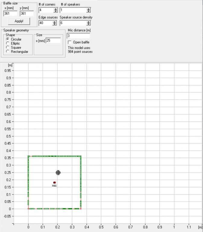

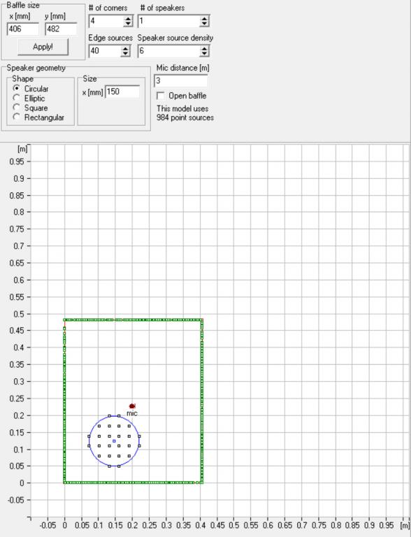

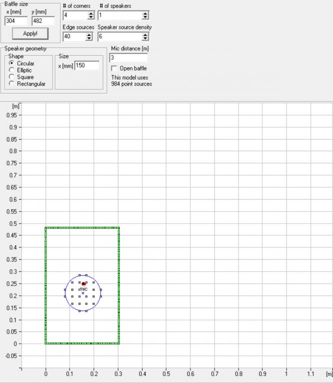

                                  • 16172

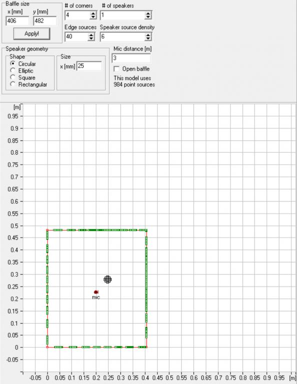

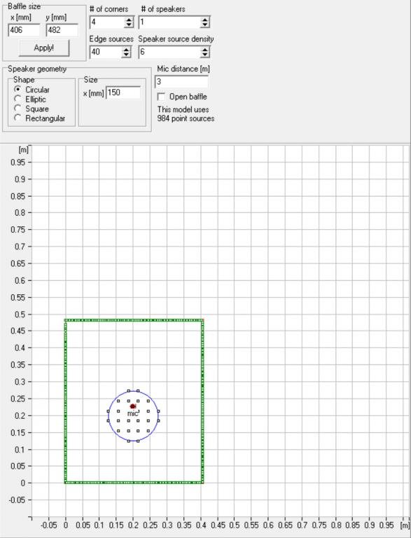

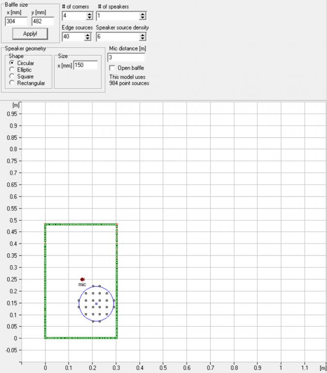

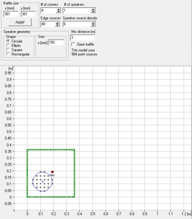

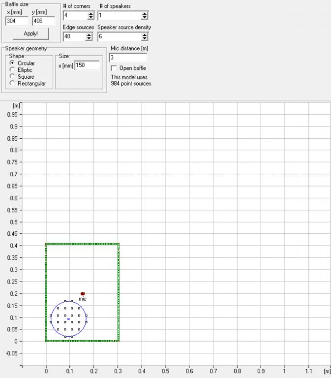

                                  For the baffle concept for the 1 cu ft sub enclosure, I did not prepare a "conventional" driver location example, as this is hardly a conventional format for a two way speaker.
                                  Setup of The Edge included the following parameters for analysis:
                                  • Edge sources: 40
                                  • Speaker source density: 6 (both woofer and tweeter)
                                  • Mic distance from baffle: 3m

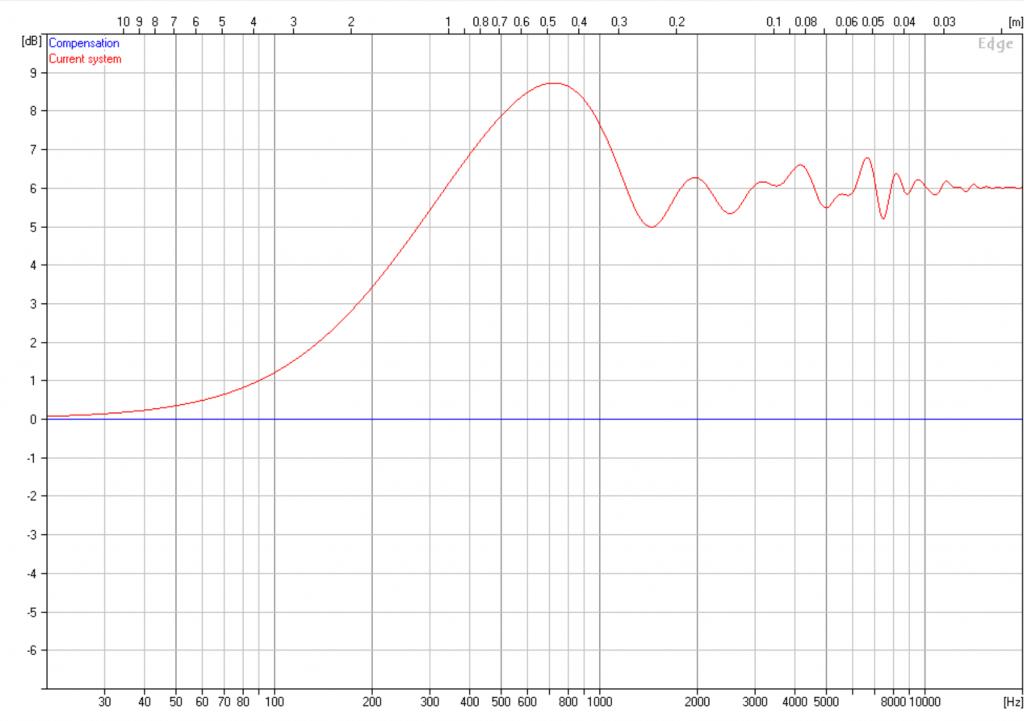

                                  Let's start off with the woofer model that produced the smoothest modeling result with minimal dips and peaking:
Name:	Obi-Wan Woofer POC Baffle.jpg
                                  Note the asymmetric location.

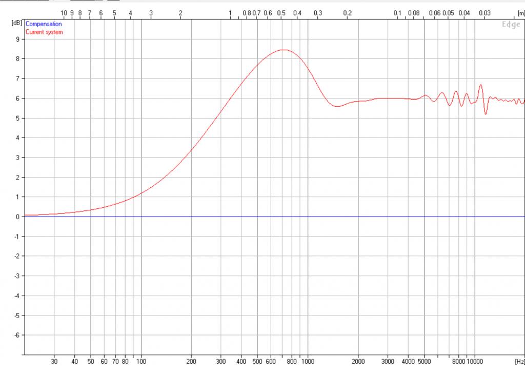

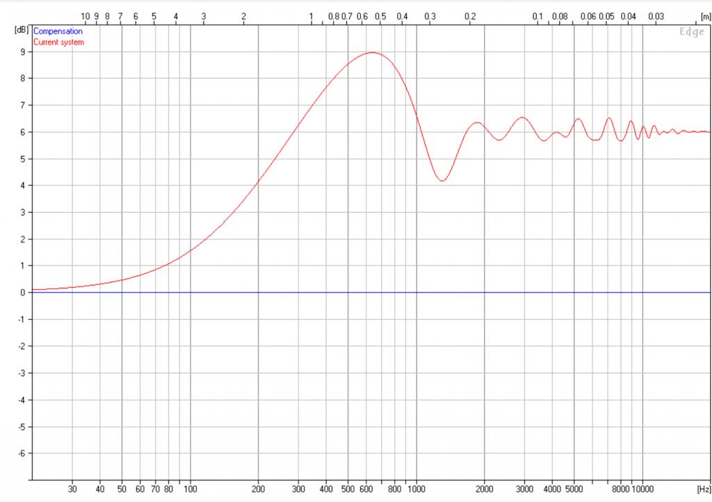

                                  Modelled on axis response at 3m:
Name:	Obi-Wan Woofer POC Baffle Response NoPhase.jpg

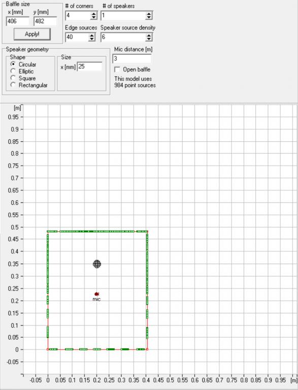

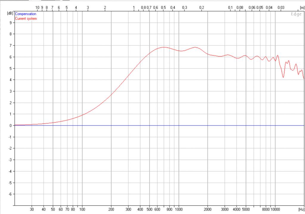

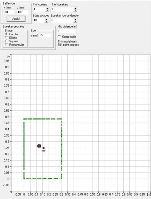

                                  Now, about the tweeter... folks often don't think about baffle step impact on tweeter response, though it can happen, and it's quite important for midrange drivers:
Name:	Obi-Wan Tweeter Baffle.jpg

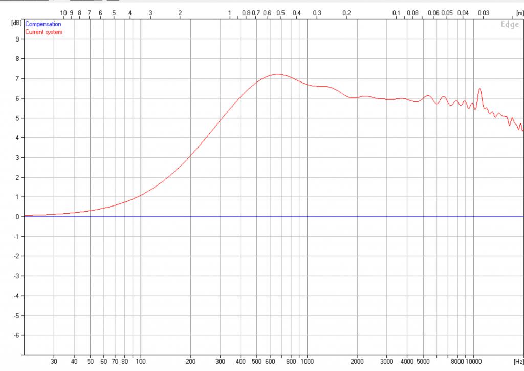

Name:	Obi-Wan Tweeter POC Baffle Response.jpg

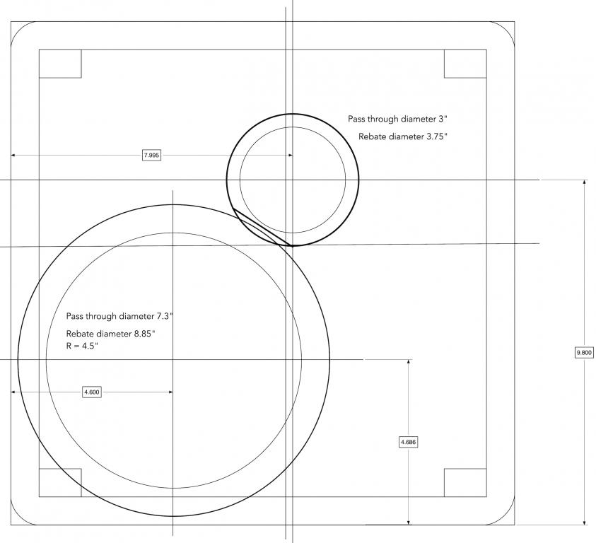

                                  If I go ahead and build a 1 cu ft example to test (substantial likelihood) this is how I'll layout the baffle. I looked at pretty much every other imaginable configuration- takes a little time, but informative.

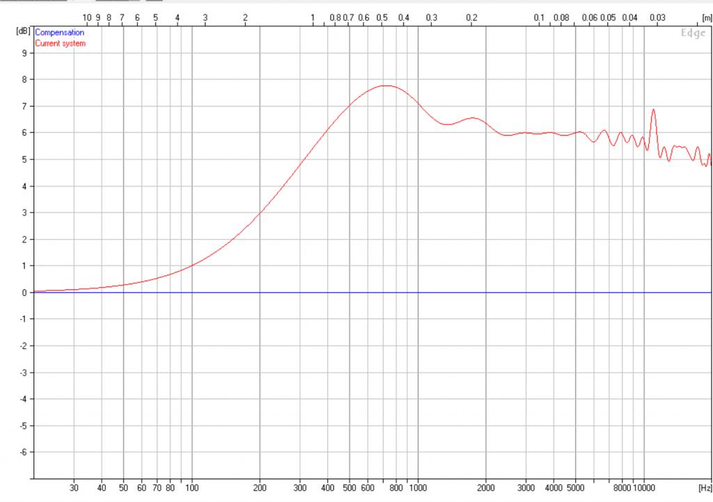

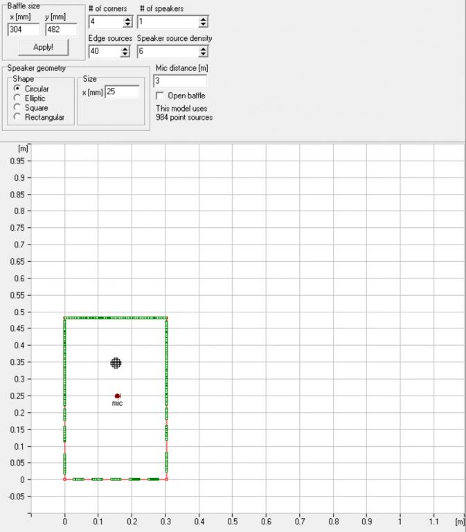

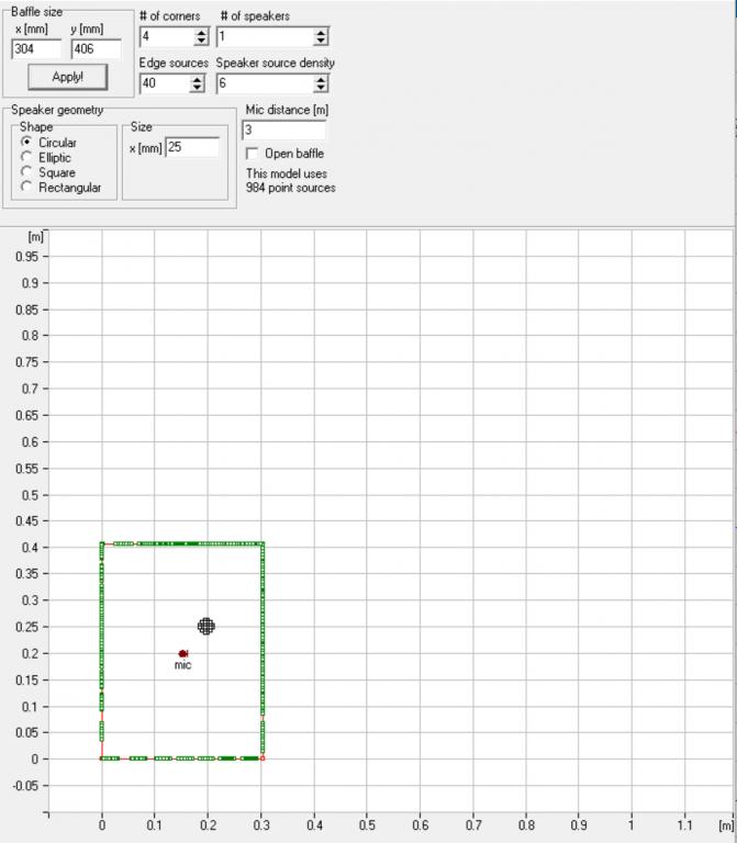

                                    • 16172
                                    12" x 16" rectangular baffle

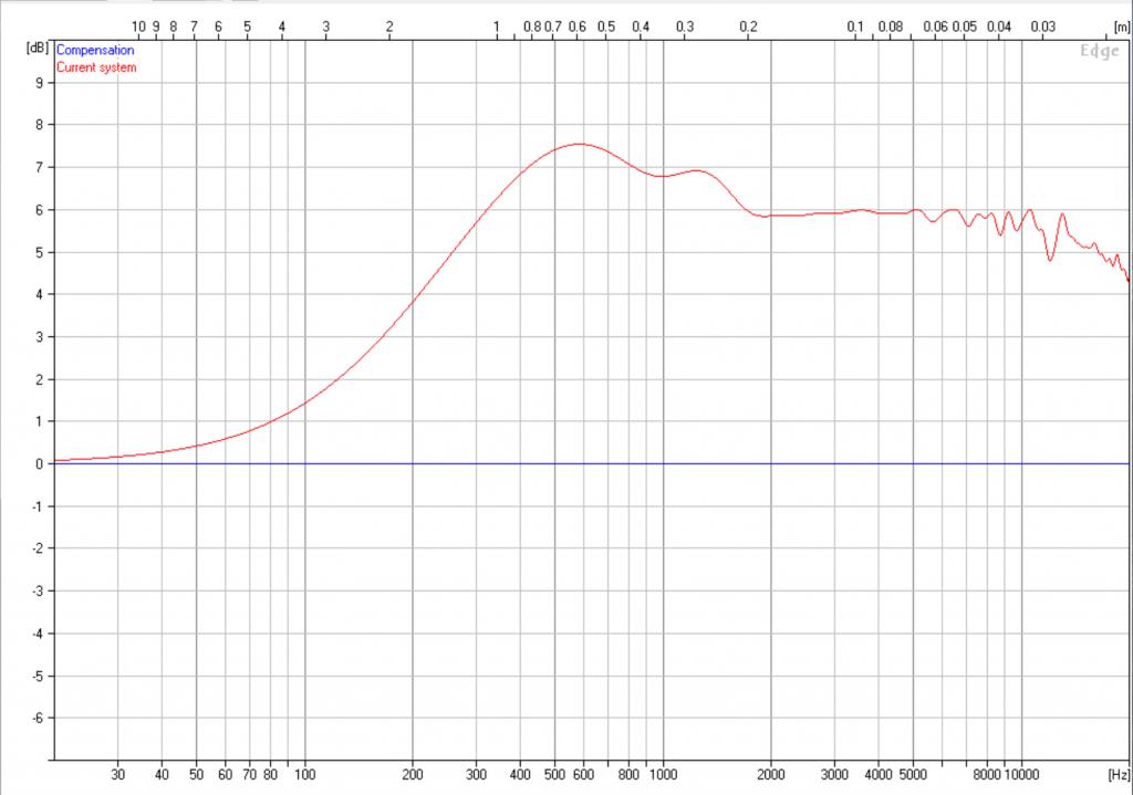

                                    Next up is what I call the small rectangular configuration- 12" x 16", which could be approximated in a hurry with a cut down version of the 1.5 cu ft Denovo enclosure.
                                    First, the selected woofer configuration:
Name:	Obi-Wan Woofer POC 12x16 Rect Baffle.jpg
                                    And the calculated response:
Name:	Obi-Wan Woofer POC Rect Baffle Response.jpg
                                    This should create few problems for the crossover.
                                    Next, the tweeter position and analysis:
Name:	Obi-Wan Tweeter Rect Baffle.jpg
                                    And the modeled response:
Name:	Obi-Wan Tweeter POC Rect Baffle Response.jpg
                                    This slight boost in the tweeter lower output range may not wind up being particularly useful, but it's much better than the dips higher up that other locations produced. I'll show some examples I saved for the next baffles modeled.
                                    This is a baffle size and response that appeals to me for a full custom build.

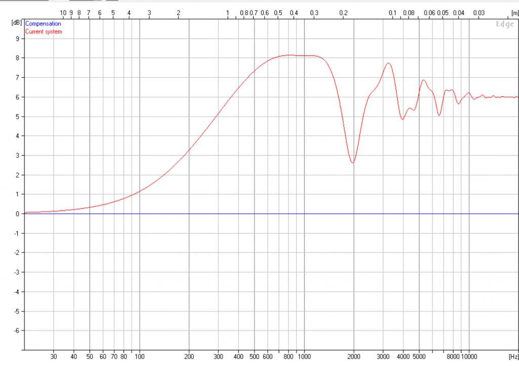

                                      In neither case does this look like a baffle response I would like to work with.

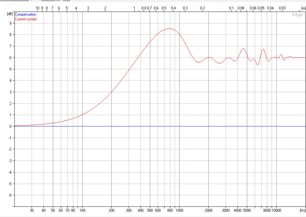

                                        • 16172
                                        12" x 19" Alternative locations
                                        So the question becomes, for this baffle size, can we do better? Or is this just not a great baffle dimensions for these components?
                                        Let's look at the woofer first...
Name:	Obi-Wan Woofer POC Lg Rect Baffle.jpg
                                        This was the layout selected after much experimentation for getting a smooth plot with minimum dips or peaks.
Name:	Obi-Wan Woofer Response Lg Rect Baffle.jpg
                                        Now the tweeter:
Name:	Obi-Wan Tweeter 12x19 Opt baffle.jpg
Name:	Obi-Wan Tweeter 12x19 Opt baffle Response.jpg
                                        It took a bit of time to get a location that was this smooth above 1500Hz.

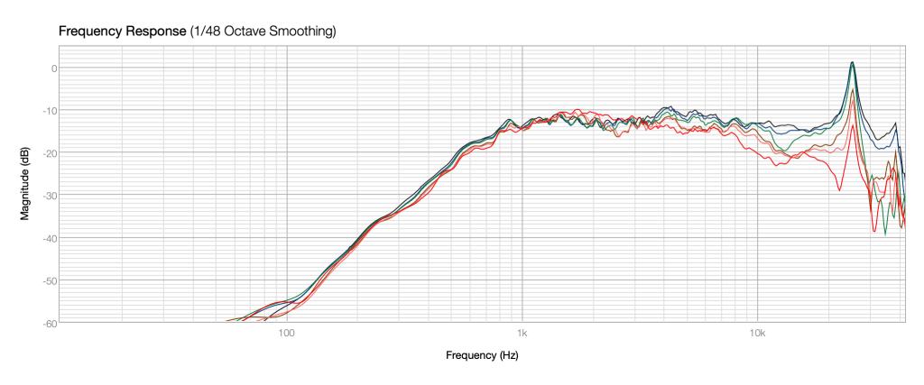

                                          And now the woofer calculated behavior:
Name:	Obi-Wan Woofer Conv 19x16 baffle.jpg
Name:	Obi-Wan Woofer Conv 19x16 baffle Response.jpg

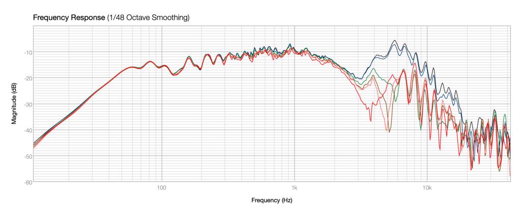

                                          Next, we'll look at what might be more optimum positions for this large baffle. BTW, large baffles are harder to work with...
                                            • 16172
                                            16" x 19" with optimization
                                            These are better optimized baffle position choices, out of looking at a LOT of positions, and small differences can have a surprising impact.
                                            For the woofer:
Name:	Obi-Wan Woofer POC 19x16 baffle.jpg
Name:	Obi-Wan Woofer Response POC 19x16 baffle.jpg
                                            And for the tweeter:
Name:	Obi-Wan Tweeter Baffle Eval 19x16 baffle.jpg
Name:	16 x 19 Tweeter Response.jpg
                                              • 16172
                                              Reviewing all of this, when I build a custom enclosure, I'm inclined to go with the 12" x 16" rectangular front panel, with an overall depth of 18-20", for a 40L working enclosure volume. Perhaps up to 24" deep.
                                              Probably layered bamboo board for the front (two layers) and 18mm BB ply for everything else- it's becoming a little more available lately from Woodcraft, including the big local store in Boise.
                                              But for now, the 1 cu ft enclosure at 14" x 14" baffle can model very closely on baffle behavior, so that little guy may be my first crossover and general test cab. I've got a couple of these on hand, were earmarked for Epique and PuriFi metal cone tests, but what the heck... love the one you're with.
                                              Next will be fabricating a 24" x 24" test baffle for some tweeter checks...

                                                So, the RSS265PR was selected...
                                                All the Passive Radiator Box design windows show an Sdp of 466 cm^2 but the copy of the RSS265PR spec sheet I downloaded today shows 356 cm^2.
                                                Am I missing something?
                                                • augerpro
                                                  • 1871
                                                  Wouldn't these RS225 be a good candidate for your 3rd order, sealed box with woofer capacitor designs? I've been curious about using that with the RS225 in a 3-way I'm working on.
                                                  ~Brandon 8O
                                                  DriverVault
                                                  Soma Sonus
                                                    • 16172
                                                    It could be, but that wouldn't help the actual LF output- just alter the tuning. Also, that works best with drivers with relatively high Qts- the RS225 doesn't fit that. It's something I could probably work up a model for, just for fun- when more spare time is available!
                                                      • 16172
                                                      No, you're not- thanks for the catch! I was plugging in a different woofer to an existing file, and I didn't catch this issue!
                                                      I'll have updated designs (with either RSS265PR or RSS315PR by tomorrow morning! I've got some of those packed away, but probably at the back of one of the storage units- easier just to order a couple more tomorrow!
                                                        • 16172
                                                        Enclosure calculations and graphs are all updated. PE shows RSS315PR should be back in stock around the end of the month. I ordered their last 12" Wavecor PR just to have something to play with.
                                                          • 1044
                                                          [ATTACH=CONFIG]31819[/ATTACH]
                                                          [ATTACH=CONFIG]31820[/ATTACH]
                                                          [ATTACH=CONFIG]31821[/ATTACH]
                                                          [ATTACH=CONFIG]31822[/ATTACH]

                                                            • 1577

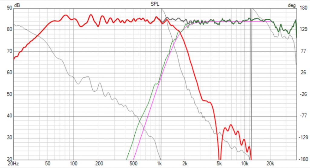

                                                            So I'm learning a few things about BSC here, but how is the off-axis response going to be affected/handled with an extra wide baffle and offset drivers? You've already shown how on-axis modeling shows an...uneven...response.
                                                            Attachments on that post are also invalid for me now (Chrome), though they were fine yesterday.
                                                              • 16172
                                                              Originally posted by Bear
                                                              The attachments are coming out invalid on my end. :cry:
                                                              It would be fun to see a Wavecor Ardent with the BD03 (8 ohm) woofers, but I know a) that I will get force choked by ET, and b) that is what the "Y" in DIY stands for. (I have seriously contemplated building the Ardent D 'rough draft' though. Good thing that there are other things to distract me...)
                                                              Looked OK this morning, but now that one is messed up for me, too. I'll fix it tomorrow morning...
                                                                • 16172
                                                                I think there is something going on with the forum- I had to redo a couple of them this morning to get them to come out right after reloading the page. They're bad for me now, too. Will completely reload that post in the AM.
                                                                  • 16172
                                                                  Go take a closer look at The Edge. Mic position, distance of the microphone test position, edge point density for calculations are all variable. I set this to 3M for these analysis because that's a reasonable distance for a speaker of this type and size. Moving the mic away from the center and anywhere in front of the enclosure border makes little difference if at a "normal" listening distance. Moving the driver is what makes a difference, sometimes a surprising difference. Go download it and get a few hours on it. go model some typical speakers, and see why baffle step is not as simple as some would have you believe.
                                                                  Mind you, those ripples for unoptimized baffle positions are only a few dB. But we are talking perfectionist...
                                                                  The "funny" driver positioning might not be liked by some, just like all the posts I saw on DIY Audio criticizing the appearance of the surrounds of the PuriFi drivers... non of those guys were measuring the differences in IM or other artifacts from surround resonance.
                                                                  Baffle step looks and models like diffraction as you go higher in frequency, and this is one of the few tools, actually the only tool I've found that can do this reasonably well. But Tolvan quit developing a while ago (business model not very robust I suppose). He developed a number of design programs, some of them don't have the easiest to follow user interfaces- his speaker development program will never pull me away from VituixCAD, for example!
                                                                  But how many users will do the detailed measurements and have a reference driver of sufficient flatness and extension that they could measure these characteristics accurately?
                                                                  Yes, few realize the impact of the baffle shape and driver location. that was one of the points I was trying to get across in a different way in the Speaker Design three part article for the M8a project, (48MB). Just sent a copy of that to Dhar via messages. He found it useful.

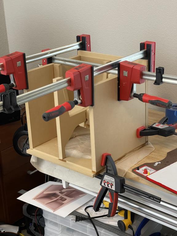

                                                                        • 16172

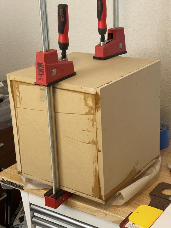

                                                                        Front Panel drawing and routing
                                                                        Things are moving along, the test cabinet panels are all glued up.
                                                                        Unfortunately, it's a brick 15 degrees outside, so working in the garage is going to be a bit chilly- but I've cheated and kept the routers indoors so they'll be nice and warm...
                                                                        The walls are insulated (I believe; they are in the same floor plan we're having built in Middleton) but the garage doors are not in this rental house.
Name:	1cuFt FP Drawing SS.jpg
                                                                        The layout drawing reflects the front baffle layouts developed by "The Edge"; assuming all goes well, I'll build a second cabinet but with the layout mirror imaged...
                                                                        It's definitely "snug", and to nail the tweeter location will require truncation of the front plate. A DA25 would not fit in this version of the design.
                                                                        The predicted woofer response profile on this baffle doesn't quite match my "preferred" baffle size of 12" x 16", but it comes pretty close- good enough for starting crossover development after I get measurements.

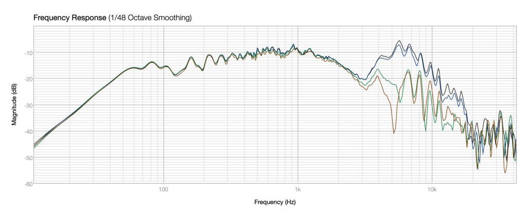

                                                                          • 16172

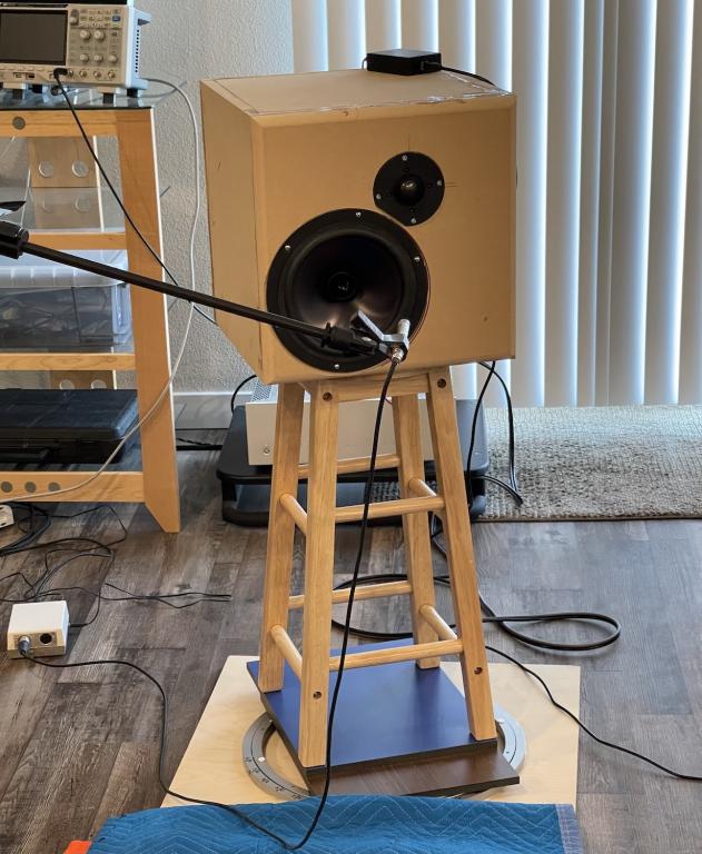

                                                                          initial test data from 1 cu ft POC enclosure
                                                                          The "Proof Of Concept" test box has been completed, and some basic driver tests finished- enough to start a crossover design proposal soon.
Name:	1cuFt Testing.jpg
                                                                          These cabinets are expected to be mirror imaged if/when a stereo pair is built (probably just for the 12 X 16" rectangular baffle, and 1.5 cu ft volume, net).

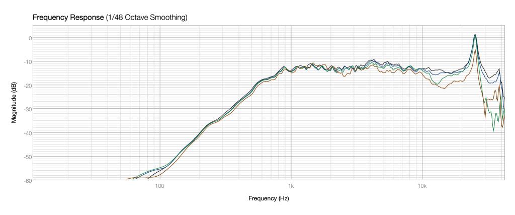

                                                                          Measurements were taken for polar response on both sides of the horizontal centers, and were surprisingly good even on the "off" axis, but I'm just going to show for now for the design intention. In modeling for the crossover, I may use from 30 degrees on the outside to 50 degrees on the inside.

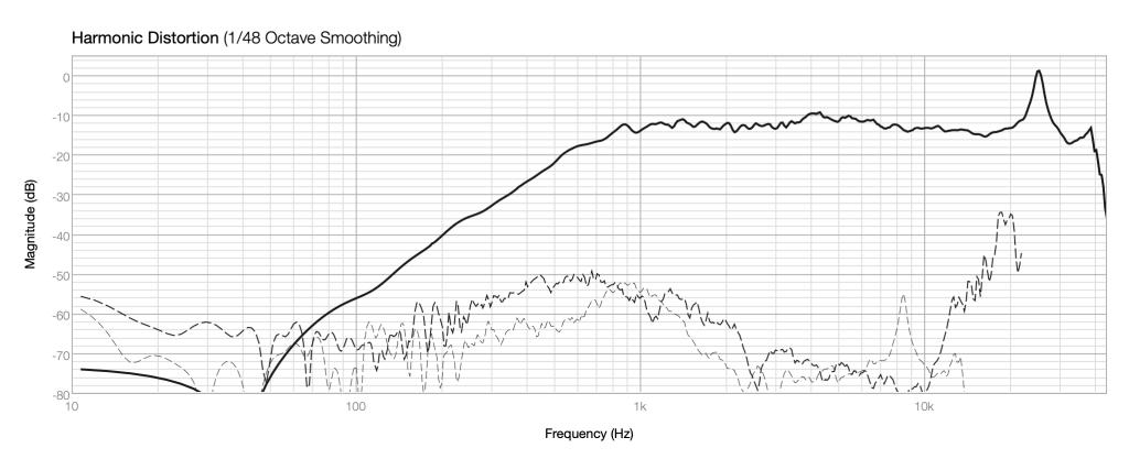

                                                                          On axis for the test tweeter, with distortion:
Name:	MB Quart Disto 0 deg.jpg
                                                                          (experience with the DA25 and some other parts shows that with the breakup mode notch filter in place, most of the resonance mode amplification of distortion products will not appear).
                                                                          Zero to 30 degree polar:
Name:	MB Quart Polar 0-30.jpg
                                                                          And zero to 50 degree:
Name:	MB Quart Polar 0-50.jpg

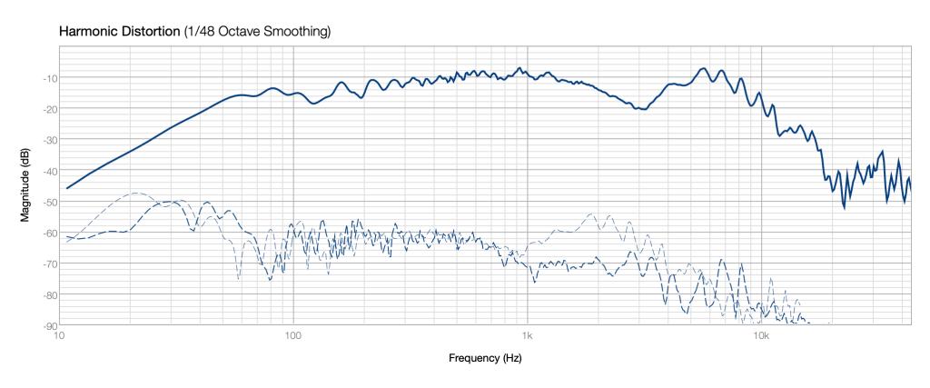

                                                                            • 16172
                                                                            RS225-4 graphs
                                                                            And looking at the RS225-4, things turn out pretty much as expected:
Name:	RS225-4 Disto 1cu ft.jpg
                                                                            Polar is shown for 0-30 degrees...
Name:	RS225-4 Polar 0-30 deg.jpg
                                                                            And for 0 to 50 degrees... this is a very good level of performance for an 8" driver- pretty much class leading.
                                                                            For reference, the -10 dB graph level corresponds to 90 dB SPL at 1M.
Name:	RS225-4 Polar 0-50 deg.jpg

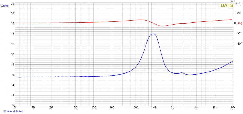

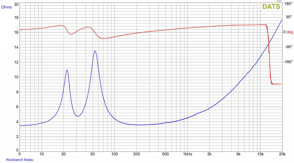

                                                                              • 16172
                                                                              impedance plots
                                                                              Impedance plots and data were also recorded...
                                                                              note, that due to delayed availability of the RSS315PR, a Wavecor 12" PR tuned as close as possible with it's weight set was employed; pretty much nailed the modeled FB.
                                                                              The RSS315PR are expected back in stock very soon, and I have some backordered for now.
                                                                              The tweeter impedance is shown here, and I like that the Fs resonance is very symmetrical and easy to create a Zobel network for.

                                                                              A reminder, for this 1 cu ft nominal enclosure design, the predicted SPL for the RSS315PR is:
                                                                              From the impedance and distortion data I think taking this down to 1700-1800 Hz with a fast roll off network should be workable. But the devil is in the details; I also want to use a Quasi-series network with this design study, as used in the Modula MT and Natalie P. Most likely the ultimate slopes will look like an LR6, if something like that existed in the normal literature.
                                                                              I probably will not build two at this size, but because the baffle step behavior modeled for this front panel design and for the 12" x 16" design are so similar, it may be feasible to use basically the same crossover network.

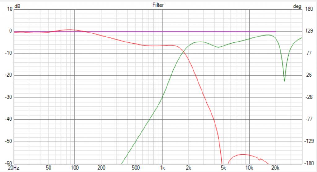

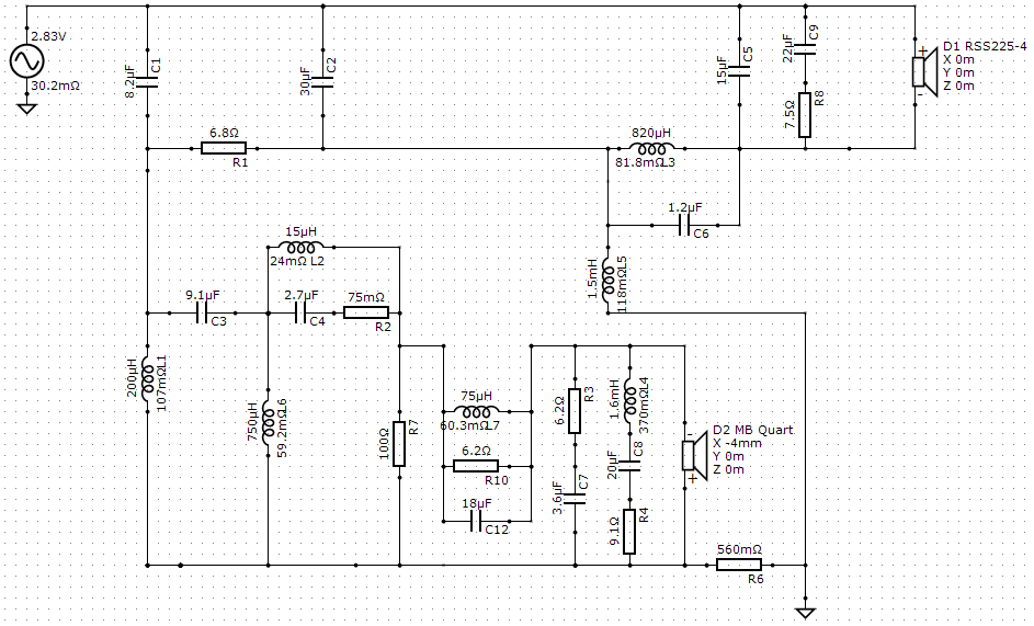

                                                                                    I've finished an initial design pass for the crossover, and though it's a bit more complicated than I'd prefer, it also offers the basis for some options like a presence range control, due to the EQ filter necessary to fix a bump in the tweeter's response centered at 4kHz.
                                                                                    In some ways, I'll grant this project is somewhat quixotic, but that actually makes it somewhat more fun in some ways... combining a titanium tweeter than can trace its lineage back to early Avalon products, with one of the earliest aluminum cone drivers from PE is definitely a retrospective effort. Partly, I'm just curious to see if some careful design work will make this an interesting project in the 1.5 cu ft version with the optimum front panel.
Name:	Obi-Wan POC TA-5 XO-schema-1.png
Name:	Obi-Wan POC TA-5 SPL.jpg
Name:	Obi-Wan POC TA-5 Filter.jpg
                                                                                      • 1577
                                                                                      Yep, that look like a patented Jon Marsh-style crossover! Can it be built under $100 as well...not through PE, I think. Maybe if one were to wind their own inductors?
                                                                                      Which specific tweeter is that? I get a couple titanium versions with my Google-Fu this morning. Granted, I have not caffeinated yet.
                                                                                        • 16172
                                                                                        It's the PE MB Quart buyout, no worries about running out, they have over 300 in stock.
                                                                                        I used my own coil winder for years, but left that behind at Twaale's.
                                                                                        No reason we can't propose a budget and perfectionist version of the crossover. Thing is, once you've spent the time building the cabinet and everything, some places don't make sense to cut corners. I view keeping the basic driver cost low is providing leverage for spending on other stuff as you choose- for example, my full build set will almost certainly use a double layer LBL front panel, and the rest out of BB ply. Building this test box reminds me once again of what I don't like about MDF.
                                                                                        with a 12"x16" front baffle, the interior depth will need to be 19"-20". Plenty of length for those needing to use a port on a budget. And still reminiscent of the 3030i.
                                                                                        PS, I rarely work without caffeination... its just not productive!
