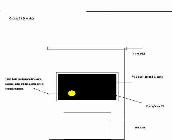

    I asked for and gave them the figures to frame out for my plasma, which after sheet rock SHOULD have left me 2.5 inches all the way around the plasma. They got the depth right but not the width and height! So now I am left with 7/8 all the way around the plasma. Not really to big of a deal except for the wife wanted it the other way, and cooling is now going to be even harder.
    To make matters worse they put my cooling ductwork at the BOTTOM left of the frame out. (Heat rises... was told to place it top center!) I am thinking that the 1 fan and all the other factors might make this not work as far as cooling is concerned.
    I was thinking of drilling (4) 2.5-inch holes from the top of the fireplace area. (Behind the crown on top) to the plasma frame out area. This would give me 4 vents that the heat could just rise out the holes to the top, and into the rest of the living room. That combined with the cooling fan and the 4-inch duct should be enough to make it work.
    Any ideas? Thoughts?
    I am attaching a drawing that I made to try and show what I am talking about. I will attach some pictures of the house on Thurs when I go and take them.
    Thanks in advance!

              I have done installations with 2 inches all the way around, but this the first one that is so tight, and with the vent being at the bottom left I wanted to make sure that it was not going to be a problem.

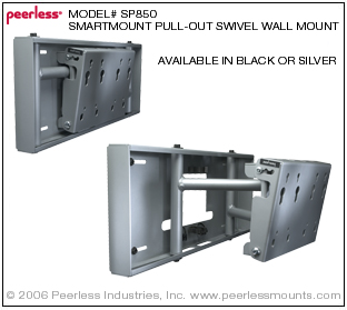

              The TV that I have slated for the slot is the LG 50PC1DRA. I am now going to use the Peerless mount that allows me to pull the TV in and out of the slot. (Attached is the mount).
              The depth of the slot is 9 inch. The TV is only 4.5 inch, the mount is another 2.5. That will allow me to tilt the TV down a bit and still not come out further than the wall.

                you should be ok bro, heat will still escape even from a 7/8" opening, if you were installing it behind glass or something that completely encloses it, then I would have a concern. you can always pull the tv away from the wall a little when your watching and just push it back in when your not.

                  Thanks guys... I just talked to the builder yesterday, and he is also going to pop 6 2.5 inch vent holes in the top so that I can get some extra venting as well! You will not see the holes as the plasma will be covering the view of them. So with the 7/8 around the sides, and the vent fan/ and vent holes in the top I should be ok.
