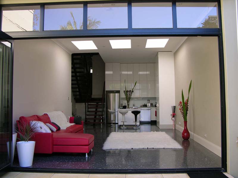

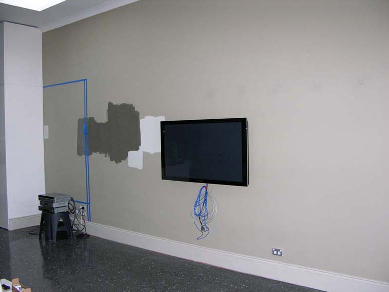

    We have added pictures of our room to give you an idea of what we are trying to achieve. As you can see, although the room is relatively long, its not that wide (approx 10mts long, 4.6mts wide and 4.1mts high). If we go with bookshelves and stands will the room be over-cluttered?

        I know your right - we just wanted to try and squeeze in those 705's Our room is not that wide so looking like in wall it will be, especially given that we want to customise some sort of bench under that wall.

              Your setup seems well-suited for wall-mounted speakers. You already have a plasma screen that only sticks out 2-3 inches into the room, so you probably don't want your speakers to fill up a lot of space. As Thomas alluded to, you're better off with in-walls designed for that application than box speakers set too close to the wall.
              As an experiment, take a couple of cardboard boxes and drop them 2 to 3 feet out from the wall (where box speakers should go) - live with them for a day or two and see if you're tripping over them.
              I think putting 7 speakers in that space would be squeezing in more speakers than are necessary - I really doubt there'd be any benefit at all and would stick to 5.1 in your case. Most of the reviews and comments you'll read on the net indicate a marginal preference for 7.1 in very large rooms but no difference in average to smaller rooms. Go to Dolby's website and look at speaker layout suggestions - all the 7.1 layouts have 2 rear speakers in the room well behind the listener ...

                I also agree that free standing speakers are always the better alternative for SQ but only if you can position them properly AWAY from walls. In this case, unless you don't mind them out in the room or already plan to say add a table or equipment cabinet under the display wich you could put the speakers beside and slightly infront of they'd be less of a problem.
                Otherwise, you'll likely get better SQ with speakers specifically designed to be on/near walls.

                  Beautiful room BTW...
