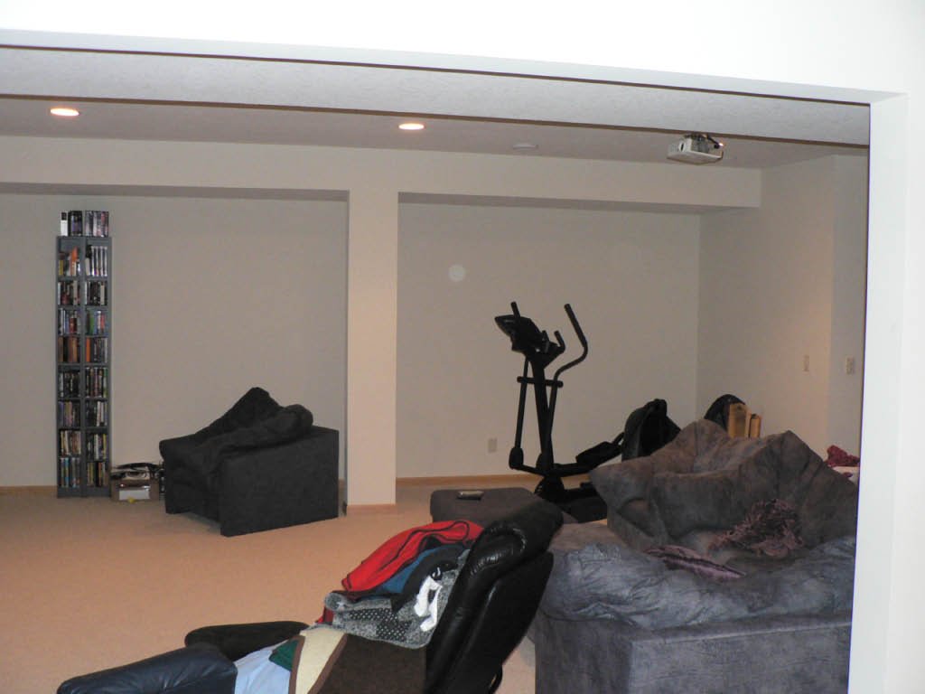

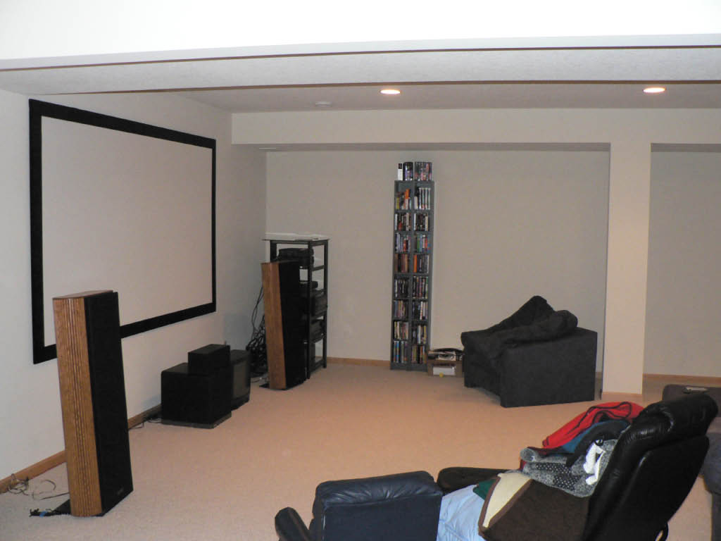

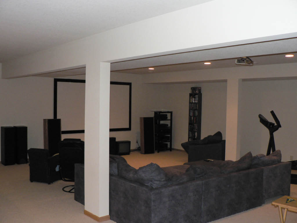

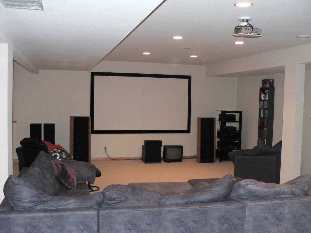

    1. The area that I will be enclosing will use 2 exisiting foundation walls (which are currently sheetrocked - pictures attached). I will use a center support beam, which runs the entire lenght of the basement as a natural divider to create a theatre space and a play space for the kids. The dimensions I end up with are 18'W x 22.5'L x 8.5' H. I am thinking this should be enough space for 2 rows of 4 seats - seating positions at 13.5' and a rear at 18.5' on an 8" riser. My question is with regard to the length and width. Are these dimensions too close to the square box = really bad acoustics or am I ok. An option I have would be to make the room narrower by a couple of feet but this would create a long dead space on the foundation wall side (some of this I would use for an equipment rack that I can vent into a utility room). Or am I better off keeping the larger space and treating any acoustical problems after the fact.
