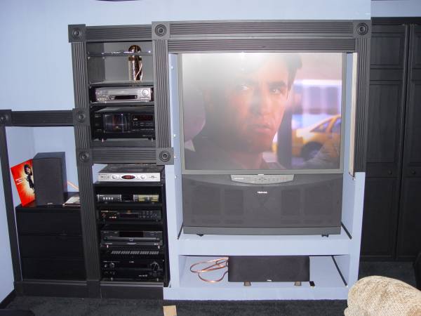

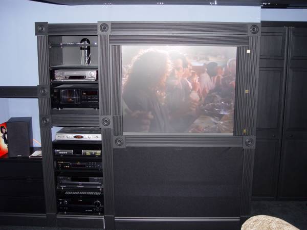

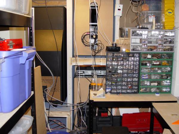

        • Joz0234
          Don, I did the same thing you are talking about in my basement. The only difference is I have a small room behind my wall and have easy access to all my equipment. I've included a few photos as attachments-I hope!! Good Luck!
