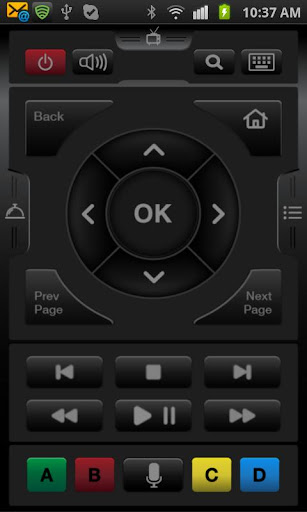

    Looks like this might be an option (albeit pay)...
    Doesn't look quite as "slick" as the Peel GUI but appears to be more powerful and customize-able for device control. I'd certainly be willing to sacrifice some slickness for better overall usability...
    I may try Peel to see what it can/can't do and then look in to this more if I find Peel lacking.
    FWIW Touchsquid also has a free demo version to download and try:
    It also appears to be able to control my WDTV media streamer which Peel does not and would require switching to the secondary WDTV remote app to be able to control it as well.

              Touchsquid (TS) seems to be the only REAL solution utilizing the existing IR blaster that's really a fully functioning universal remote it seems. On a positive note, they appear to also support my WDTV streamer and I've got an email in to them on it's lighting control capabilities. I'm hoping that TS can utilize the existing wireless and control say wireless IP based lighting control as well and not be limited to just IR in that regard.

                          Some other good news regarding TS that I got while corresponding with them is that as they work towards implementing IP control (for things like Insteon) they have a temporary work around as well:
                          This is not the complete rewrite version we are working on but it has a GREAT NEW feature.
                          You can now launch any other Android App from within the TS app, and when you close it with the back button, you will be right back where you left off.
                          This is great if you have a favorite TV guide, or maybe you use XBMC or Dune and want to control it with IP.
                          You access it like this:
                          To start an app from a button in the activity screen:
                          Squid Eye/Advanced/customize buttons as usual.
                          Select the first device on the list. In the command list you will find a new commands "RUN APP". select this, and a list of installed apps will come up. It is always a long list and some of the names are not obvious.
                          Name the button and save changes. Try it out!
                          On the PRO version a similar procedure can be done on a favorites button so you could make a page of favorite apps.
                          Don't launch the Touchsquid remote app this way! Small apps are probably best.

                                                      Finally got the tablet! Installed the demo version of TouchSquid last night but only had about 15 minutes to fiddle with it. Got all my equipment in to the software but I'll have to tweak it to get it seamlessly switching between sources etc. Once I get a better understanding of the software I'll likely spring for the Pro Samsung version to allow for more equipment, macros etc.
                                                      So far it seems pretty user friendly and intuitive though :T
