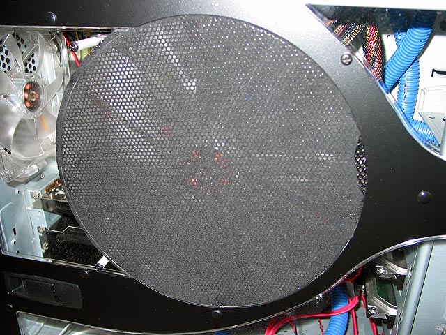

              If you can, taking a pair of panty-hose and cut them out. Stretch and cover the fans or where it sucks in air then secure it with a little hot glue, makes a huge difference. I put it on all my fans and I only have to clean out the PC about once every 2 years and there's not much on it, just keep the "screens" clean.
              I prefer black hose if you're going to do it so you don't really see it as much.
              It came out lighter in the picture, but it's almost as black as the case itself and you can see where I didn't glue it and it's pulling back from moving to the new house. All I have to do is loosen the fan and stretch it back out.
