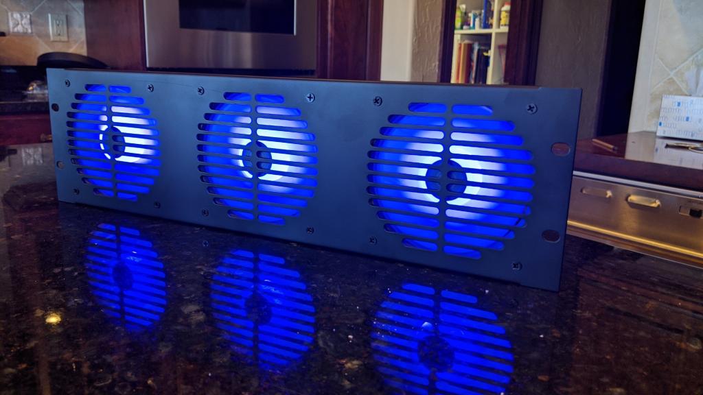

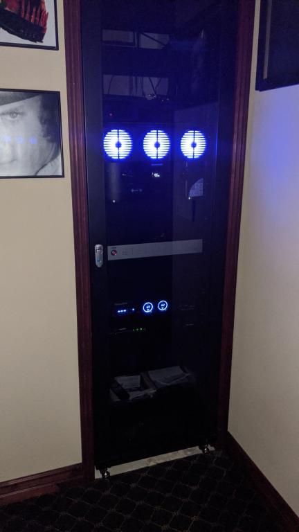

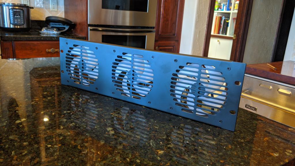

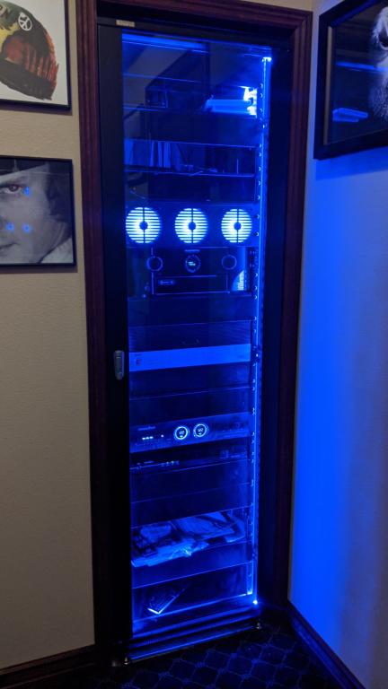

          Here's the outcome. Again, thanks for the help. My wal-wart is a switched supply. I just happen to have a bunch of them that I saved over the years.

            Cool, it woiks! Does it keep the cabinet cool?
            Do the blue LEDs distract you while watching TV/movies? I find blue LEDs too bright and hard on the eyes. I prefer red, or no lighting at all. But then I'm an old phart. :fart:

              No you don't notice them at all since the rack is in a separate room. :wink: The rack has built in fans at the top and they're super loud so they may get replaced. You can't hear them in the theater anyway unless you open the door. I have a build thread on AVSForum. https://www.avsforum.com/forum/19-de...ter-build.html
              It does seem to help with cooling. At least the bottom of my oppo 203 isn't nearly as hot. I'll be pulling the system out soon and cleaning up some wiring in the back and putting the Adcom 7707 on the bottom. Eventually I'll upgrade the processor but no immediate plans. The only reason for the upgrade is that I'd like DIRAC.
