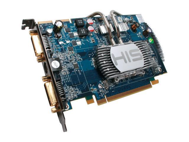

                                                            Well the Nvidia Quadro series or ATI Fire series are aimed at graphic and video editing amongst other things. But that's not to say a standard gaming type card wouldn't work well either. Geforce 9600GT the 9 series cards have really come down in price. The ATI 38XX series are very nice as well.
                                                            http://www.newegg.com/Product/Produc...82E16814195048
                                                            http://www.newegg.com/Product/Produc...82E16814500019
                                                            http://www.newegg.com/Product/Produc...82E16814161220
                                                            These are newegg links but I'm sure you can find similar products at tiger direct. This could also be something you could add later if you needed to.
