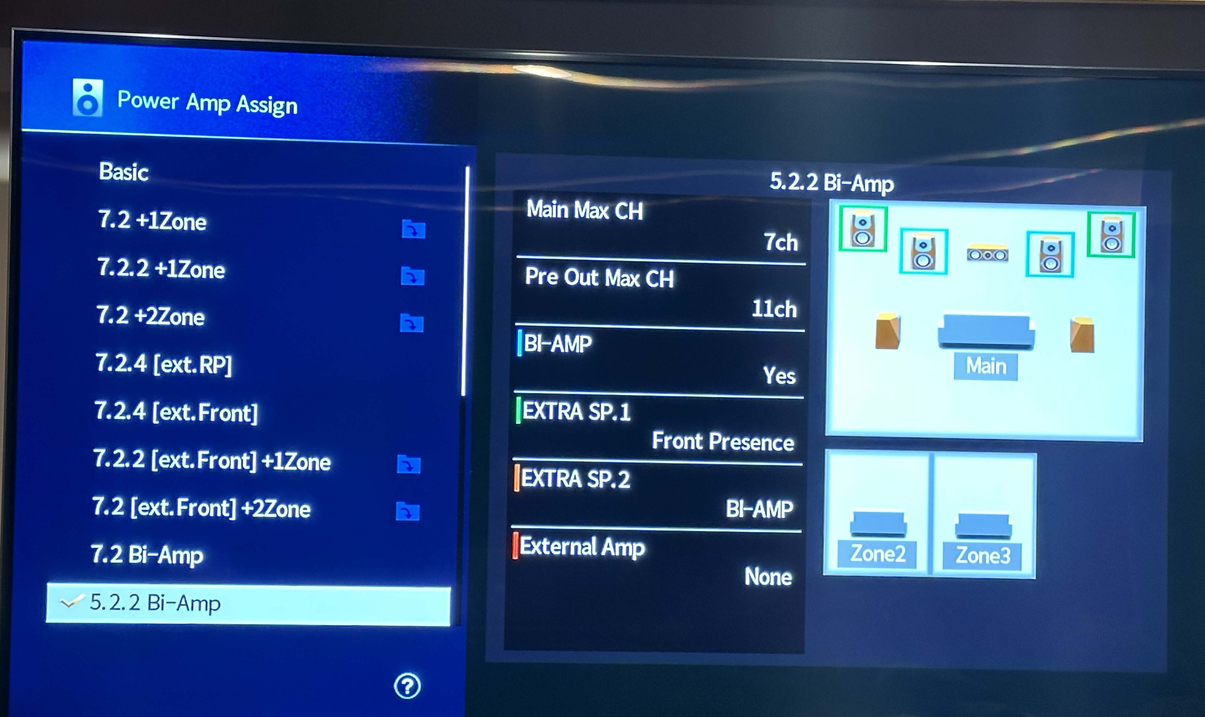

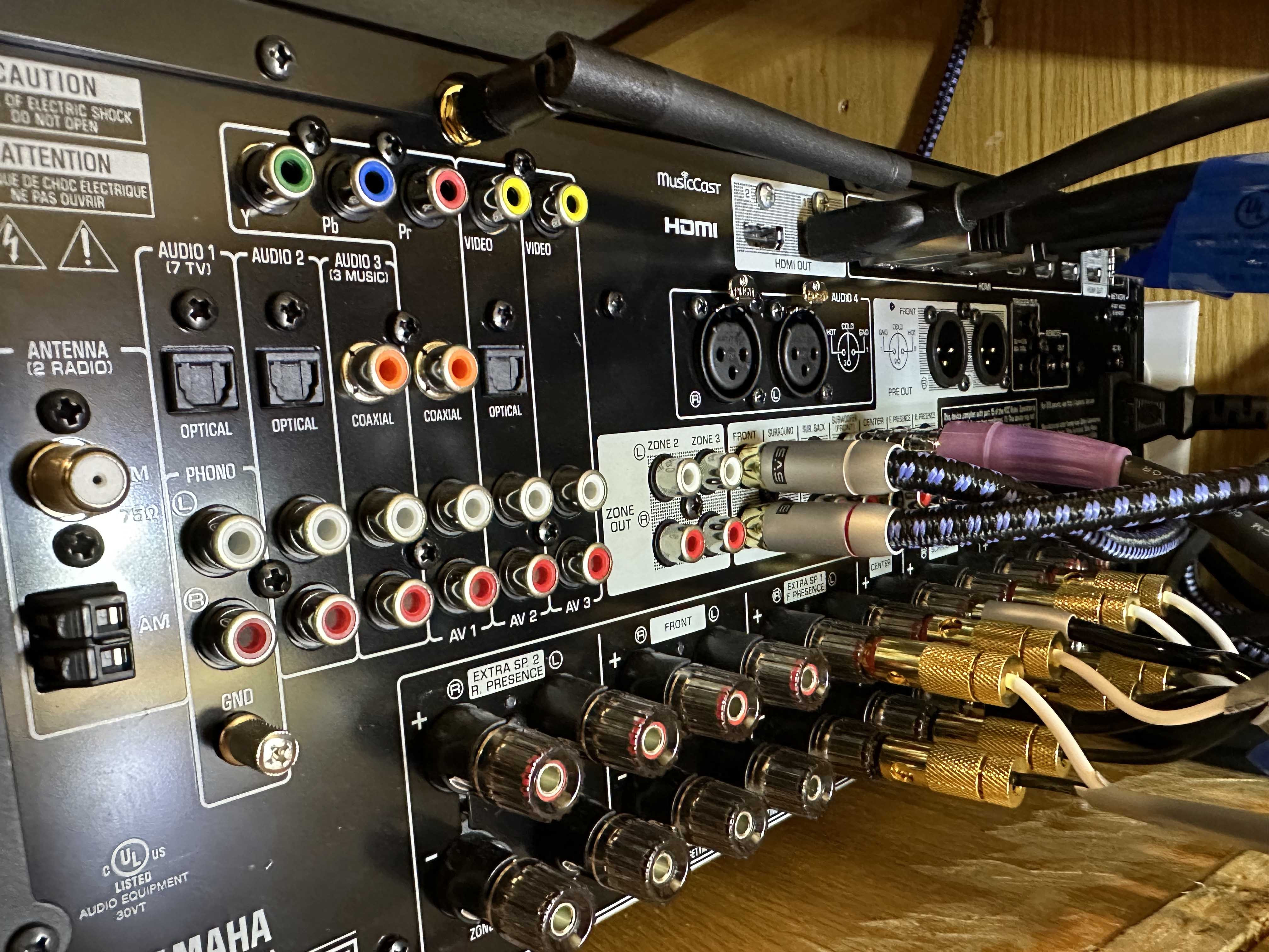

    I just connected the Rotel RB-1582 MkII to my Yamaha Aventage RX-A6A receiver. I want the Rotel to power the FL and FR speakers. I connected RCA cables from the L & R pre-outs as shown in the picture to the inputs on the Rotel and connected the speakers to the Rotel. I also changed the settings in the receiver trying all the settings including Basic and nothing works.
    What am I doing wrong???​

    I'd put the settings back to where they were before you hooked up the rotel. It should work then. Dumb question but what does the manual state for settings?

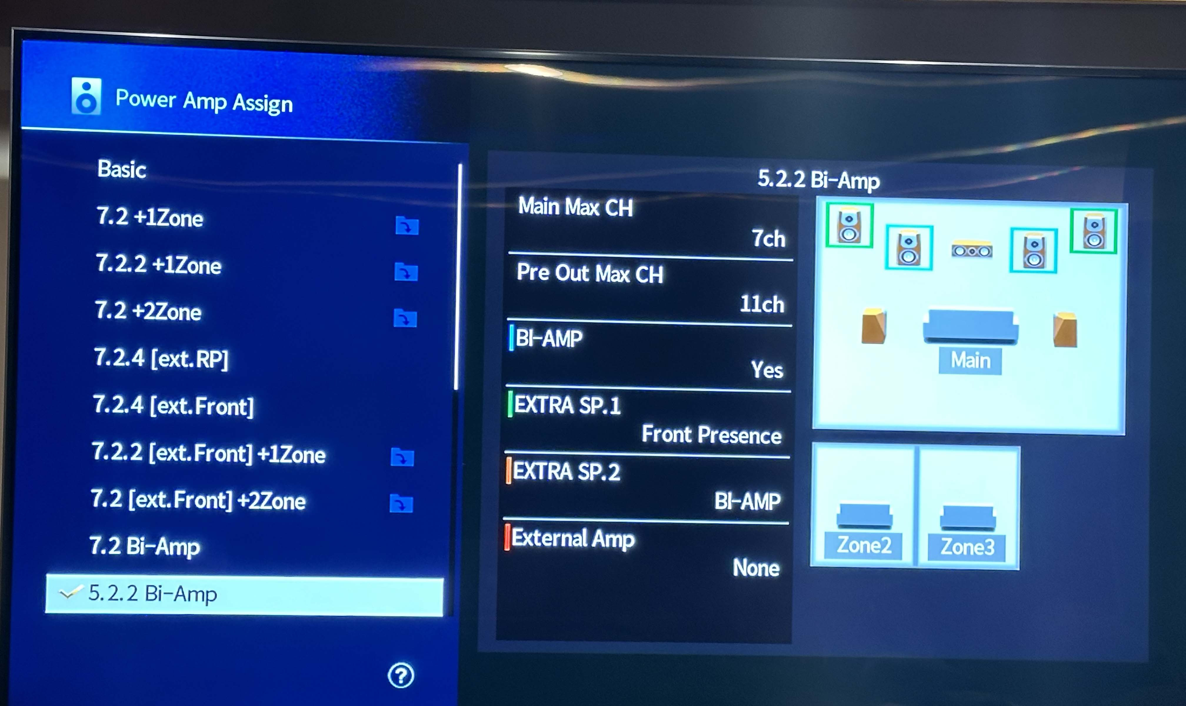

        I've tried everything. I started with the basic setting and switched to every other one with no sound. The manual for the Yamaha is a bit unclear but from what I understand and what others have suggested is switching to 7.2.4 for Bi-Amp. Again, no sound on any setting.

          Update. Got it working. The problem was the trigger switch was switched to ON. Switched it to OFF and it is now working.
