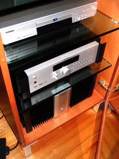

    Hi guys,
    I have had a custom made AV rack for my Rotel gear (see images). I have noticed that the 1066 gets quite warm - moreso than the RMB1075. When I had all my equipment on the floor I recall that the amp would get a bit warm but honestly can't recall how hot the 1066 would get.
    What experience have others had?

    I would switch and put the 1066 on top of the rack for better heat dissipation.

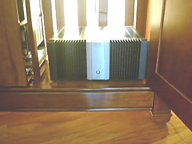

      I have the same experience. My RSP1066 gets a lot warmer than my RMB1066. I have the amp in a shelf that's not much wider or higher than the amp itself, but it never gets warm to the touch. The RSP1066 on the other hand had to be placed on top of my rack, open air all around (except bottom of course).

        Thanks guys.
        I forgot to mention that it overheats even with the door ajar by 45degrees.
        The back holes aren't all that large.
        What do you think if remove the glass shelve above the rsp1066 which will effectively double the space it has currently available.

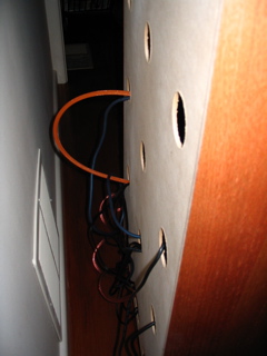

            I am not sure what you mean. It would be pointless to put holes on the top and bottom as it would destroy the furniture piece. I moved the glass shelving above the 1066 and it has made some improvement.
            When you stick your head in the cabinet it feels that the air isn't moving so my next step is to create bigger openings in the backing.http://www.htguide.com/forum/images/attach/jpg.gif

                The warm air will alwayes try to get out into cold air - and the longer you have between the air intake and outlet the more the air movement will accelerate and thereby create a pull effect that will increase the air flow.
                The photo of your back of the rack shows many smaller holes all over that courses the air to have to many places it can come out of without any sucktion effect - so cover the ones in the middle and only have holes at the bottom and the top.
                Please ensure that the holes are large enough though so that you dont create the opposite effect and have a sauna..
                Hopes it makes it a bit clearer..
                PS. If it works you should be able to feel the air being pulled in at the entry holes with your hand.. But naturally only when the equipment if getting warm, so not from the point you turn it on..

                  Thanks Azeke. That vent on the wall used to be the old central heating - so it is currently blocked. Probably another problem may be that even though hot air rises it strikes the glass. Now if the glass didn't reach all the way to the back of the cabinet it wouldn't be an issue - but it doesn't. I would guess that this results in air not moving - what do you think Azeke?
                  Aarsoe -it does make sense. Unfortunately there are no intake holes as the front of the cabinet is a glass/wooden door. I keep this ajar while using my HT. What I had planned to do was increase the openings at the back of the shelf where the 1066 is. Currently there are the 3 holes which are 5cm in diameter as you can see in photo (the hole where the red/orange cable is enetering is where the 1066 is).

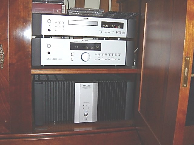

                    My system is also inside cherry furniture. The back is quick open, allowing easy natural ventilation and easy cable assembly. While RMB-1075 only gets warm, the RSP-0166 unit normally gets very hot. This is really a characteristic of RSP-1066, after a 1 hour of continuous working, I only hope that such a high working temperature does not stress too much components inside.
