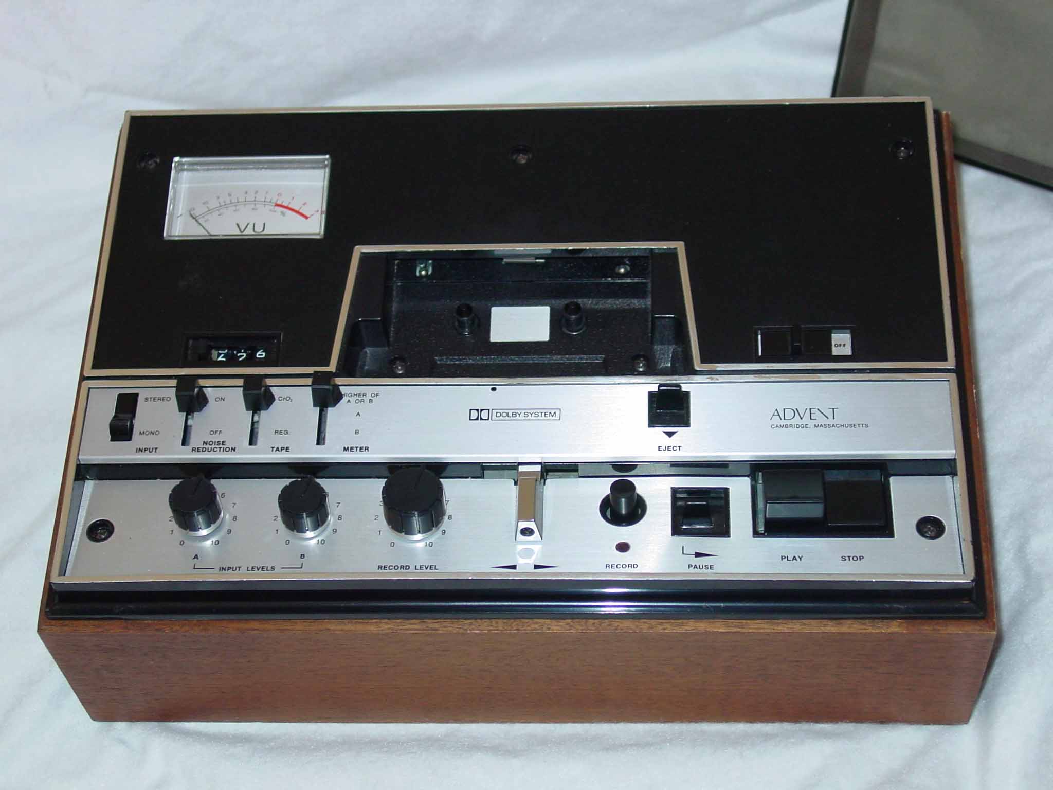

    my system in '94 was the rb-980bx 100 watt, Advent 300 pre, Advent 201A cassette deck, a Sony Discman and Signet speakers.
    the Signets now serve serve rear surround duty, but the 980 did well at powering my Natalie Portman's for years after.
    loved that amp, it was bullet-proof & sounded good.
    the 981 is slightly different topography, however i can not offer opinions on the sound signature compared to the the 980 as i have never heard one.
    i still have a 990, a 1050, & my main amp is a modified 1090.
    my gut feeling based on my experience with these & many other Rotel amps tells me the 981 is likely just ever so slightly better than the 980.
    but, imho, condition will have the greatest influence on amps as old as these models are.
