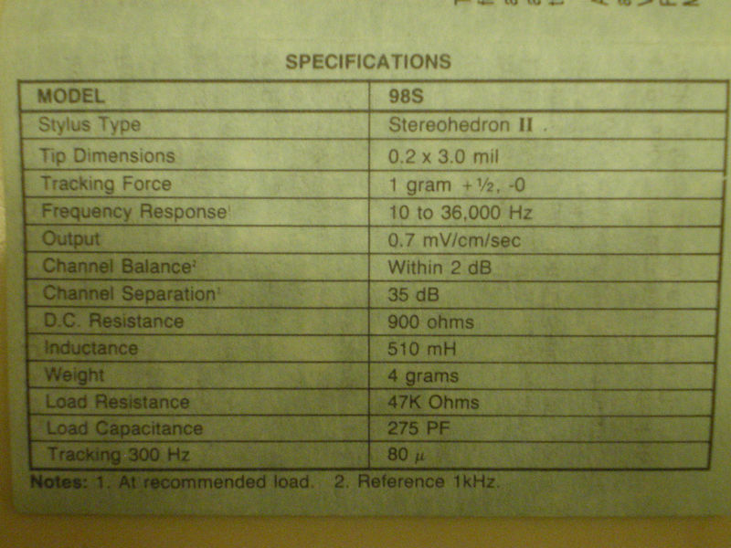

    Recently acquired a near mint yamaha yp-d6 turntable. I'm new to vinyl and would like any recommendations on a good entry level phono preamp. It has a stanton epoch ii cartridge on it which I believe is mm but just to be safe I was thinking I should buy a preamp with mm & mc capabilities. Thanks in advance for any assistance. I have our old Christmas records that I'd like to play and the Bruce Springsteen box set on vinyl. Who knows where it will go from there...

            These were very nice for the money when I got mine (several years ago). Since my speakers are prone to "edginess" the tube/vinyl combo worked well for me. YMMV. I would get the stylus checked out on a cartridge of that vintage before using it , also. They were very good cartridges in their day , but that was about 25 years ago. Should still sound very good if it's in good shape. Nice find!
            Some set-up info for an Epoch II:
            They are indeed MM , but there were two types. The LZxx were low output and the HZxx series were high output. Now , about cleaning those albums before the stylus hits them....LOL. Welcome to Vinyl. :T
