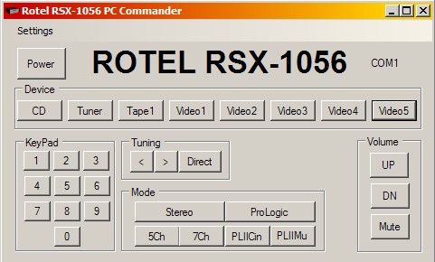

    I spent some effort to rough out a quick framework for a test applet in VB.NET. In its current state, its setup for the HEX codes for the RSX1056 (since that is the unit I have), it wouldn't take too much more effort to have it set up so that the HEX codes could be read from an INI file, or for that matter making a special one for each unit (shrug).
    I think the better application of an app like this would be to have it reside in the background on the HTPC, and the actual applet (similar in fashion to this test applet) would/could be on any other PC/Laptop in the house, and would send control data to the HTPC... giving "virtual" control from "virtually" anywhere on the premisis.
    At the time of typing this posting, I have NOT looked into amy similarity (or lack of) between HEX codes of differing units, so I don't know if this will do anyone else any good, who may not have a RSX1056. It's FREE to try and find out.. Soo.....
    Hope someone gets a kick out of it! ;-)

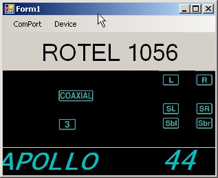

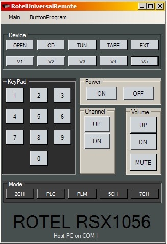

        PS - added a snapshot of the current state of the similar "Look" of the "VIRTUAL Universal Remote"
        EDIT
        Having a LIST of the Device ID's and ability to calculate the Checksum would make it EASY to just have all the ROTEL Devices on a pull-down menu!

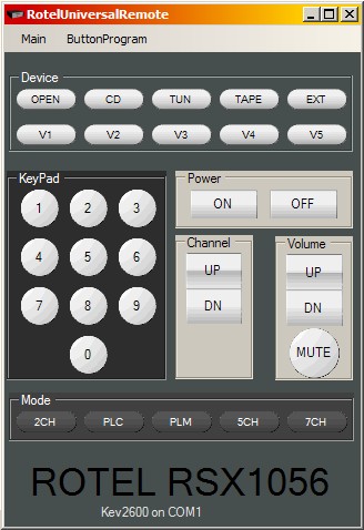

            Functionally, at first glance this would not appear to be any, to much different at all from the first little prototype applet I first posted in this thread, as the now COMPLETELY, 100% "Programmable" buttons on this "VIRTUAL Universal Remote" are keyed in as the values for an RSX1056.
            "BUT", as one can see (if one actually DL's this and plays with it), the NAME, HEX CODE and ToolTip associated with each button is completely programmable by the PullDown menu. Thats all well and good until you shut it down, as it will only go back to the "SOFT" coded defaults programmed into it. This is now just a stones' throw away from being able to store the custom key programming, AND is framed out to be a client to a SERVICE on the "HostPC" to the Rotel Device.... ANY HEX CODE, to ANY ComPort, on ANY PC, to any ROTEL Device....

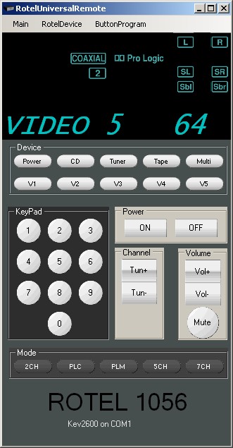

                OK, in many thanks to Kevin D.'s input/post....
                The "VIRTUAL Universal Remote" will now automatically program itself for ANY of the Computer controllable Rotel Devices (1055, 1056, 1057, 1058, 1065, 1066, 1067, 1068, 1069, 1098, 1550, 1560, 1570) and AUTOMATICALLY "calculating" the HEX Codes. Since it can/does now calculate the HEX Codes, any Key on the VIRTUAL Remote can now be programmed by only inputing the 2 character HEX "KeyCode" in stead of having to input the entire 12 character HEX String (though if for any reason you want to, you still can). All of these capabilities also extend to the more "common" Command Sets... Primary (10), Main Zone (14), RecordSource (15) and Zone 2 (16).
                ALL of the "Standard" buttons can be automatically overlay'd by presently selected Device + Command Set, or each key can be individually programmed by the current selection, or custom.
                Still on the aggenda.... Storing and retrieving the custom configurations. And, creating the Server/Client app for the "HostPC". "AND" probably adding a few buttons to the UI.
                Thanks sir Kevin D.!

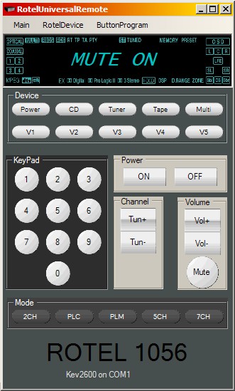

                  Well, it was a little agonizing trying to properly read the data from the unit... "BUT" I finally made it. The LARGE portion of the VIRTUAL Remote's LCD display is 100% SYNC'd with the 1056's display (100% dynamic, scrolling text on the units LCD scrolls on the VIRTUAL Remote's display). I just got done rendering the rest of the display area, and have it as a background for the LARGE display text.
                  The next step for the now SYNC'd display is to toggle MASK's over the display to correctly reflect the unit's status as would be displayed on the units LCD display. The resolution of the display image if FAR greater than the panel it is displayed in, so I'm considering going to a horizontal layout of the controller to make better use of the horizontal LCD display.

                    For readability in this current configuration, I took the liberty of deviating from the 1056's display. And the new altered display ontheVIRTUAL Remote now sync's with the Unit's display.
                    Still on the menu... 1) Saving configuration(s) (IE - "INI" files or the likes), 2) draft up the Host/Client app (have done this before in a different application, the code is at hand and should be an easy adaptation), 3) ADD buttons!(?).
                    As far as the "engine", functionality of the app, I think it is, or is going to do, everything that can be done in a "Universal" type approach to be able to control any Rotel device with a Computer I/O port. It "should" even be able to work over the Internet to your Rotel Device, if the Firewall redirects the still yet to be determined PORT between the Host/Client to the "HostPC". I think what this severly lacks is "SIZZLE"... the APPEARANCE of the UI, while it may be "functional"... it's NOT very "Sexy". Anyone out there better at the cosmetics?

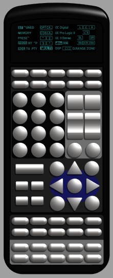

                    I've modeled up a 3D prototype of a possible VIRTUAL "Universal Remote", but when it comes to porting it over to something that makes a NICE looking graphic for the UI on this.... (sigh), I'm not so good at that.... yet... :-(
                    Thoughts?

                                        OK... An update for anyone that might be interested.
                                        In prototype type of scenario, I have established the "VIRTUAL" part of this RemoteControl project. The App. can now be on a PC anywhere on my home LAN (my PC I work at, have tested it on an IBM wireless ThinkPad, etc.). At the moment, the "Server" application that I built to run on the "HostPC" (The "HTPC" that is physically hooked to the Rotel), is about a 1/2 version of the actual Remote App. itself, it has the modified neon display for monitoring the status. AFTER I put all the work into it to hack out the full functionality of the Remote App., I questioned why I wouldnt just have the full remote on the HTPC acting as both a Server for the VIRTUAL Remotes on the LAN, AND act as a Remote on the HTPC itself.
                                        The downside of the networking I have built into this is I about 1/2 gave up on trying to self teach myself the VB.NET Network programming, and found a way to cheat the VB6 Network programming into VB.NET. As far as the functionality of the App., it makes no difference. However the VB6 Network progamming requires additional files to be installed with the program, and is not freestanding as it would be if it were all programmed in native VB.NET. The good news is, all of the architecture is in place and debugged for basica functionality, so now all I'd need do is patch in the VB.NET code.
                                        I think the actual "VIRTUALUniversalRemote" should be reconfigured to play the role of BOTH the Host/Server AND the REMOTE Client... That way if the system is set and used for REMOTE controllers AND you want to ALSO control the Rotel directly from the HostPC (HTPC), you would not have to shut down the 1/2 size "Server" app. on the Host/HTPC and start the VIRTUAL remote up.. as it would already be in up and running on the Host/HTPC.
                                        Still want to up the Eye Candy aspect, still have to program holding custom/last settings... and NEED MORE BUTTONS! :T
                                        (Attached Pic of the current rough draft of the Server App. on the Host/HTPC)
