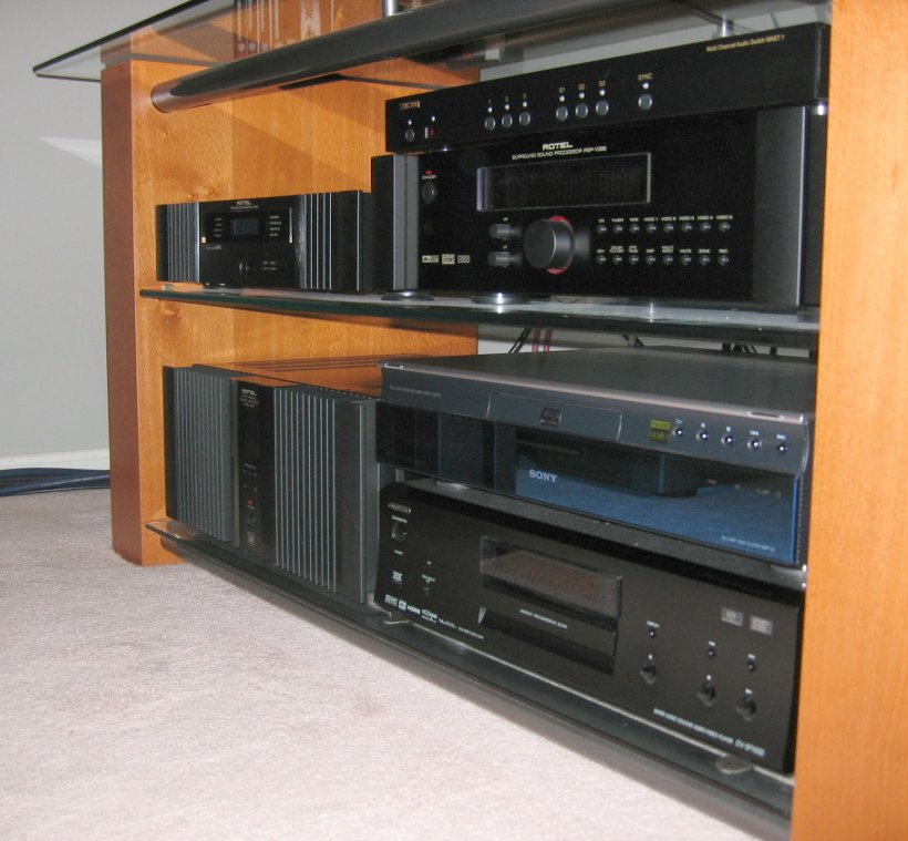

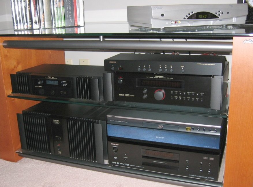

                    • Blindamood
                      • Sep 2003
                      • 900
                      As promised, here are the latest pics of my system, with the Zektor MAS7.1 installed. So far, this works perfectly. I now have all three sources using HDMI only for video, and I'm switching between the 5.1 analog outs of the Onkyo and the Sony. This allows me to get DVD-Audio/SACD music, as well as Uncompressed PCM, Dolby Digital Plus, and Dolby Digital TrueHD for blu-ray movies. With the recent Sony firmware update, I can now (finally) hear the 640 kbps DD track on my Pink Floyd 'Pulse' disc...awesome!
                      Brad
