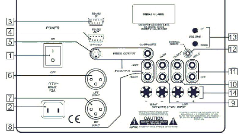

                  Well that's different! You can certainly do the same. I'm attaching a picture of the back of your sub, follow along with it:
                  1) Unplug the cables coming out of the front outputs of the 1057 going to the 1077 inputs.
                  2) Unplug the subout cable going from the 1057 to the dd15
                  3) Plug new cables into the front outputs of the 1057 and run them to the stereo inputs on the dd15 (#11 in the picture)
                  4) Plug the cables you removed in #1 into the outputs of the DD15 (#10 in the picture)
                  5) In the 1057's menu set the front speakers to LARGE and the subwoofer to NO.
                  This changes the subwoofer management duty from the 1057 to the DD15. The front speakers will be fixed at 80hz (like Prost's sub), but you should be able to set the sub crossover to a good level to blend.
                  This give's a subwoofer with EVERY mode, including bypass.
                  Kevin D.

                    :T Thanks to you both I will try this on the weekend!
