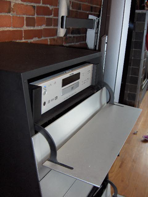

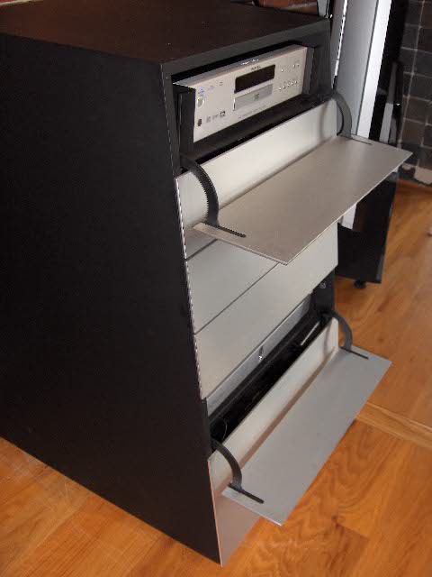

              Here is what my issue looks like. In the picture you can see that basically its an enclosed cabinet (except for the back which is open). All of the aluminum doors open like you see in the picture of the RDV 1060. The very bottom one does not open and thats where my current rsx 1055 is, and where the 1075 and 1068 would be (stacked). I can open the door right above the big botton door to let in air when im using the equipment.
              If I stack the 1068 on top of the 1075 then I will be left maybe a half inch on top. I can remove the next shelf above to give it more room, but id rather not because then i would be stuck putting my xbox 360 somewhere.
              will a fan work and be enough?
              What would you do? and no I cant afford the 1077 :roll:
