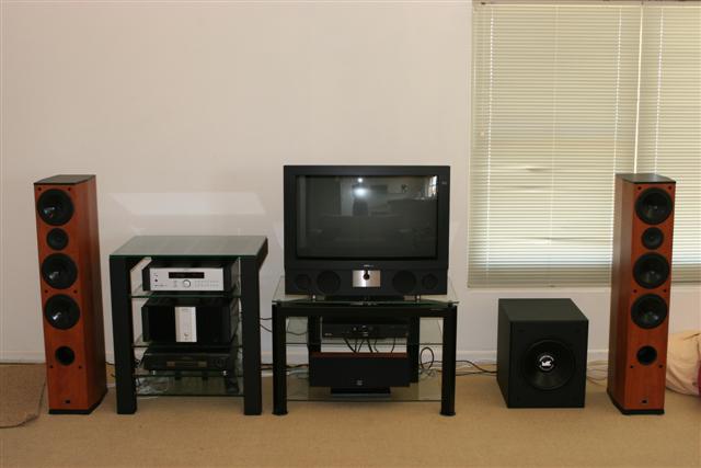

    This is my 1st HT system setup and I am needing some HELP!
    I’m setting up a 1068 & 1075
    Attached to:
    Dali Suit 3.5 FL/FR
    Dali Centre
    Dali RR/LR
    M&K V75MkII Sub
    See pic below.

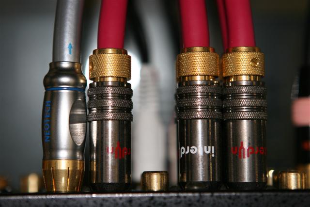

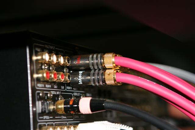

    The Interconnects from 1068 to 1075. When connecting to Processor 1068 (Pre-Outs), the connections on the cables get awfully close! So close that I can’t tell it they are touching! They sure don't feel like they are insulated!
    Hooked this up and reluctantly turn the power on. No problems.
    Anyone else had this problem? The interconnects are Interdyn’s (International Dynamics – Only Australian importer of Rotel). Would they be insulated from each other?

    They don't need to be, if you were to take an ohm meter and check the outer contacts of the inputs you would find they are all common, the inner conductor is a whole different story.
    • Kevin P
      • 10812
      Like Soundhound said, the outer conductor is the signal ground, and is tied together on all the outputs and inputs, so the barrels touching is harmless.
