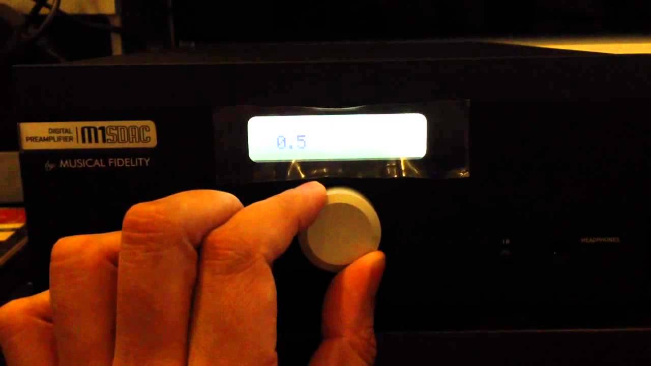

        The front fascia includes a standby button with a blue (on) / amber (standby) LED soft button, a small and cutish dual function rotary knob. IR for remote and a 1/4" headphone jack. The rotary knob serves 2 functions:
        1. Control the volume in 0.5 db steps
        2. Press the knob and it goes to input selection
        Refer to the video below.
        The overall built, I would say acceptable for its price range. Knob feels sturdy and all digital and analogue inputs (RCA) and also the headphone jack provides tight fit to my interconnects or cable.

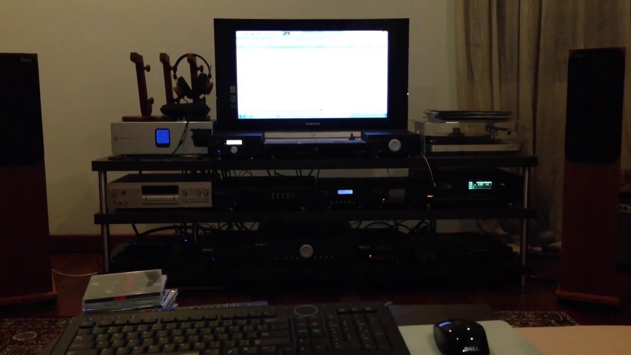

        1. Sony BDP 765 as transport with QED Coaxial Interconnect
        2. Sony MDJA20ES connected with QED optical cable
        3. ASUS Windows 7 laptop, using WMP and iTunes connected with Noops USB A-B cable
        4. iPhone 5 and Blackberry Z10
        5. The M1 SDAC connected to M1 PWR power amp with QED Signature interconnect
        6. ProAc D18 speakers single run from M1 PWR amp with QED Silver XT Anniversary speaker cable
        7. Headphones: Alessandro Grado MS Pro, BOSE Over the Ear

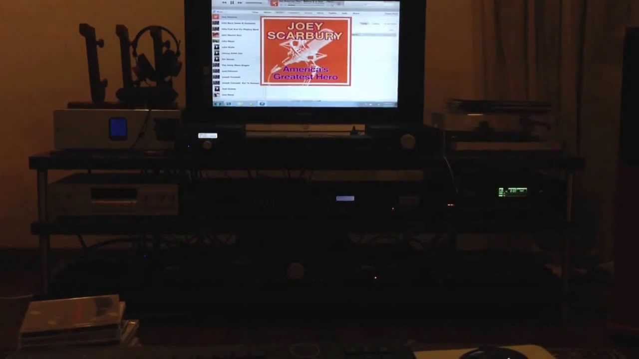

        Dont laugh.... but in the recent weeks, this old classic 80's song by Joey Scrbury have been playing on my mind, So browsed through iTunes and sure enough I found the song for $0.69. Tested the The Greatest American Hero and it made re-live my childhood nights for a moment. I remember watching this TV series with my late dad when I was growing up. The combination of this track and the M1 SDAC gaae me this emotion and thats what matters when listening to music. OK, the track of course is not the best of recordings. The drums sounded flat as most 80s songs are. Snar werough ad kick pedal we soft. But hey, this is not heavy metal. The vocals are transparent and most importatnly, it didd not soun digital an still have that 80's ambience. And this kind of musical engagement is what it is all about for me. Emtion runs high on this one.
