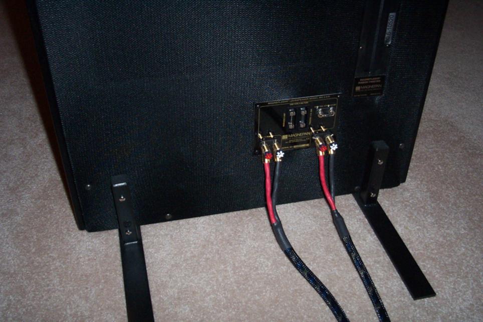

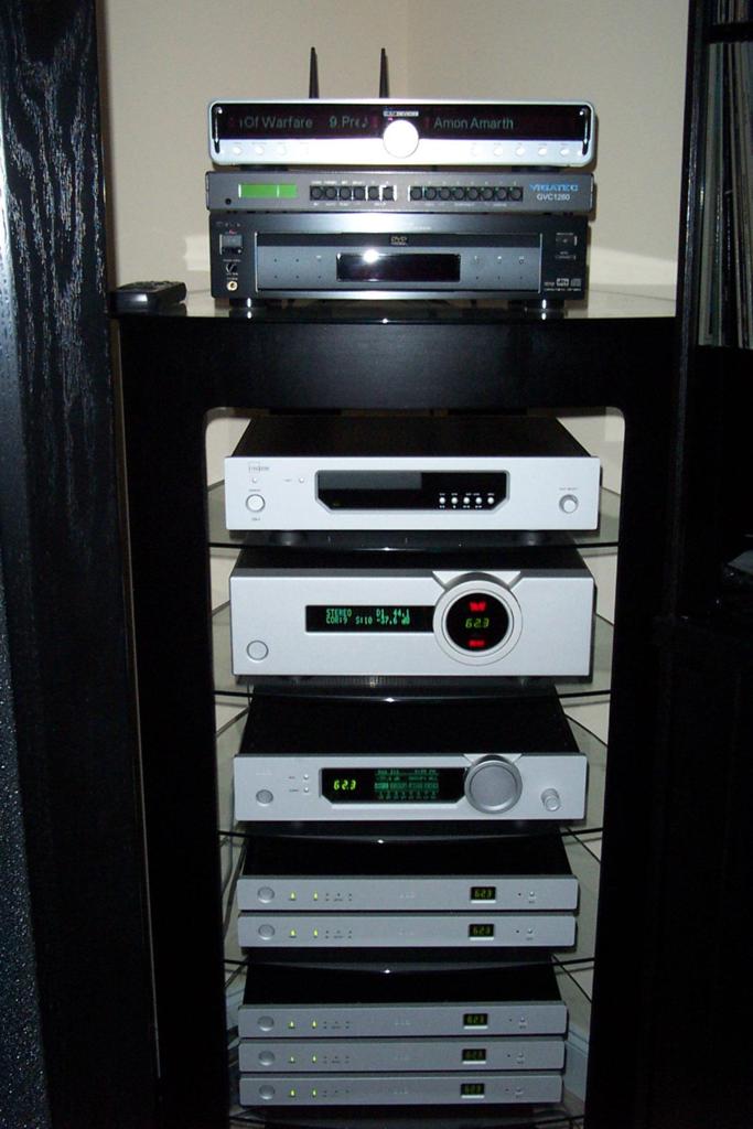

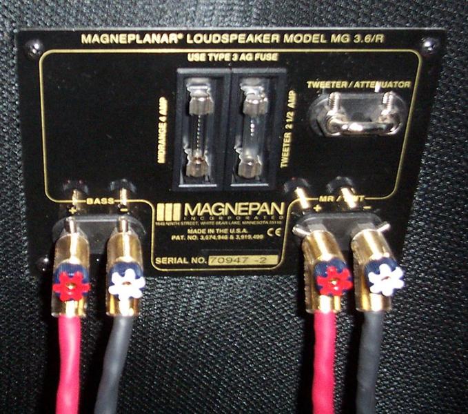

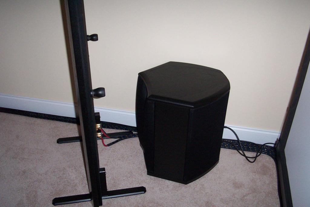

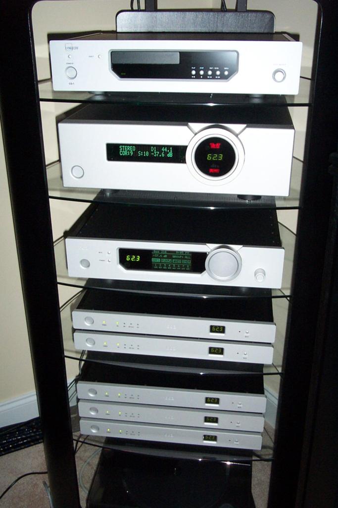

                        Attached are a few recent pictures. If you check out the pictures in the old thread above, you can see the passive XOs on the 20.1s and 3.6s that are removed in the new pictures since I'm now doing active bi-amping on all speakers.
                        Pic #1: Lyngdorf CD1, Tact TCS room correction preamp, Boz 216 amp controller, Boz 2200 digital amplifiers (x5)
                        Pic #2: Slim Devices Transporter, Vigatec GVC1280 scaler, Sony DVP-S7700 DVD, etc...
                        Pic #3/4: Magnepan MG3.6 (no passive XO box, yay!!! :T )
                        Pic #5: Magnepan MG20.1 and Martin Logan Descent
