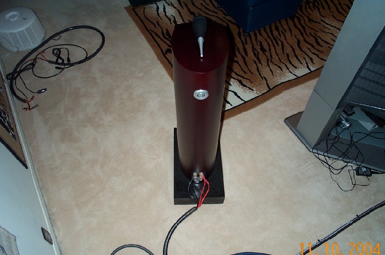

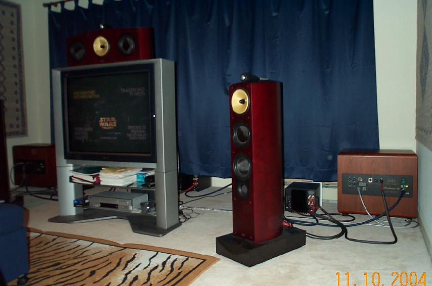

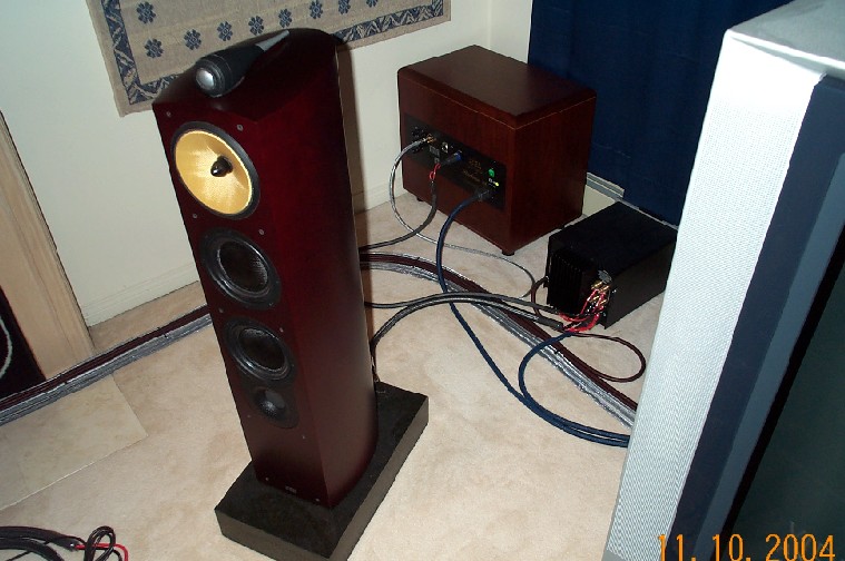

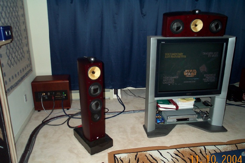

                Unfortunately, part of the reason I gave up is because the place I ordered them from drilled the holes about 10mm off!!! The initial design was to bolt the speaker directly to the slab, but I found this cumbersome and came up with version 2... which was to make an 2 aluminum plates in the curved shape of the 804, bolt 1 to the bottom of the 804, 1 to the slab, and then have 3 circular aluminum tubes connected between the 2 bases... to make it look like the Signature 800... the aluminum would come in anodized black or titanium silver. I would then have 3 spikes (1 at front, 2 at rear) on the bottom of the slab to complete the design. I've already come up with a way to drill and glue threaded aluminum inserts into the slab so that everything becomes a bolt in situation. Once I upgrade to the new slabs, these slabs could still be modified for my new design, but you'd have 4 extra holes on the bottom, which you'd never see anyways when in use. So if that doesn't bother you, maybe I should start working on my design and see how you like them.

                  jlee,

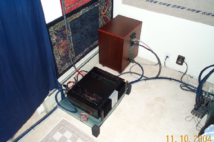

                  Thanks for the pics. That's one serious setup ya got there! Looks nice! :T Is that two B&W subs I see in the corners? 8O
                  Anyways, that is not quite what I had in mind. My main concern is that I am CERTAIN the speakers will fall in the next major earthquake. Assuming we survive :rofl: , I don't want my sweet babies scratched or damaged in any way. 8O Thought it would look cool and functional to get a 1" thick slab of granite cut in the shape of the footprint of the speaker + 3" with holes that align with the ones in the bottom of the speaker. I presume that this would also provide best performance in terms of bass response, but I am too new to this speaker to really know for sure. :roll:

                    Thanks for the compliment. The subs are REL Stadium III's. I've got Strata III's in the rear (see pic). The B&W ASW800 and ASW850 subs are nice, but not nearly as musical and quick as the REL's! I believe the ASW's are $2200 US and $3000 US respectively. For the money, REL is the way to go.
                    Getting that granite slab cut in the shape of the speaker is going to be costly! It was fairly costly to even get the Aluminum cut in that shape.
                    What did you mean by +3" with holes that align with the bottom of the speaker? I understand the 1" thick part... but not sure what you mean by that added 3" with holes.
                    Somebody correct me if I'm wrong, but by bolting the speaker to a 100 lb granite slab, you essentially increase the total mass and therefore the resonant frequency. By keeping the speaker more still by bolting it to the slab and then placing spikes underneath so it can't "rock" on the carpet, you get better imaging and bass definition/taughtness/pitch accuracy. That is what I have found at least... one test you can do is push on the speaker at the back where the tensioner for the FST midrange is... see how easy it is to "rock" back and forth. Ideally, you want it perfectly still and VERY difficult to budge even the tiniest bit. With the slabs and blue dots, I've achieved the same level of "rigidity" as the Sound Anchors... with it completely bolted to the slabs and then coned or spiked, I think I will achieve the final frontier. When I first got the speakers, they were directly on the carpet... and even with spikes, could still easily rock and did not sound nearly as good as with the Sound Anchors or my current granite slabs. The sound anchors at $150 are a good value, but just not to my taste.
