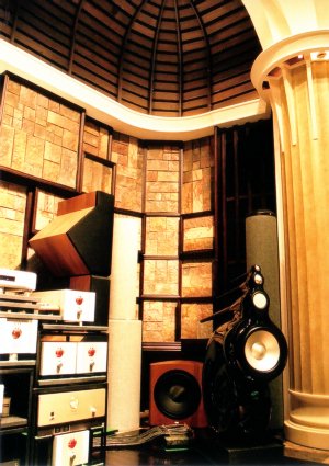

                                    Already got a pair of those in my bedroom :rofl: :B :E But ever since I installed them, haven't been able to find the bed!!!1 :P 8O :roll: :evil: :twisted: :T :E : : :rofl: :rofl:

                                      man... i cant even stop laughing when i look at that pic... i can't believe someone would actually buy them, no matter how good they sound. i guess the purpose of the big horn things is to reproduce actual brass instruments?
                                      • jlee
                                        • 337
                                        Is that a real pic or digitally altered as a joke? To me, that is just too funny. I wonder how the WAF comes into play here...
                                            No joke, they are for real.
