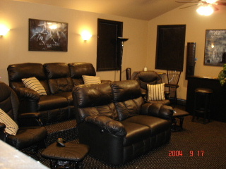

      I have large room 20x25x12. I will be using Sunfire TGIII and amp sig 405x5. I don't listen to multi channel music, mostly watch sat.,movies, and play my xbox. I have already ordered the 803 and htm1 just need to add rears - something cheap. Went to my dealer today and liked 803 much better to myself and wife. Smother and wider soundstage with highs easy on ears. These features are important for me with DVD movie because I like to listen at louder volumes. I was listening on Krell showcase pre and 2205 amp. so hopefully I like at home as much as demo room. Budjet is in the red with purchase however I do still need rears. My sub is SVS Pb2+.

            Now, looking at your room I suggest the SCM1 for the surrounds. I'd locate them reasonably high in the side walls and they will fill in the sound nicely. That will also leave room for some centre rears for later if / when you decide to go 7.1. The reason I am suggesting this is that you dont really have the space for floorstanders like the 603s to breath and, with great speakers like the 803s you may as well go for a tonal match. Your dealer should give you a excellent discount given the 804/HTM1/SCM1 combination!

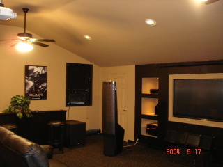

            PS - What were those nice speakers in the picture (Martin Logans)?

              Kevin, your on your way to a great setup! Im jealous of the cubbies you have for your components next to your tv...

                I ment to say the ds6 s3. I think there only 400-600 for pair which will be in my price range - very overspent. I dont want to become single. In that price range I could even go for 2prs which I would think would be good for my room. Oh yea I had Martin Logans but just got rid of them for B&Ws. I couldn't get them to image well in room also regular quality sources sounded really bad. I like the fact that everything I though at B&W speakers sounded good to great were Logans sounded only very good on top quality sources. So I sold Logans which were toward there top of the line.
