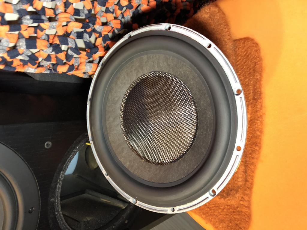

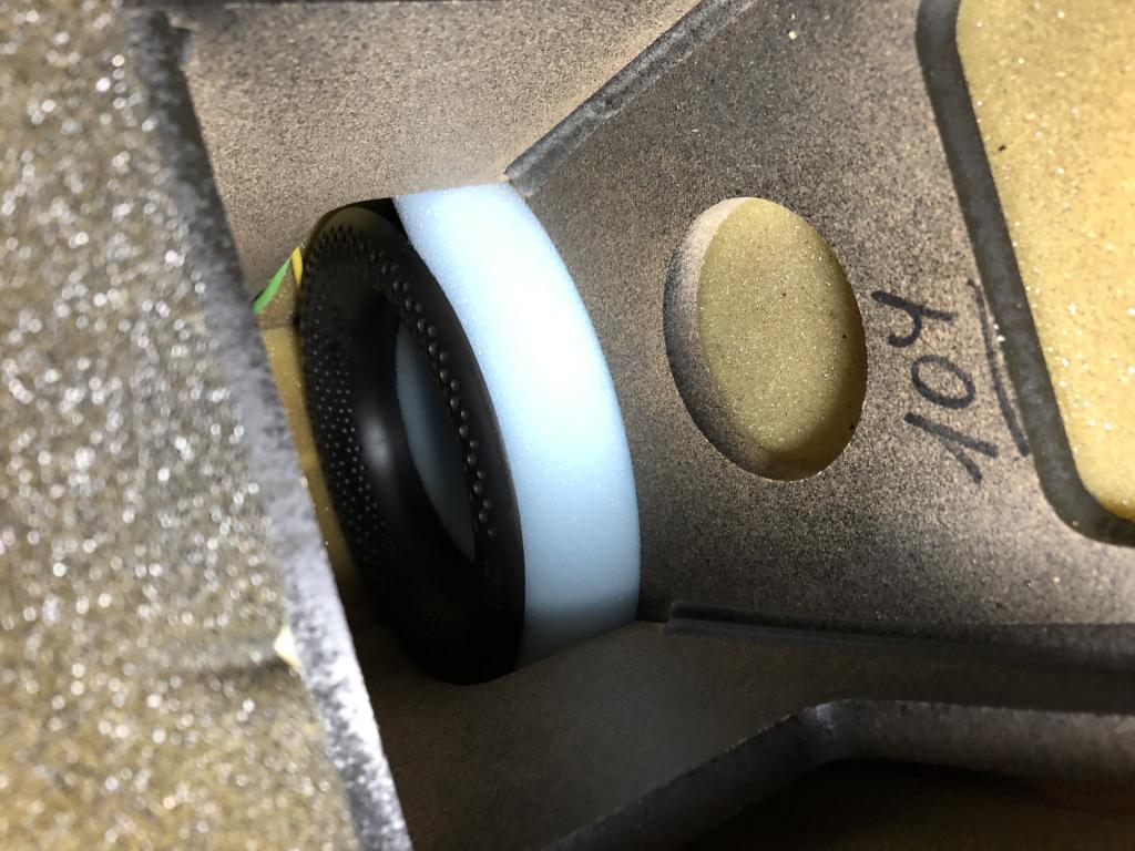

    802 N disintegrated foam liner replaced successfully
    I wish to share my experience. I decided to give it a try and removed the lower woofers of the speakers. It was not as simple as it looked, as they were kind of stuck. Eventually I was able to take them away and access the interior of the cabinets. As I had guessed, the upper end of the port tube was clearly visible and I had not great difficulty in installing a new foam inside them. I had to come up with the right size by trial and error but I finally succeeded in installing both foam liners. I was also able to see that the rest of the damping material inside the speakers was in good condition in spite of the many years of use. I put some extra foam on one of the sides of the port tube where B&W had put very little material. I believe they are now better damped. I am quite proud of the results. I am attaching two pictures in case anyone comes across this very same problem. Greetings from Buenos Aires.
