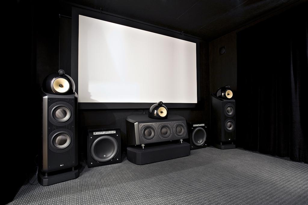

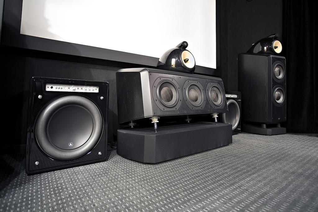

              I have a great HTM1D that I stole from a fellow on this forum. Get a half dozen or so 2x4 sheets of mdf. Put the speaker on on of the sheets and trace around the bottom, then cut out with a jig saw, then take that piece and copy it on to the other sheets and cut out one by one. When you are done with that, glue the sheets together and then wrap with whatever cloth you want. Use less or more sheets if you want, make it however tall you want, if you go past six, it will be very heavy.
              • kallagtunet
                • 37
                Looks like this:

                  Originally posted by kallagtunet
                  Looks like this:
                  Very nice system! :T
                  • mal01
                    • Apr 2009
                    • 42
                    Looks like this:
                    Yep, you're the one :T

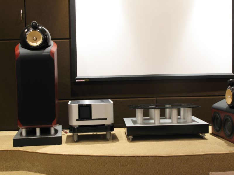

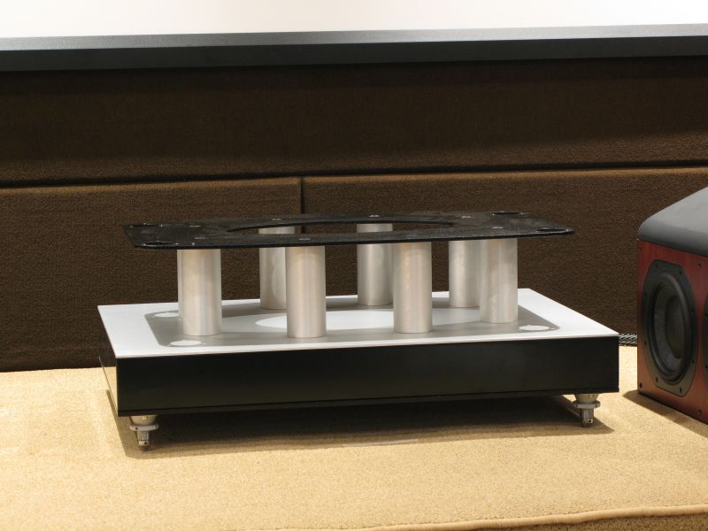

                      Im looking at a custom made stand that will use the base of the 800D's as a reference for finish. Aluminium and wood(satin black finish). The aluminium would be solid and anodised to look like the 800D's base. The problem im having is weight, cost and the number of feet to get a scale relation. The original stand has 8 feet, 4 in the front and 4 in the rear. It looks rather busy, however going with 6 feet instead of 8 may throw the proportions off.
                        • 1098
                        If it all works out it should be perfect. You might also want to factor in a slight upward angle so that your HTM1D is properly directed towards your listening position. Good luck and please keep us posted. :T
                        • windshear
                          • 243
                          I wont be putting a tilt angle on the stand. The reason is with test tones i have run, the tonality of the HTM1D changes in relation to the mains with an angle increase. It sounds closest to the 802D's when parallel with the floor.
                          I cant make up my mind, either i go with aluminium and anodise or steel and powder coat. Ideally the anodised aluminium finish should match the 800 Diamonds that are on their way. However its quite a bit more expensive compared to the steel powder coat finish.
                          I will be placing my CA5300 and CA2300 on plynths between the mains and the center channel and they will be finished in a satin black and aluminium look powder coat.
                          Either i make the center channel stand match the plynths or the 800Diamonds base. Either option is a compromise of some sort.
                          • windshear
                            • 243
                            A test fitting. The pillars are flawed from the anodising process, so needs to be sorted.
