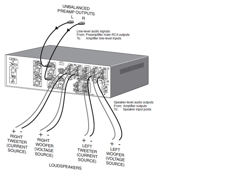

                                Would someone like to explain the electrical difference between the two diagrams?
                                As I've said before, if you hear a difference Bi-Wiring, then you should have used larger cable in the first place.
                                Bi-Amping, we can talk a little longer about, but Bi-Wiring is nothing more than a cable marketing initiative.
                                I know some are using this picture to talk about bi-wiring. I happen to have a potential different picture which I really don't know if it changes the conversation.
                                My amp is a sunfire TGA-5200, it is a 5 channel 200w per channel amp.
                                I am including a page from the manual that explains how to set up this particular amp if you wanted to use bi-wiring.
                                under this setup you will use two physical runs per post for your speakers. for the purposes of the discussion how, does this amp provide a capability that other amps don't? or if I would to see the "real" schematic would be be just like mjb presented?
                                  Hi Olilugo,
                                  Your amp is just jumpered on the inside which makes biwiring easier then connecting two leads to one set of posts. It is still the same electrically.
                                  Cheers!

                                  • olilugo
                                    • Aug 2009
                                    • 20
                                    And I though I had something especial. :-).
                                    If you see the picture in detail, there are two kinds of connections for left and right channels; the choices are current and voltage. the rest of the channels uses voltage according to the manual.
                                    there is another note on the manual that says:
                                    NOTE: The Current Source output is a Voltage Source modified to yield
                                    an impedance of one ohm. This corresponds ap prox i mately to a vacuum
                                    tube amplifi er's output im ped ance and constitutes the dominant factor in the soundstage delivery of classic vacuum tube power amplifiers."
                                    As I read all these It made me belive that in fact bi-wiring was different on this particular amp.
                                    I happend to use all sources and I didn't like the sound. I ended up connecting using one single ended wire at the amp and bi-wire at the speaker end and suing the voltage side of the source.
                                    • stuofsci02
                                      • 1241
                                      Sorry olilugo,
                                      I didn't see that description on photo you showed. What you have is Bob Carvers "Down Tracking" technology. On this amp you can use your amp with a very low output impedance (voltage source), or a higher output impedance which is more similar to a tube amp (current source). You can also use both.
                                      Although you would do this in a bi-wire configuration, this is not really true bi-wiring. It is actually closer to bi-amp since you use a difference amp configuration for the HF then for the LF. Sounds interesting...
