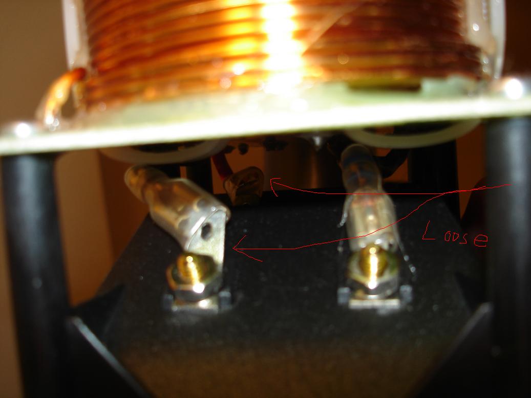

    Well today I wanted to impress my wife by showing her how amazing the CM1's sound when running as mains. I hooked them up and noticed something didn't sound right.. almost like a tweeter wasn't working. After some troubleshooting I realized the left tweeter wasn't working. I took the speakers apart and swapped tweeters with the other good working speaker and it still didn't work. hmmmm.. so I busted open the ohm meter and started doing continuity tests from the rear jumpers to the tweeter wiring and was getting nothing. So I popped out the crossover and this is what I found (see picture). Both the positive terminal wiring for the low and high was falling off the connectors. The tweeter wire was completely off while the bass driver was just barely touching. Talk about a quality control issue on a set of 1k speakers. Unbelievable! I think this will be my final set of new B&W speakers that are made in China. I even had trouble with my CM9's(both mid bass drivers quit working), 683's (dead bass driver) and now this with the CM1's. I gotta be honest I have had cars that were more reliable..

    That sucks... But it is a connector and not a solder joint.. Is it possible it has been wiggling off during shipping?

        Yeah, that does suck.
        But even if you shake the speaker for an hour straight, unless the connector is the wrong size, it's not really going to get lose.
        Honestly, this is something you should contact B&W directly about. Telling your dealer isn't going to make a difference unless he takes initiative. Made in China does not automatically mean it's crap. It's very intensive the amount of planning and instructions involved for having things made in China. If you don't let B&W know that this was not done correctly, they may never know and not be able to make corrections.

            No doubt I'm bummed. I'm not saying all things coming out of China are bad. I'm just saying something obviously isn't working at the B&W factory over there! It's a shame that company who use to pride itself in quality and longevity is putting out products like this.
            I totally agree no matter how much you shake that speaker that connector shouldn't come loose like that. I probably got a Friday or a Monday built speaker?
