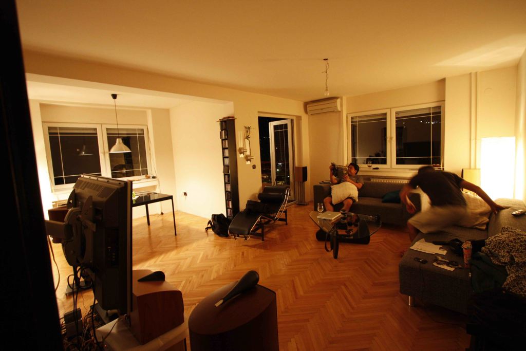

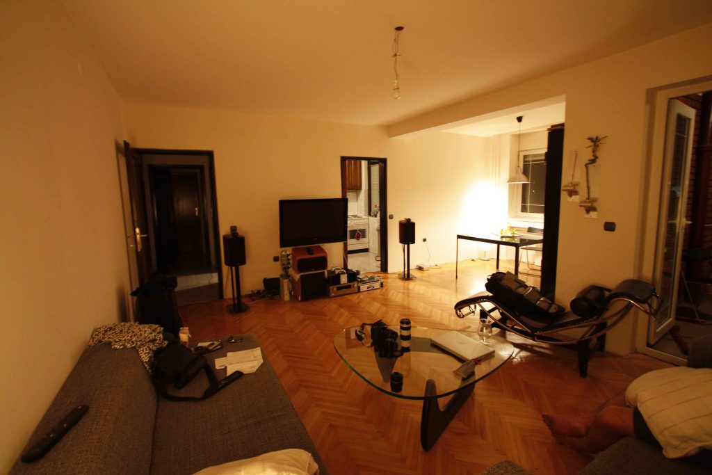

        Boominess is as much a function of speaker position and listener position as anything else. Yes, small rooms can be more problematic than big rooms because they will be more, and closer spaced, room modes. I don't think the speaker it self makes that much difference - if the speaker makes bass, and you put them and you in a place that resonates then you will get boominess. It looks like you sit close to the rear wall - that can be a problem. It also looks like you have your speakers fairly close to a wall, again a potential problem. I think I remember seeing this room someplace else, but do not remember the context. Have you tried sitting on the coffee table? Your room might sound better if your primary listening position was about where it is.
        Is that a sub underneath your center channel? It looks like you have 805 now. What are you hoping to gain by going to 803?

                                      It's too bad that next to the speakers position are doors (one to the exit, another one to the kitchen). So it's pretty frequent part of the room, and i cant move them more away from the wall.. Also i can't put the couch more front (maybe half meter). So i'll try the best in my room, so i can definitly know.. BTW what are broadband absorbers?
