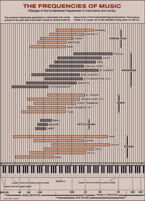

              Dont think that information below 22hz isn't important, it is, many recordings have information well below this. Have you ever felt a large Kettle drum in a live Symphonic concert? Well below 22hz.
              Robert P. 8)
              AKA "Soundgravy"
                Robert, that's a pretty impressive kettle drum according to the attached chart!

                  Nice chart Nigel.
                      Well according to your chart I guess it was :lol: ,the piece that made me think of it was a performance of the Superman Fanfare that I heard years ago, a recording of the performance was made and it was found that the ending crescendo was measured down to 16hz.
