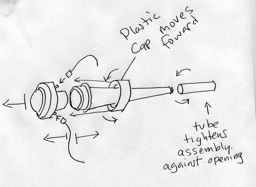

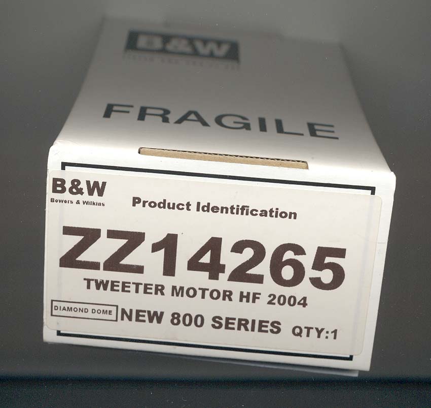

                                              Here's the box with the part number and a quick diagram how it comes apart. Basically you unscreww the rear tube that sticks out which frees the whole assembly.
                                              But Its snug in place and needs a little push from the rear. then it exposes the 2 wires which you unhook. Then it comes out voila.
                                              The Tweeter motor is held in place by a plastic collar which unscrews and slides off and the assembly breaks in to 3 parts. Takes about 2 minutes.

                                                    The dealer showed me the replacement tweeter assembly-- nice rendition misterdoggy-- which is the threaded portion receiving the wires on the left.
                                                    Knowing what a simple operation it is to replace, makes me know that if it breaks sometime down the road, I can have it fixed with relative ease; but on a brand new factory sealed pair of speakers? Who knows what actually happened in-transit for the tweeter to have broken? Who is to say the speaker has not sustained any other internal damage?
