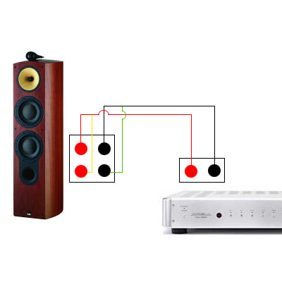

    I had a rather simple question about hooked up speakers to an amplifier.
    There are 4 wires on the cable that I got (bundle made of a red, black, white and green wires) and I was told to twist the red & white and connect it to the amp and then connect the red to a RED speaker connector and the white to the other RED speaker connector.
    And do the same for the black and green cables as shown in the diagram.
    Hence I am not using the JUMPER CABLES.
    However, a friend of mine said to not go this route, instead twist the red and white wires and treat them as one - i.e. attach them to the RED connector on both the speaker and the amp. and do the same for the black and green wires.
    And then use the jumper cable between the 2 red connectors on the speaker and 2 black connectors. According to him, this gives a better bass response.
    I'm confused! What is the better option of connecting my speakers to the amp?
    Thanks!

    HI audio,
    The first advice is correct as shown in your diagram. This will implement a classic bi-wire hook up. Many, including me, think this is a better way to connect speakers.

      Originally posted by Karma
      HI audio,
      Sparky
      :agree:
      FWIW: You could experiment with both and judge for yourself. The merits of bi-wiring are always fuel for a debate.
