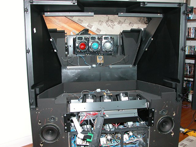

    Front Screen Off, Had I known this was coming off, i would have had some black velvet to line the insides :wink:

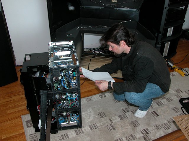

    Tim from Hitech looking for the solder points on the chassis

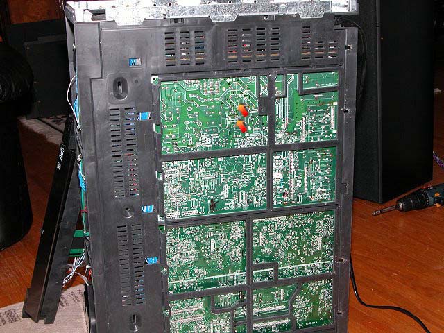

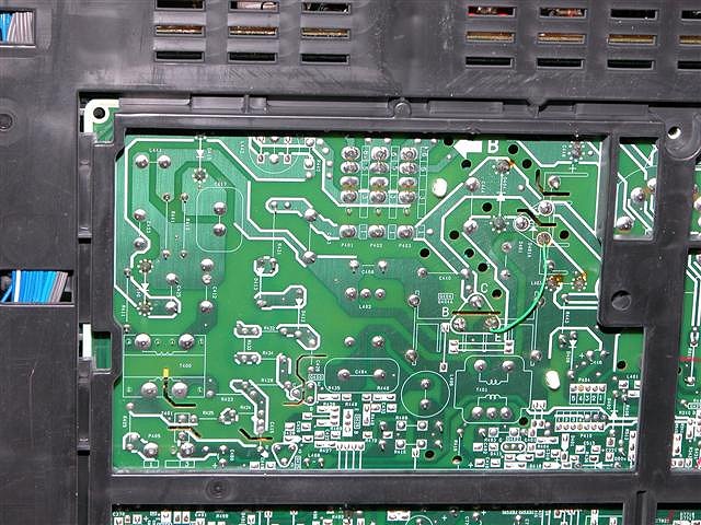

    Arrows show the solder points
    Jumper wire is soldered in place.
    Thats it, the white line problem is gone, and I don't see any negative effects from the mod.
