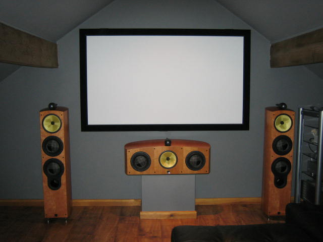

              david why would u want to hide such a beautifull speaker have a look at my htm3s
