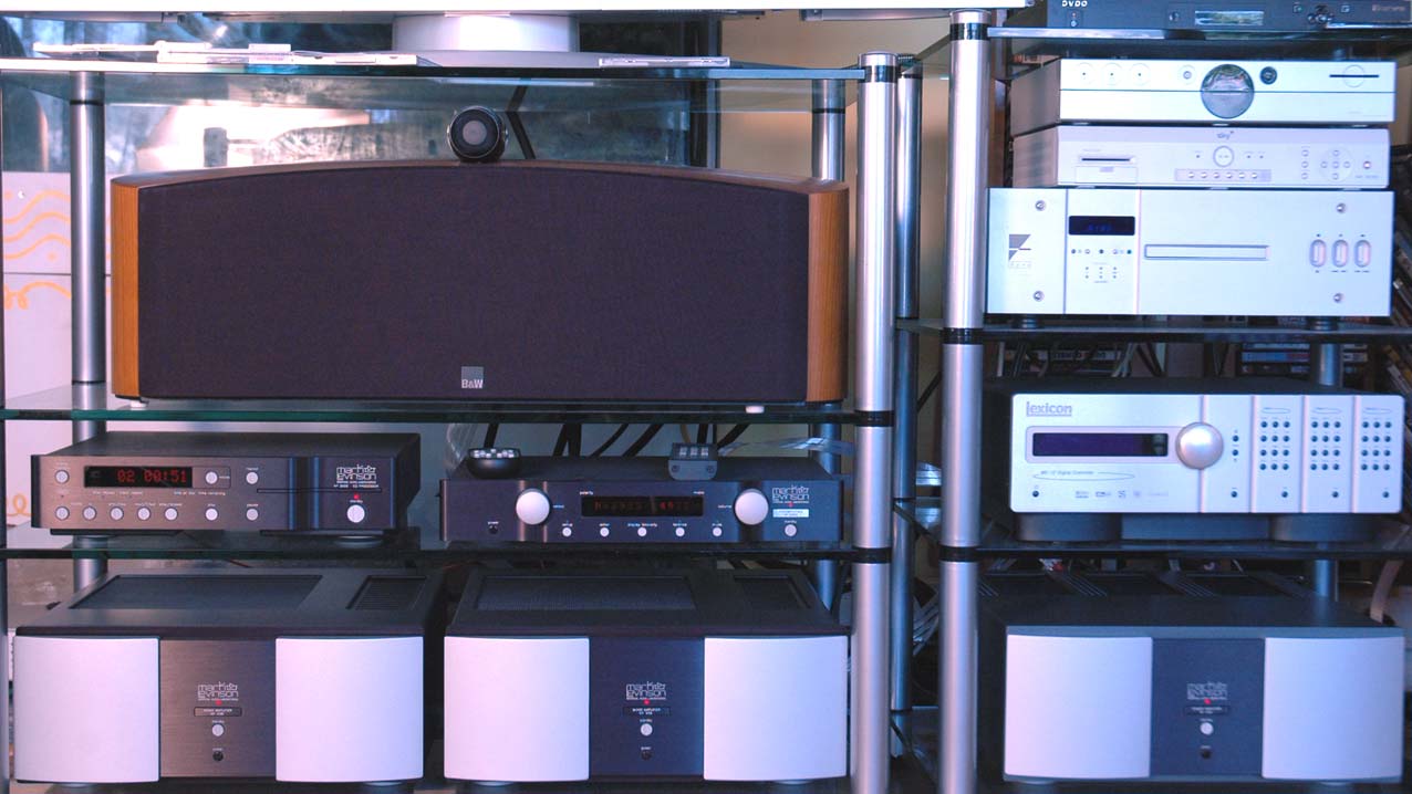

                          This is my solution. Its on a shelf, but open all around.
                          • RobP
                            • 4747
                            Hows the center stage height with the glass over the tweeter Misterdoggy?
                            Robert P. 8)
                            AKA "Soundgravy"
                            • misterdoggy
                              • 1418
                              I had the plasma higher before and the tweeter at the same height at the L+R, but was sacrificing viewing height.
                              Now I think it is important to have the relationship of the screen and the center channel as close together as possible to keep the "soundstage" tight.
                              Because the center channel is lower than head height I have it forward slightly out and clear of the glass and tilted or angled upward directed to head height (notice the white rubber feet on the front of the speaker and not at the back)
                              This carries the sound clear and centered to the viewer. And also as recommended the height of the Plasma should be no higher than head height at the bottom of the viewing screen. Ideally in the middle, but with all the equipment I have this works nicely, as the room is big and it needs to be a little higher for everyone to see.

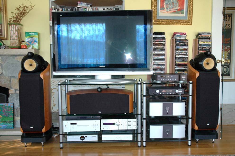

                                                        thats the old picture heres the current system
                                                        • Aldo
                                                          • 448
                                                          Mrdoggy: are you using the internal DAC of the 390? What do you think of it?
                                                          • misterdoggy
                                                            • 1418
                                                            Yeah, I think its great............

                                                                Misterdoggy, how do you get good imaging in classic stereo with that reflective surface - your plazma - exactly between the fronts? And the spkrs are placed BEHIND the screen!?!?!? Did you try it without the plazma in between? then you can toe the spkrs in a bit...or do you usually cover the screen with some kind of acoustic foam when listening to stereo? I think I have reasons to ask :W
                                                                • Aldo
                                                                  • 448
                                                                  That was an extended topic explained before several times!
                                                                  As with many of us The Boss (his wife) has the last word on speaker placement!
                                                                  He takes audio messures and gets the best he can from the setup!

                                                                          • 1418
                                                                          Actually the speakers are pushed together for the foto. They ARE wider apart and toed in and although the foto looks like the screen face and the speakers are the same the Plasma is at the very back of the shelf while the speakers are forward. So the front of the speakers are about 2 feet in front of the screen
                                                                          As for imaging, I got the perfect center image in stereo. If you were here Pavel and I sat you on the couch, you would not be able to tell if the center speaker was on or off in stereo. Its perfecto ........
