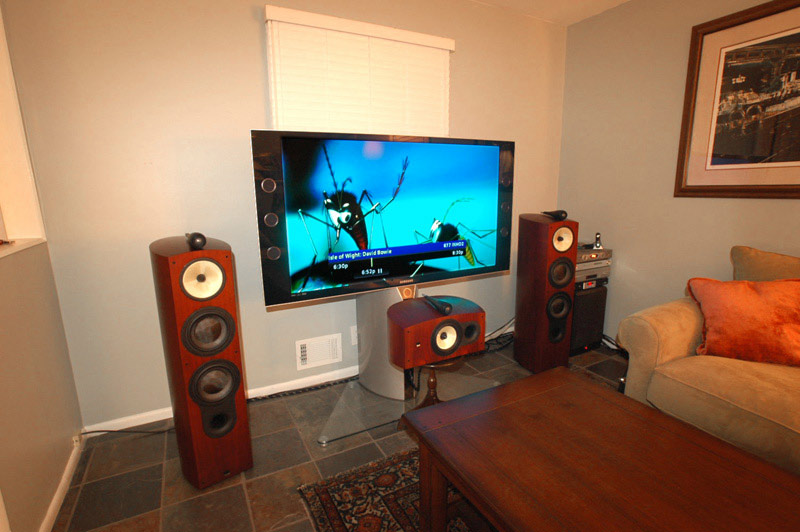

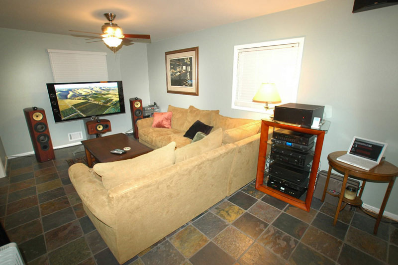

    I'm not going to profess to be an experienced audiophile but just an enthusiast I suppose. So any comments on my sey-up are greatly appreciated. Yes, I realize the positioning of the couch in relation to the speakers might not be ideal but that's what I have to work with. Initial impression is that they are way more detailed than the Klipsch RF3's that these 803's have replaced. I've also noticed that any minor issues in a recordings really stand out. A lot of my live shows may be unlistenable at this point. The center channel is very full sounding but not quite as detailed as the boston center i had. Maybe my ears aren't sophisticated enough at this point. Soundstage is definitely wider. Way more seperation between instruments. My only gripe is that they sound a wee bit harsh at times. This is either because they've yet to truly break-in or it's the match-up with the B&K amp and pre. Ive heard from others that the 7250 can be a bit harsh but I've never noticed it till now. Are there any other B&K/B&W owners out there? Hopefully the pix will attach
    Set-up:
    Rosenut 803's
    HTM4 Center
    400 Watt Energy Sub
    Klipsch Surrounds (left over from the Rf3's that the 803's are replacing)

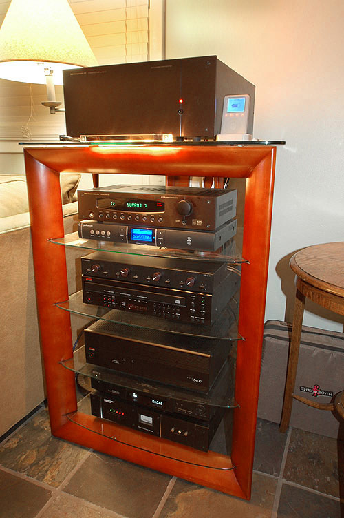

    B&K Ref 30 Pre
    B&K Ref 7250 Amp - 200x5 channels
    Adcom GFA5400 2x125watt amp (powers boston RM50's in the kitchen and JM Lab's Magane Carat in living room)
    Adcom GCD700 Disc Changer
    Polk Audio XM receiver
    Monster HTS3500 conditioner
    Tibutaries Silver bi-wire speaker cables
    Samsung 56" Pedestal DLP
    Russound multi room volume controller
    not pictured - Tascam DA-20mkII DAT

    Hello Bill and welcome to the forum! :later: That is a really nice setup you have :T , some folks think that the B&W's tend to sound a little bright or harsh, this should diminish somewhat over time when they break in a little. Another thing that would really help in that area is maybe some type of treatment for your walls, your room with all of its hard surfaces can reflect a lot of sound which can lead to a harsh sound. There are many companies who specialize in panels that look good as they work. Or if you are handy you could make them yourself. Sometimes proper room treatment can yield you more results than an equipment change.

        Thanks for the replies guys.
        i've thought about some treatments.
        i guess i figured the couch would act as a deadener of sorts.
        and yes, the speaker cable length was an issue. because of the way my room is set up, and because of the size of the tv, this seemed to be the only way to set it all up. So rather than spending the money on matching B&W surrounds or an upgrade in my dvd player, i opted for some decent cables. tributaries made these custom (35 ft) and didn't charge me extra for the added length. They were the same price as the 4 meter ones in the store.

            I had the same front combination like you until middle of this week. I replaced the htm4s there with a htm3s and it made a big difference. The sound of the htm4s is nice and I liked it, but after installing the htm3s, I now think it matches the 803s perfect. It filled a hole. Maybe it would give you that clearness you're searching for.
            I got told by the dealer, that the htm4s are supposed as a center if you use 805s as front speakers. If you use 804s/803s the htm3s is the center to go for.

                        They take awhile to break in.
                        Your room looks very hard. A bigger rug might help.
                        If it does you might look to adding wall treatments
                        at the first reflection points.
                        The FST midrange driver makes for intersting discussion
                        , In some ways it is vey good, in other ways not so good.

                          Your room needs more than minor tweeks. A major rethink is needed if you want to get the best from your very good system. You really need to add soft surfaces. Pay special attention to the early reflections paths. Rugs, drapes, thick wall hangings will all help soften and focus your sound. Then you can concern yourself with bass issues but get the midrange and treble right first.
