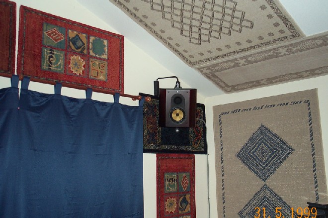

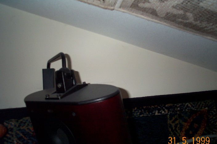

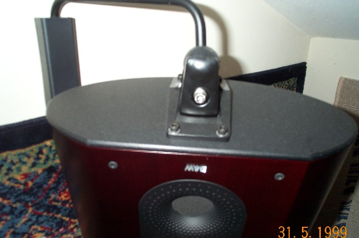

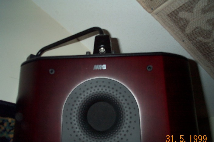

    1. Here are 4 of the pics again.
    2. Ceiling mount facing the listening position would be great.
    3. You MUST secure them to a stud, not drywall only... even if it's mounted to a wall. I used a stud sensor to locate them and then used the swingarm on the mount to locate them along the wall to get the proper distances.
    4. My custom brackets are perfectly aligned with the holes on the speaker. I have a pair for sale actually... email me in private for pricing. Half of it is actually for the 1NT... but I can get the SCM1 half machined and black annodized (you can even choose a different color if you don't like black) within 1 week from a machinist friend of mine... so then it will be a complete bracket for an SCM1.
    5. Ruin the sound? By drilling into the speaker? Yes you would... not to mention any hope of resale! Do not drill into the speaker... use the existing threaded inserts.

            I did do some testing on hanging the SCM1 upside down and concluded it would be safe. I think the test I did was hang them from 1 or 2 threads only about 1-2" off the ground with lots of pillows there to cushion the fall if they did fall... they were good, so since then, I've had them like that for almost 2 years now. Whether they are upside down from the ceiling or upside down from the wall should make no difference from the speaker thread side of things... but I would be scared to mount them to the ceiling unless the stud was VERY secure. The Abbey Road studios have 5 HTM1 upside down from the ceiling. I also tested the threaded inserts on the HTM1 and they are in there very good. Bottom line, I would not hesitate to hang the SCM1 upside down. They weigh only 20 lbs and each thread can easily hold more than that by itself. With 4 of them, it's no problem. The ones I have for sale are the 30.0 WB with custom made adapter bracket so you don't scar the bottom of the speaker. The bracket that comes with the 30WB WILL leave a mark on the bottom of your SCM1's.
