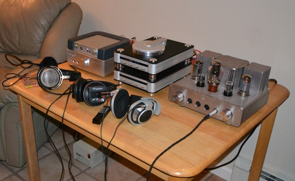

                    I like foobar2000 for playback and its suggested quite a bit on the headfi forum as well. In your budget I think emotiva has a dac that does headphones as well that's supposed to be real nice.
                      After being talked into a $3K setup, I can no longer recommend anything in that price range. :P
                      On a serious note, J. River is an excellent interface. And the cheapest headphones I'd recommend are these: http://www.mrspeakers.com/MrSpeakers...0RP-Headphones They sounded pretty good compared to a few $1,000+ cans I heard the same day. As for budget amp/dac's, the O2 amp and ODAC come recommended, both are available from http://www.jdslabs.com/store.php, but you will have to look on the used market to meet your budget. Don't forget, lower power speaker amps can also be used as headphone amps. They need to have a low noise floor and you'll need to be careful with the volume too.
