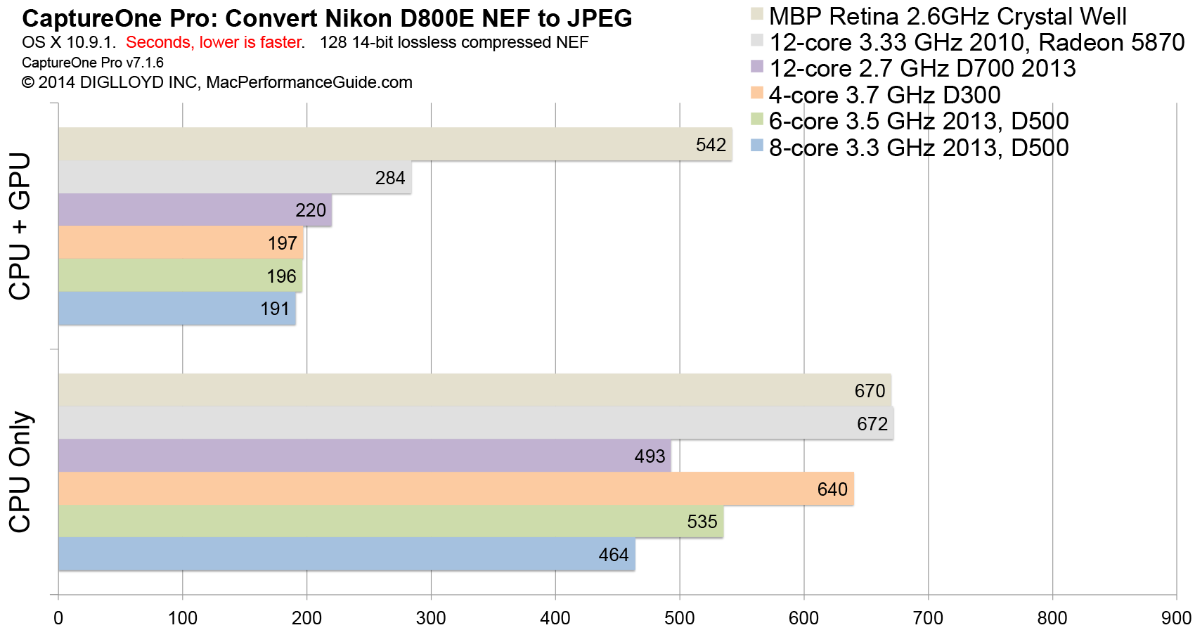

                                Both drivers and software will need to mature some to get the most out of it, but I'm getting great results so far, and my favorite photo site by Lloyd Chambers is already showing some remarkable benchmarks with very early updates to software.

                                Mind you, the oder 2010 Mac Pro with the Radeon GPU (like my old one) also provides GPU support for the right software- but note the degree to which the 6 core 3.5GHz new Mac Pro (the configuration I bought) smokes the 12 core 2010 model.
                                I do have HiDpi up and working via Quick Res on my Mac Pro, running on the 4K 24" Dell display. For giggles, I should do a full screen capture and post- of course, you'd have to be panning like mad to view it, just like the case for a retina iPad capture. Only more so. So, the "apparent" resolution for a 24" 16X9 is 1080P, but there's oodles more visual detail in images with software that supports retina displays, and of course it's great not having visible pixels finally on a desktop. the only downside is how displays handle the resolution and refresh over Display port- the MacPro with the current driver configuration will only support the Dell at 30 Hz, apparently the Dell doesn't have MST implemented in a way that is compatible, unlike the Sharp and Asus 31.5" displays. But at $1399, it has the right combination of clarity and resolution for most of the work I need to do- I'm seriously considering getting a second so I have dual displays- but the practical thing to do might be to hold off six months and see how things develop. HOPEFULLY there is a wide gamut 4K display from Apple in our future... (needed for photography- my NEC 30" display and this new Dell and an older 24" Dell 1920X1200 monitor all support 100% Adobe 1998 RGB color gamut.)
                                  Click image for larger version  Name:	graph-shootout-CaptureOnePro-CPU-vs-GPU.png Views:	0 Size:	41.3 KB ID:	958153
                                  What is up with that? Is there more internal memory in the 6 core? Was the software not able to optimize for 12 cores? What?
                                    • 16168
                                    A few things to keep in mind...
                                    • Other than video encoding/re-encoding, most software tasks are difficult to distribute among many cores, due to data and logical dependencies, and apps like Adobe Photoshop are pretty typical, showing best relative perfomrance at the 4-6 core level; above that, things just tend to bog down and actual core utilization is not that good
                                    • This is a specific type of work load- RAW file conversion- which can take good advantage of Open CL co-processing- and is highlighting new software starting to take advantage of this capability. Adobe Lightroom can use GPU's also; most package currently can't. That will change with time.
                                    • For a given processor configuration, few cores allows higher clock rates per core due to fundamental thermal and power issues- cores running at 2GHz don't do as much work as those running at 2.8 or 3.2 GHz nominal in multi-core mode.
                                    • Memory bandwidth- the newer processors from Intel have upped the memory bandwidth by about 25% compared to those older 12 cores systems- so six cores can really run fairly close to top speed.
                                    • The GPU system in the new Mac Pro is quite high performance AND a relative bargain- for software that is coming to support Open CL and use it for calculations, this gives the new Mac Pro a bigger boost in performance, even though the older 12 core sytem had the fastest aftermarket card available at that time.
                                    • Peak clock rates (turbo mode, thermals permitting) are highest on the new 4 core and six core models (identical, in fact). This gives some advantage, too, though not so much for multi-core operation- it's more of a factor when running workloads that aren't optimized for multi-core operation. Lots of those out there still... like Office, and some older CAD programs.
