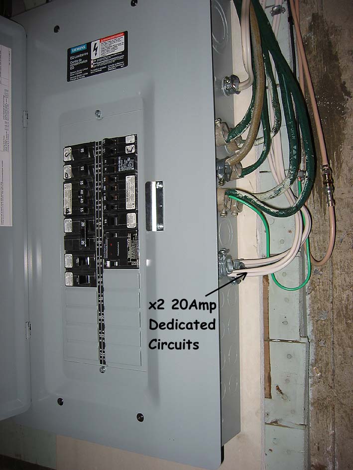

                                        Here's a few pics I have around. When I first moved into my latest home the first thing I did was get rid of the 50 year old fuse panel and install a Siemans loadcenter. You can see my two dedicated cables in white.

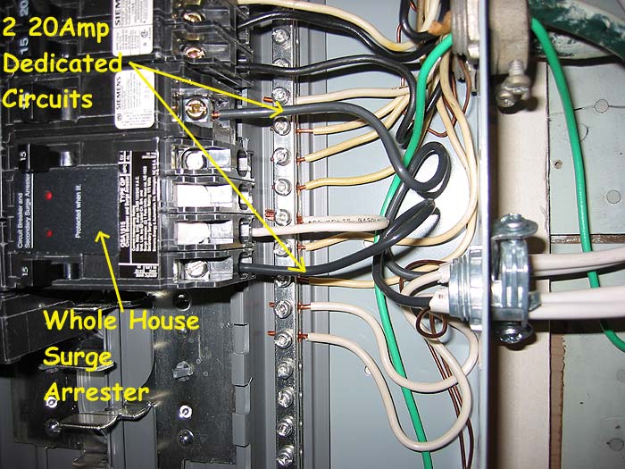

                                        For my HT system I installed a Siemans whole house surge arrester and two 20Amp capable dedicated circuits. You can see the new circuits. One is hooked to the surge arrester, the other to a breaker on the same leg to reduce the possibility of ground loops.
                                        One of the advantages of the 'breaker' type of whole house surge arresters as opposed to the 'standalone' whole house systems is that you can wire your HT system's dedicated circuit to the breaker of the arrester itself and if protection is compromised by a lightening strike, the breaker will trip and your system will remain protected until you do something about it.

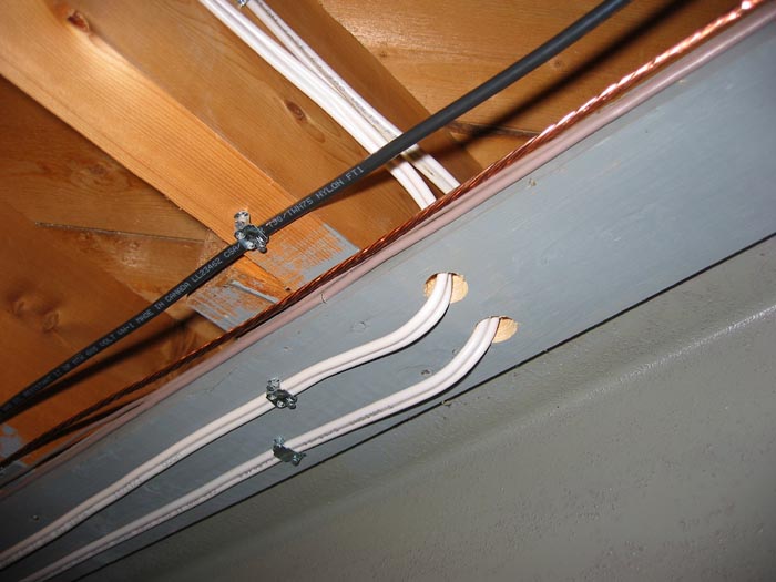

                                        It's also nice, if you're able, when you install 2 dedicated circuits that their lengths be somewhat similar and that they are run side by side. One of the reasons for ground loops is that the safety grounds of your AC circuits possess a slightly different potential. The safety ground can, and usually does, develop a small potential, through mutual inductance, wire resistance (created from a long run) and various other reasons that can be different between the two dedicated circuits. The best solution for this is to run the two circuits together so they are identical lengths and paths traveled. This helps to ensure the potential of the safety grounds are at the same potential. Of course, you've already ensured they are on the same circuit leg at the service panel.
                                        Here's a pic of my two circuits running the same path.

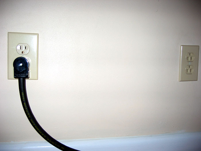

                                        Here's a pic of one dedicated circuit with a 90degree Levitron plug and its heavy 10 gauge cable feeding half my system. Note the standard house outlet right beside it. Those are good for lamps I guess.

                                                                            Brucek, what is that green wire I see running from inside your panelboard through a connector and landing on a lug on the back wall ?
                                                                            • brucek
                                                                              HTG Expert
                                                                              • 303
                                                                              The green wire is my cable TV ground wire that runs to its grounding block mounted beside the panelboard. I do my own wiring, so I ran it inside instead the service panel instead of screwing it to the panel outside. I don't use cable anymore, but the block and wire are there in case I ever do. I use most of the old cable TV cable to pass RF from one satellite receiver to the other for PIP.
