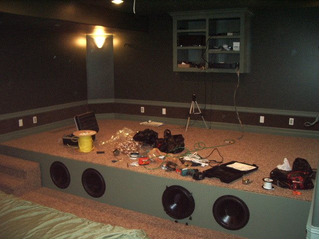

        I would feel really bad building these massive subs under my riser and then not using them. I didn't explain what I had done, sub wise, so I will post a pic. The subs are not movable, so I am relying a lot on EQ. Yes, if I had just build a regular, movable sub, I would do just what you mentioned. Thanks.
        Roly
          • 10933
          Roly certainly doesn't not need another sub. The one he has will lay waste to most on the planet.
